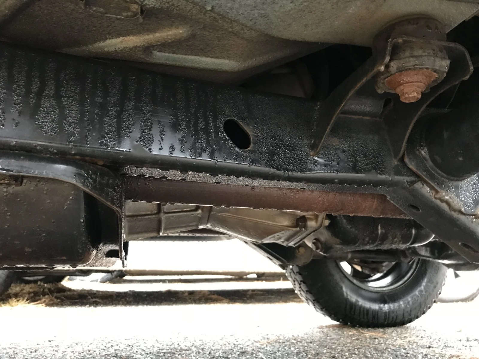

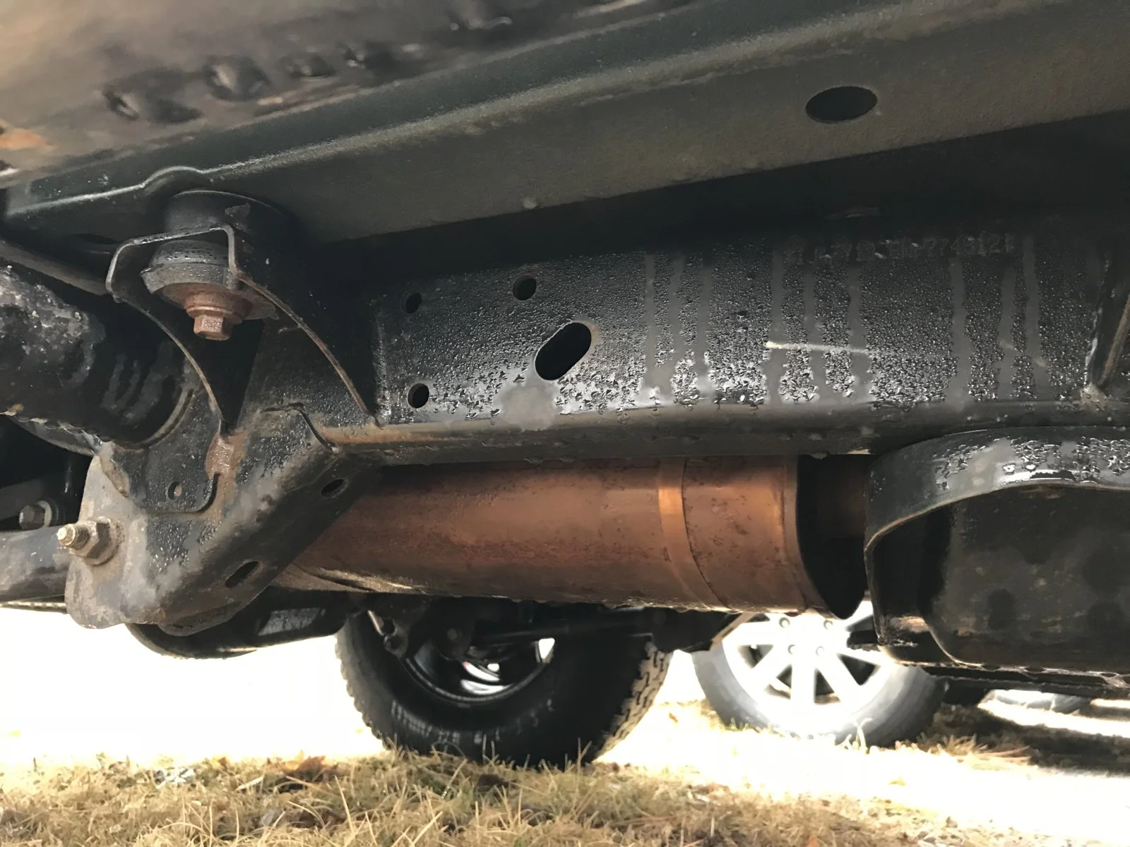

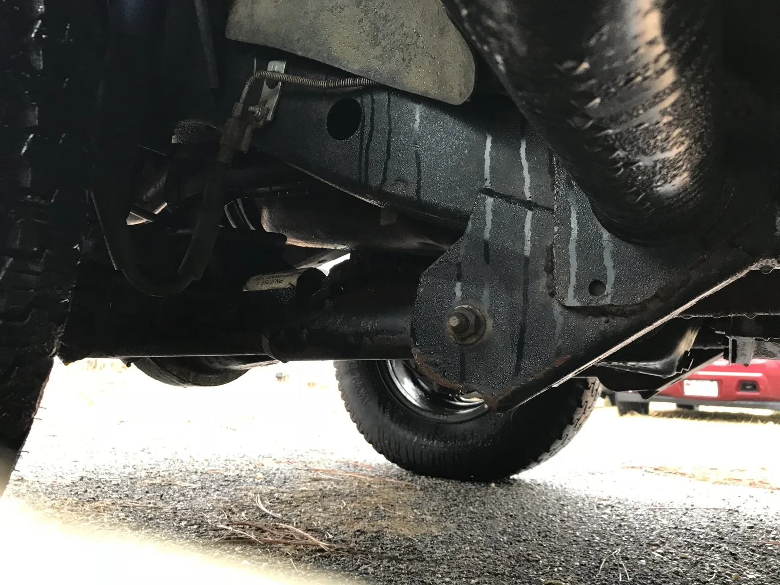

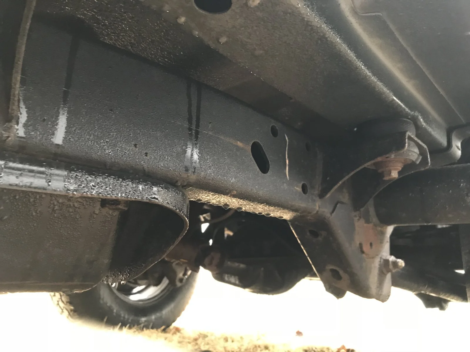

- Apply grease to the 7 front end zerks
- Apply Fluid Film inside of frame and all other major components underneath
