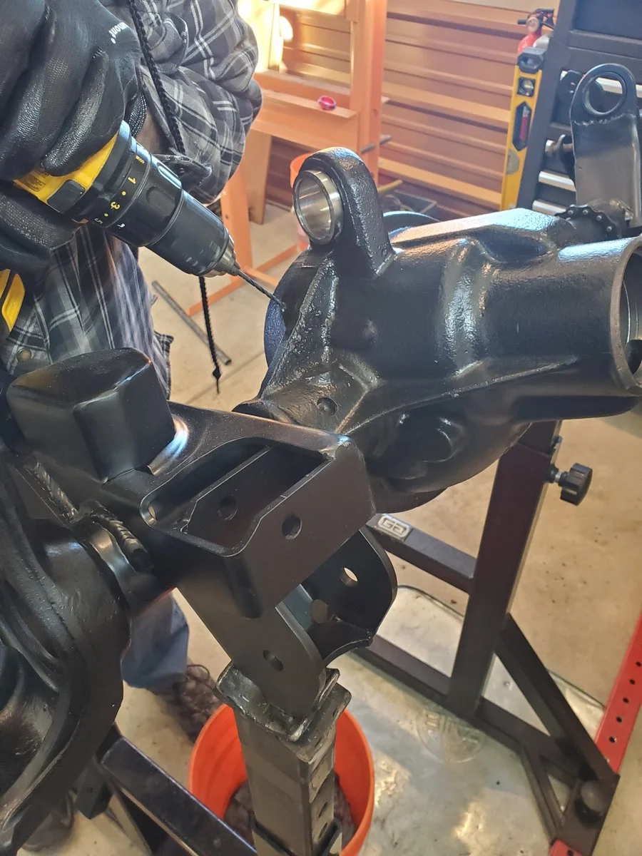

As part of the outboard, you would be/should be changing the lower mount.
Here’s what the outboard tower construct looks like.
I assume you plan to outboard the shock towers and then install these? If not, it's a complete waste of money.
I ran them on my TJ with outboard shock towers and had 12" travel shocks in the rear and 11" travel shocks in the front. I had mine tuned by @pcoplin and absolutely loved the way they road. I never got a chance to take it anywhere big off-road, but on-road they road absolutely amazing.
