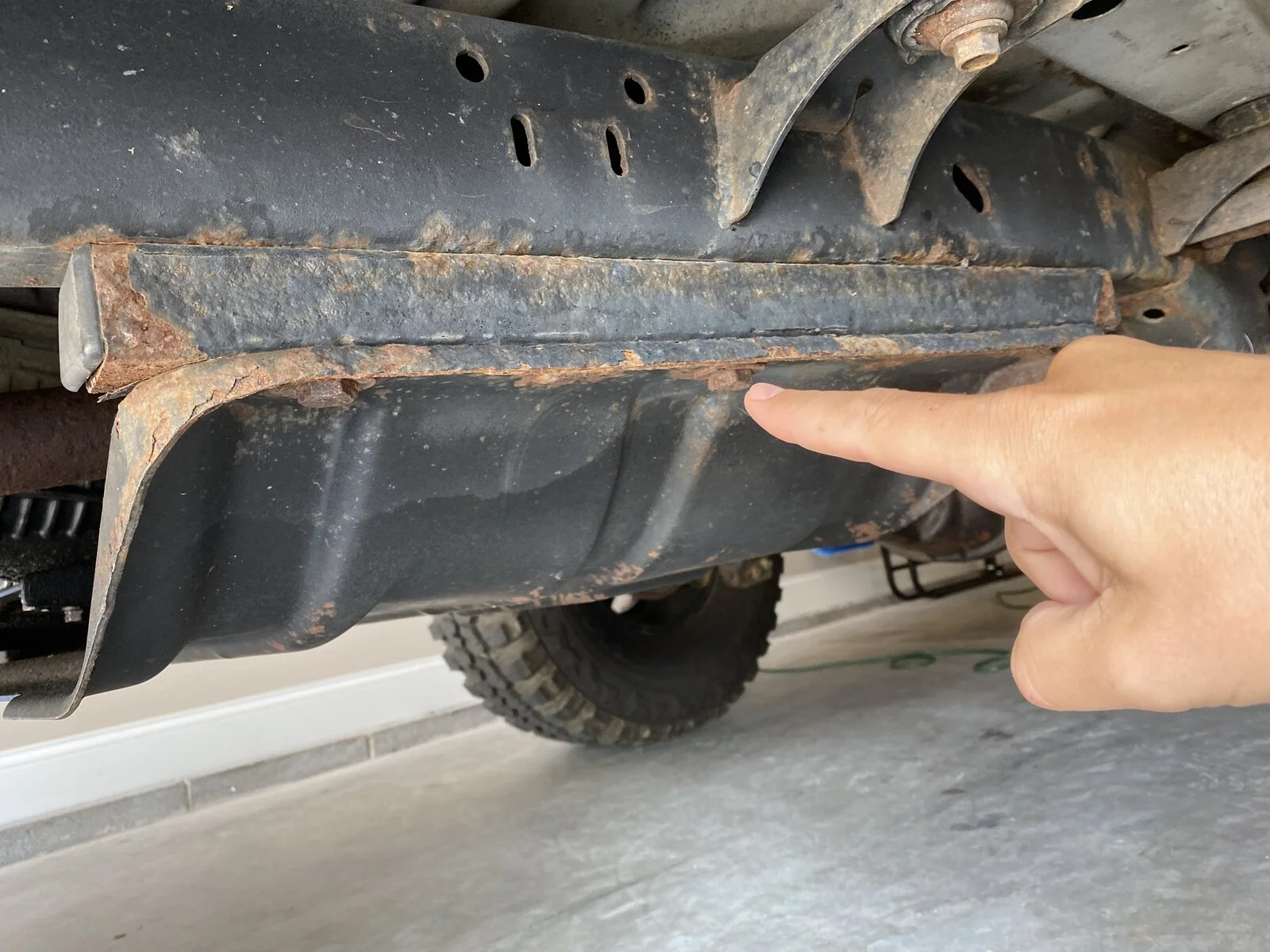

I have some minor to moderate rust on my frame mostly just surface rust and it isn't too bad at all. It bothers me though and I want it to look clean and black and be free of rust. Before this winter I want to have my frame painted and ready for the salty roads ahead. I know POR 15 is the best option for the job but I am quite broke and don't have the money to buy some. I do have 4 cans of black Pro Grade Rustoleum Undercarriage paint. According to the can it stops corrosion and prevents rust. If I were to sand down the rust on the frame and clean it thoroughly would it be okay for me to just use the paint I already have? or would it serve no real benefit. thank you.

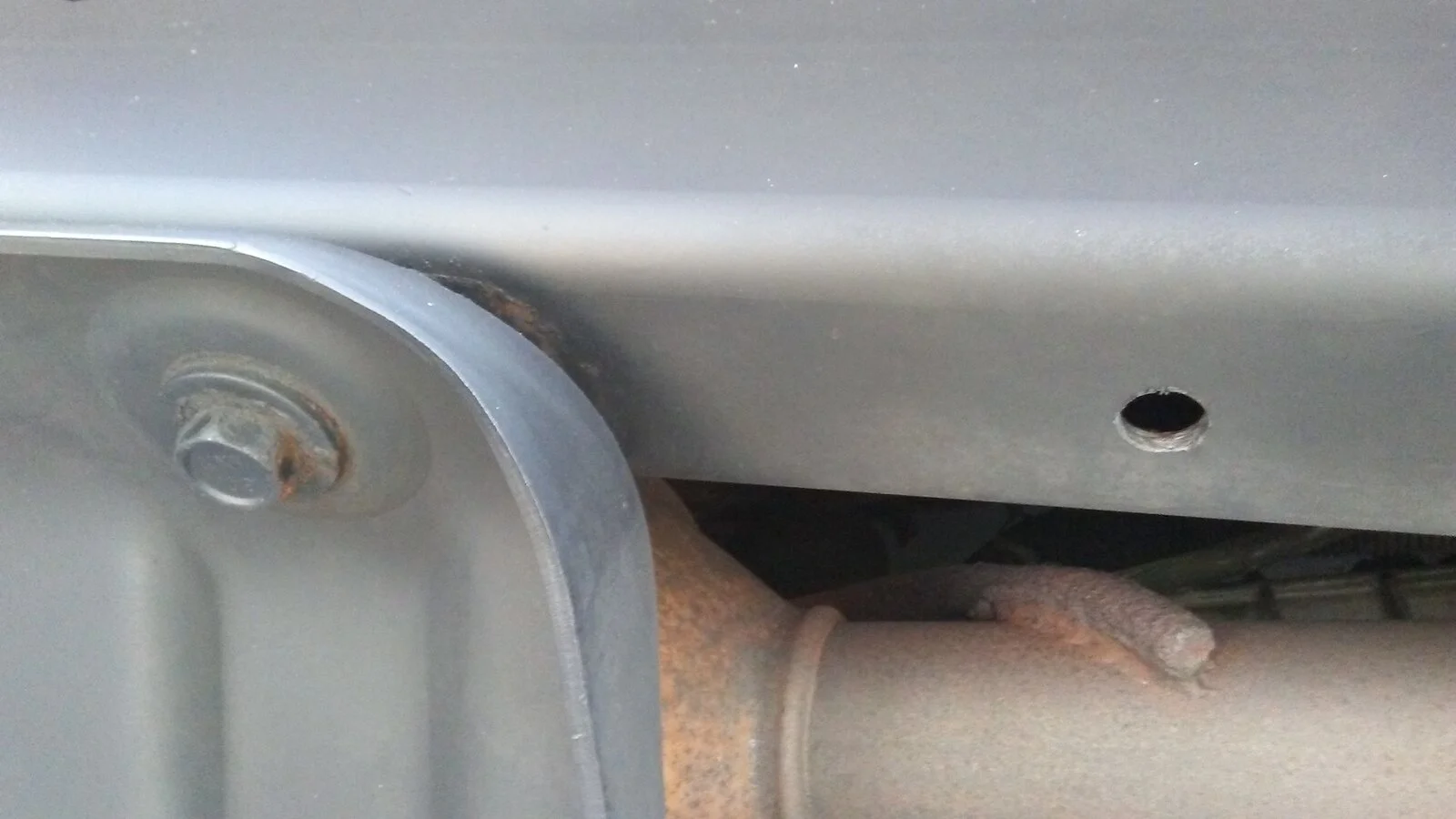

Rustoleum is good stuff. ;) I used a wire wheel attachment to clean up everything, Eastwood inside, Walmart cheapo stop rust paint outside and drilled 4 holes in the frame on mine 3 years ago when I bought it.

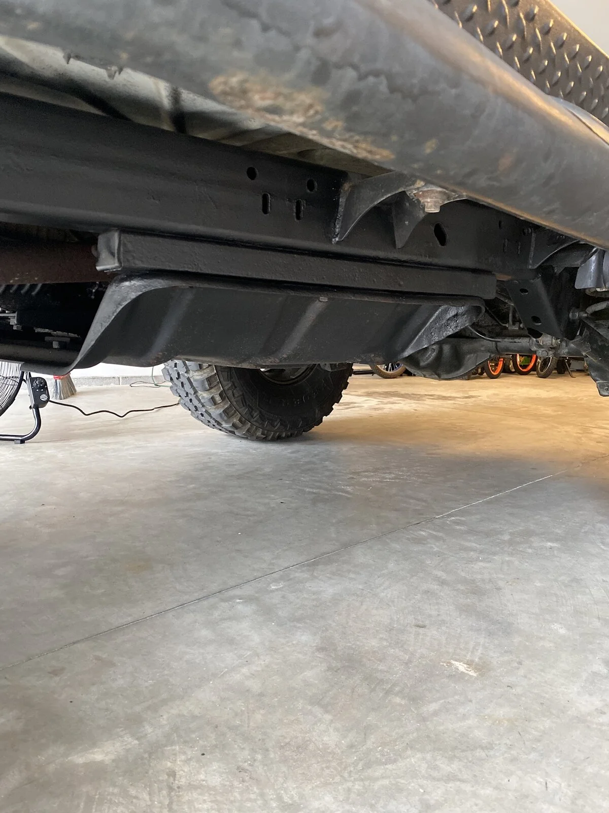

I used rustoleum on my frame up to front axles. Going to finish it when I pull bumper off to repaint. Like they said it rots from inside out, but I like a cleaner look. Here is a before and after, had to do the best I could with transfer case drop until I can afford to remove it.

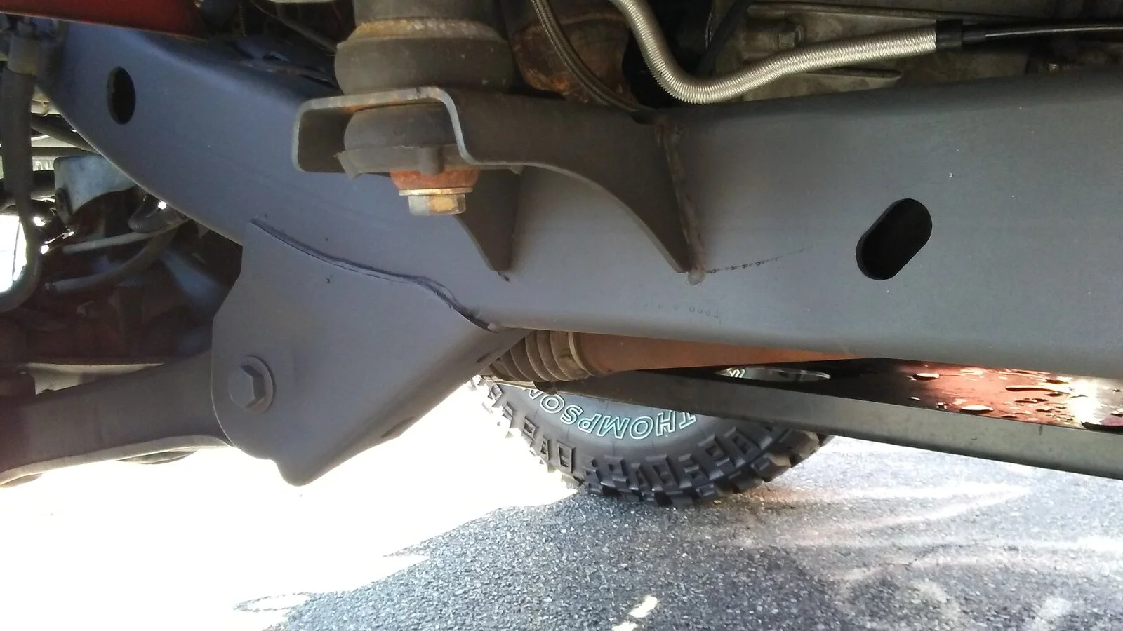

I don't know the prices, and i dont know if it is better or worse than anything else, but i will throw in this as an option that i did:
quart of EASTWOOD RUST ENCAPSULATOR PLUS
can or two of EASTWOOD RUST ENCAPSULATOR BLACK AEROSOL
Total $86
quart of encapsulator plus was enough to coat entire frame and what ever else, and a spray can for spots where brush could not reach + an extra spray on layer on top of encapsulator plus cause it is not UV resistant and spray paint is.
