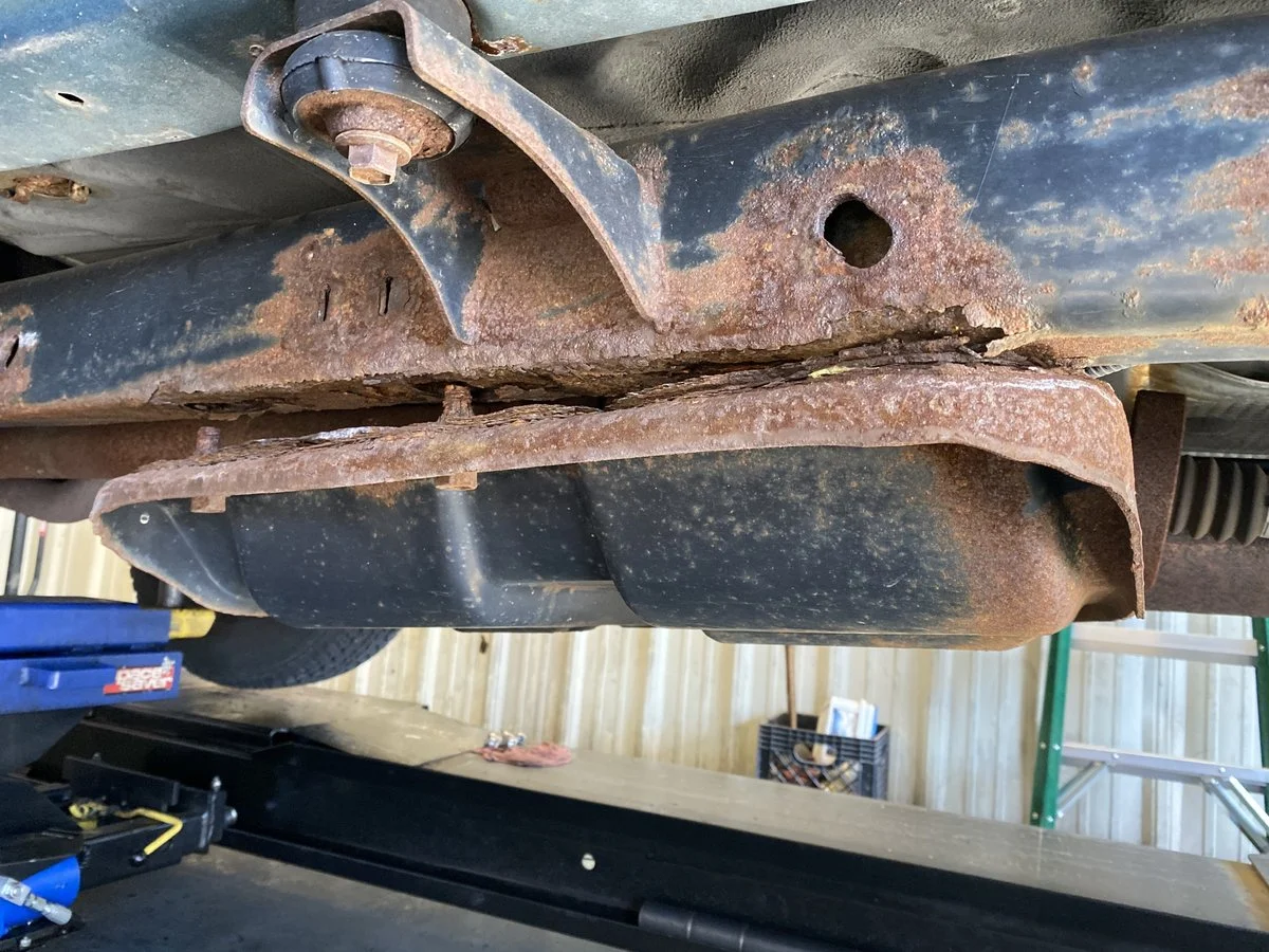

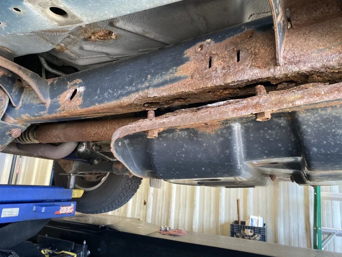

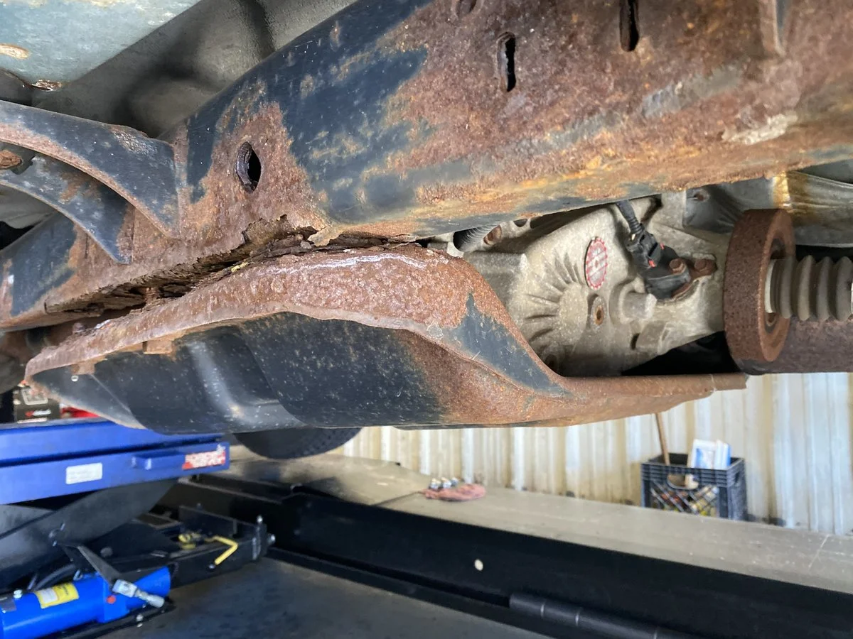

Hi all - joined this forum to ask this question, and I've done a fair amount of online research so I apologize as I know this is a common thread.
We've had our TJ since new in 2001 (MY 2002). It lived in the NE for a while and saw salt, unfortunately. It now has 69k miles and we use it as a non-essential vehicle (which is not to say it's not useful and we don't love it).
I recently had new tires put on, and the shop pointed out the dreaded frame rot issue. The transmission cross member is currently held on by 2 out of the 6 bolts, and the underside of the fame in that area is just plain gone. I've put the vehicle on the bench for the time being. Of course like a dummy I let them put the new tires on, which I'm now worried may have been a waste of money.
I've called one shop in NC and sent some photos, and was quoted $2200 to have the SafeT Caps put on the middle section. So partially, I'm inquiring about whether that seems like a fair price.
Of course, after doing some research (And the shop recommended that I check this as well) I've also inspected the rear spring mounts and those appear pretty rusted out too. The shop mentioned they could fix those areas too. They'll also clean and spray the entire frame for future protection.
I'm seriously considering this but wanted to see what people think. Obviously I have doubts about sinking in several grand into an aging vehicle. At the same token, it's fairly low mileage for a 19 year old car, runs well, and has been in the family since new. If we were to say goodbye, we'd likely not replace it with anything.
Oh and also while looking at it again tonight I noticed that there's an apparent oil leak which I suspect is the rear main seal. So that's great.
What would you do in my shoes? Any recommendations on how to find good shops for competing estimates, or know any good shops near Charlotte, NC?

I went through a very similar repair on my 2001 that I also owned from new. I was hesitant at first and immediately after but the safe-t-cap repair turned out pretty good and I am glad I got it done.
See my thread here for pics: https://wranglertjforum.com/threads/well-i-got-the-dreaded-news.14065/
I paid about $2000 out the door so that price isn’t too bad. I bought my own skid plate so that might be the difference in price. Yours looks worse than mine did so you’re potentially getting more bang for your buck if that helps at all.

@jodomcfrodo can paint a very good picture of what it costs to truly repair something like this by swapping in a clean frame.
That frame is toast in more areas than one. You can of course cut the bad sections out and replace them with new SafeTCaps (or similar), but if the outside of your frame looks like that in those areas, I can almost guarantee you that the entire inside of the frame looks like that.
The only way to truly fix something like this is by swapping in a clean frame, and that's going to cost you around $2000 to $7000 depending on if you do it yourself or pay someone to do it for you (and also depending on what else you end up finding while you're in there).

While a frame swap is the ideal way to go, certainly, just because the center section is rotten does not mean the rest of the frame is. These TJs had a very specific defect that allowed water to pool in the lowest parts of the frame without a means to drain out. In the majority of cases—and I can say this confidently as someone who lives in the rust belt and has had Safe T Caps installed on his Jeep—the rest of the frame is OK. The two problem areas are under the skid plate and where the frame curves above the rear wheel.
If installed correctly, the repaired frame should outlast the rest of the vehicle.
