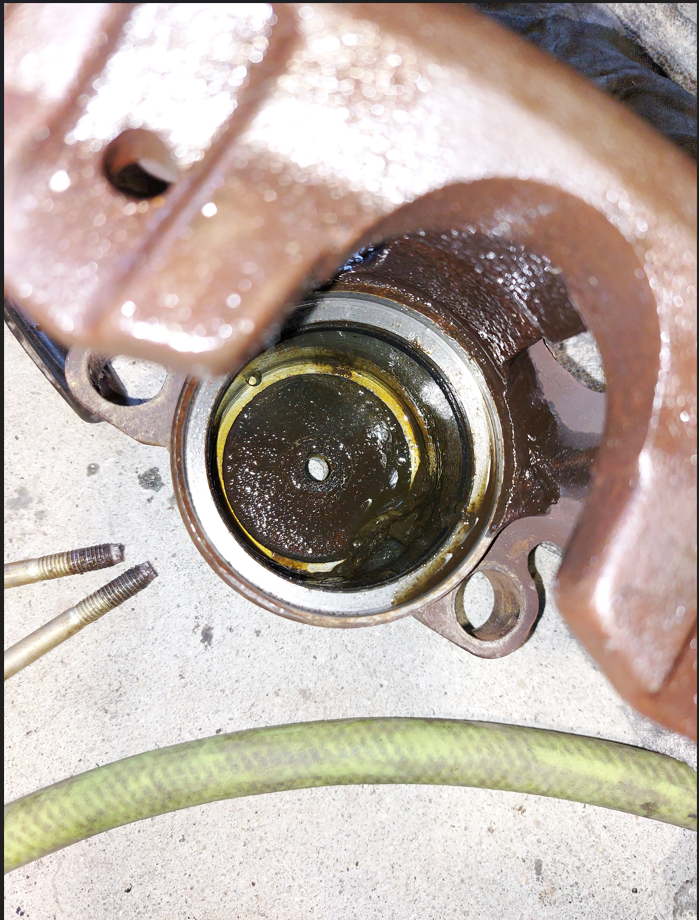

We had to wire brush and scrape this gunk out of the caliper piston bore. Bleeding beforehand won't always get it done.

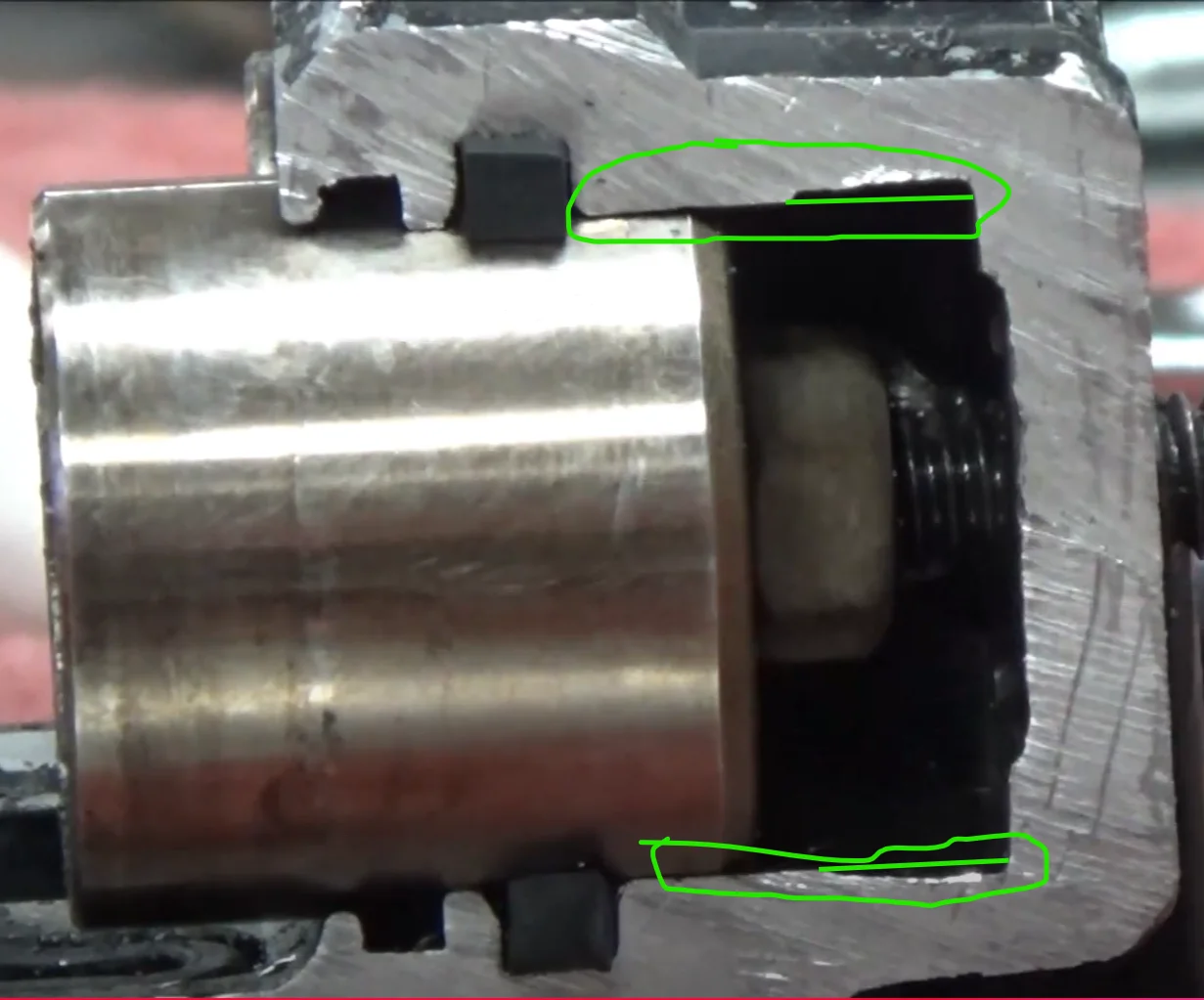

I started doing something like that a few years ago. Every time I do brake work I open the bleed, press the piston back, seal it up and put things back together, then bleed the lines last step. That way if there is any gunk behind the piston it has a chance to be flushed, and I cycle fresh fluid into the system.
The problem with doing it that way is you aren't giving yourself the best chance to flush contaminants out of the piston bore. The pic shows a cutaway and how close the piston fits into the bore. Ours are straight bore without the larger area at the base of the bore. When you push the piston in first before flushing, you run a higher risk of trapping gunk that can cause the piston to stick or be sluggish to move and cause drag.
