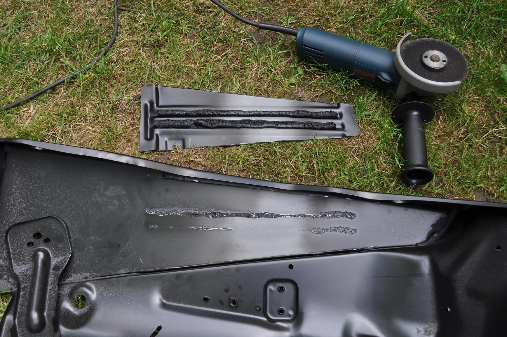

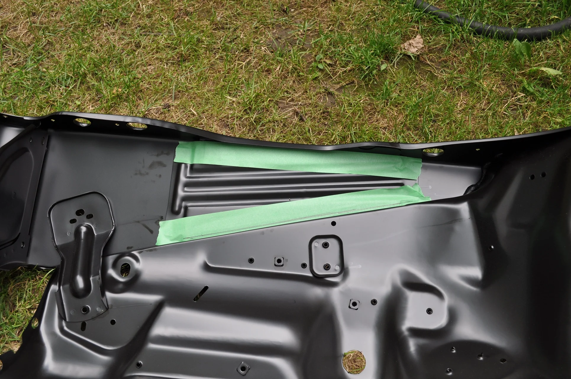

I've posted this before and I think it's worth doing again now that it's been about 3 yrs. since I did it.
I replaced my front fenders with factory style originals. The previous ones had rotted through in usual spots ... the horizontal flat areas on top. I could clearly see that the new ones were not well primed between the underside of the fender and the top side of the panel that I believe is meant to be a stiffener. From memory the gap between the 2 is about 1/4" and there were 2 rows of adhesive. It's basically a rust trap.
I removed the panel on each fender, sealed various edges and then primed and painted them as normal. I use Fluid Film and this area gets a coat annually.
I drive my LJ year round through the worst of winter so it gets a fair bit of abuse. I don't think these panels are needed at all.

Some say it's for sound suppression, others say it's for structural rigidity. It's likely both, but there's not much structure once it all goes brown lol.
I figured they might be for rigidity but I hadn't heard about sound suppression. On both counts, I haven't noticed any difference at all. Kind of funny if those were their priorities over RUST! :giggle:
