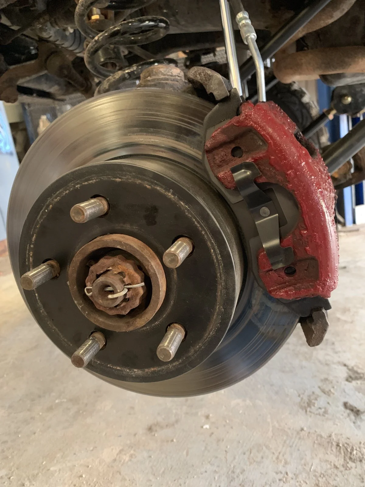

Finally got the Jeep off the lift and took it for a test drive. Went about 3 miles when the front left pretty much locked up. I hope I didn’t completely ruin my new black Magic Brakes I just installed. I think I need a new caliper. Do I trust autozone or does someone have a link for a good one I should be using?
Followed the directions to a t. I got new fluid all in it. It locked up on the way to the shop on the old brakes. The problem was my wife was driving it and not me. So I never figured out exactly what it was until now. I thought it was the rear drum that locked up. When I pushed the caliper back in it seemed to go in with no
Issue
Autozone has 2 durolast calipers In stock. Don’t know if I should take this route but that may be the only thing that gets the job done today

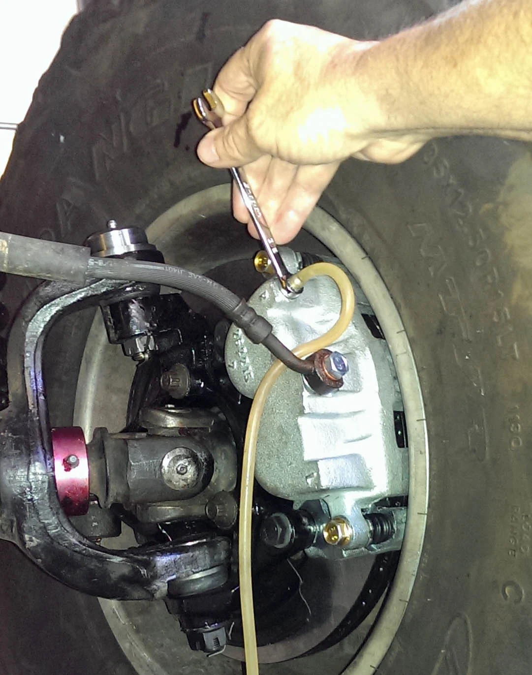

Both calipers have the bleed valve positioned above where the brake line attaches?
Like this?
Reactions: mikespine
Ya I had the fittings up. There was no fluid coming out the left caliper. I was bleeding it solo using the line to a bottle trick. I had no fluid almost like I had the bleeder valve shut. So I took the banjo bolt off the caliper and hit the brake petal 3 times. I had fluid come out of the line just fine. So I hooked it back up. Tried bleeding again. This time it worked. Just took it for a 2 mile test drive and had zero issues.
The issue with this method is that the threads on the bleeder don't seal so they can suck air back in.
You may have a brake hose that is breaking down internally. Externally it looks fine but the rubber swells on the inside and restricts flow. It will allow the high-pressure fluid through from the master cylinder but the doesn't allow the low-pressure fluid to return from the caliper.
Reactions: Willys LJ
It seems to be working fine now. I really don’t know what happened. But if there was some kind of restriction it must have flew out when I pumped the brakes with the banjo bolt out. As for the rubber lines they where all just replaced with raybestos lines off a yj.

I've been down that road with old hoses a few times and it can be maddening. Just because it doesn't do it every time, doesn't mean it won't happen again until you replace the hose with a new one. I just replace the hoses with new if I have any doubt.
