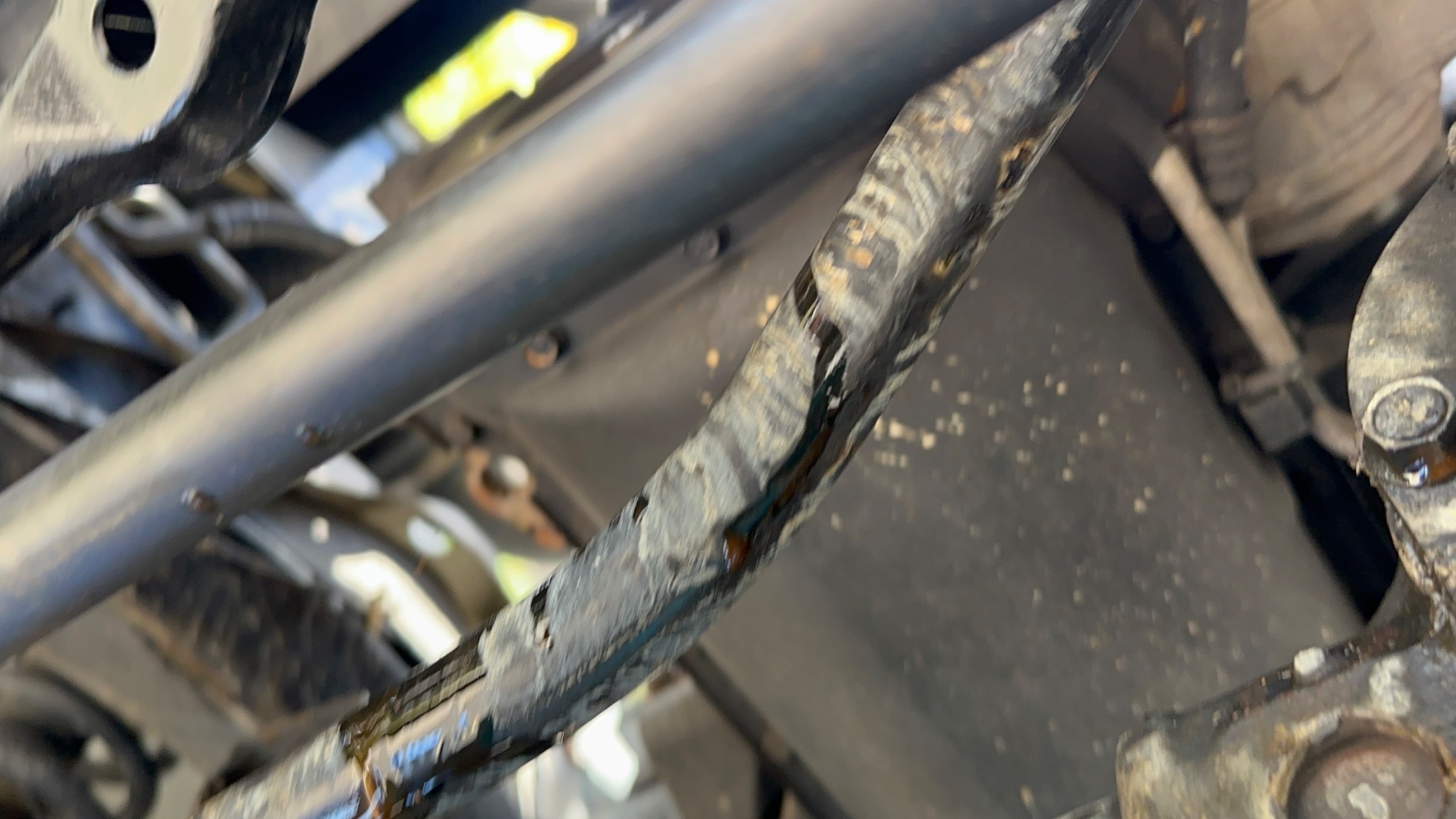

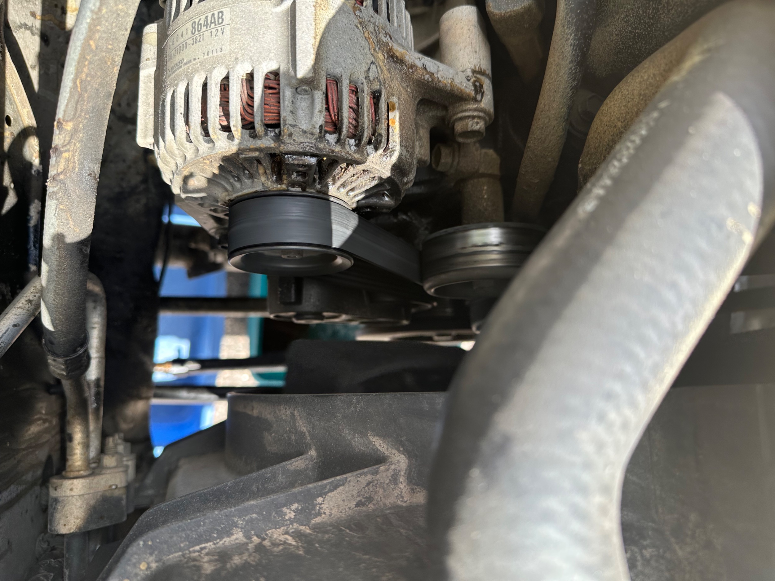

It’s coming dripping pretty hot and heavy. Two videos:
These posted as pictures. Forums are picky with media. Post those on YouTube and then send the link here. Either way, if oil is coming out that fast all of a sudden, you need to look into your PCV system while replacing the seal(s). If the PCV system is clogged or stuck closed, this will keep happening even after the repair as the seals effectively become your PCV.
There's not a traditional PCV system on the 4.0. Orifice in the rear elbow, front elbow is straight through to air box. If rear is plugged, the pressure and oil will go out the front elbow into the airbox.
