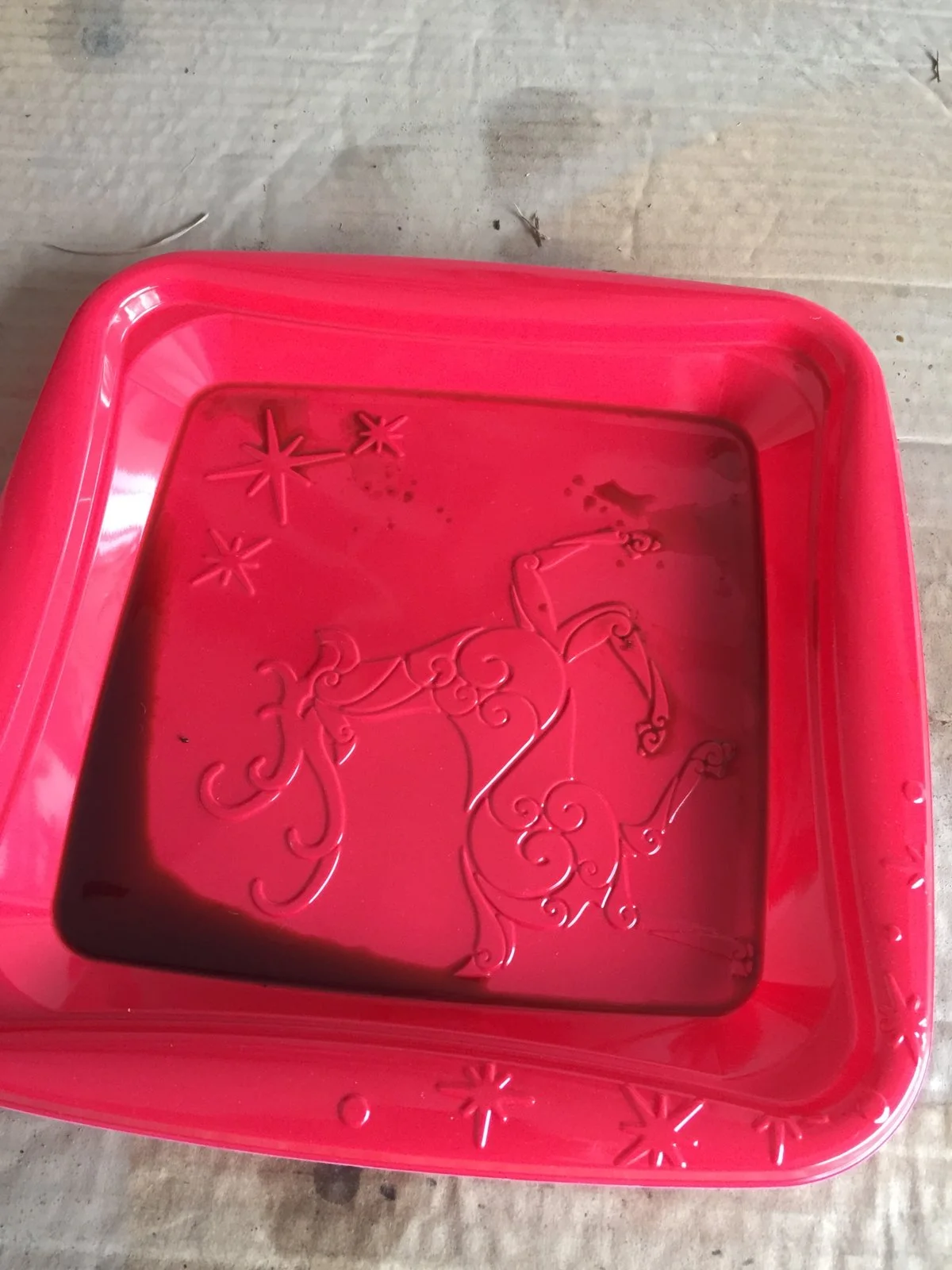

I went on vacation for a week and left a small plastic plate under the Jeep to see how much oil I lost. This was after eight days.
Might be time to do the rear main.
Or leave the pan under it and live with it.
