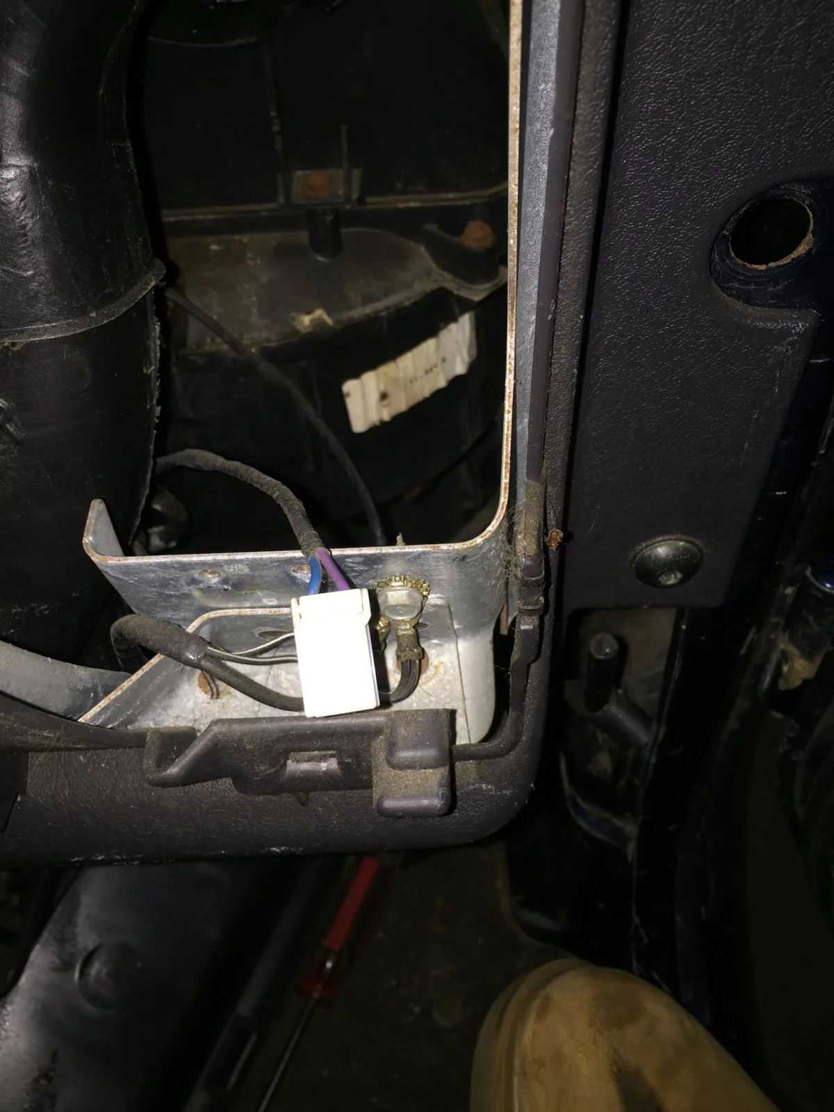

yeah i checked the balance and it's neutral to the front and back and there isn't 12 volts going to either side of the front speakers
No wires connected at all?
there is not any power going to here. does this connect into the head unit? because it seems that all of those wires are secure
The Balance control only affects the L-R balance, it is the Fader control that affects the F-R balance. Make sure the Fader control is set full-front to verify that the front speakers do or do not work.
If the front speakers still don't work with the Fader in its full front-position, reverse the F/R wiring... connect the rear speaker wiring which we know works to the front speakers and see what happens then. Isolate it to the radio or the speakers/wiring.
