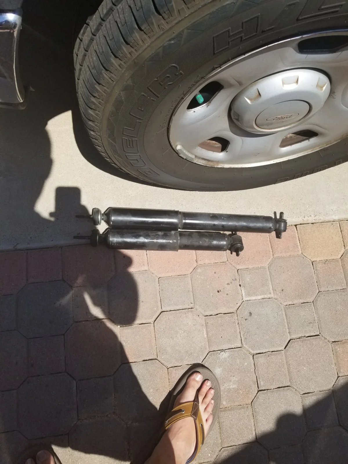

The shocks are brand new though I've wondered if one is defective because there's a clicking sound that comes from underneath when I turn sharp that I think is coming from my passenger front shock. Though I'm not sure how a defective shock could cause the spring to compress an inch more than its counterpart?
they look to be seated properly but I'll have to get under there tomorrow & really look closely from all sides.
To be honest it would be a long shot if it was your shock. It would have to be binding up. If you can bounce that shock i would think it was ok.
Mine were not seized but one side did not move without a lot of force. To be honest I never measured each side nor noticed if it was leaning.
Jump up and down on the bumper on that side and see if there is free movement but it is most likely the spring on that side.
just tried that, shocks on both sides feel good. I just adjusted the track bar last week so I thought it might be related to that, dropped it down & jumped up & down on it again then remeasured it with and with out it attached and no change, still a solid 1 inch droop on the passenger side.
