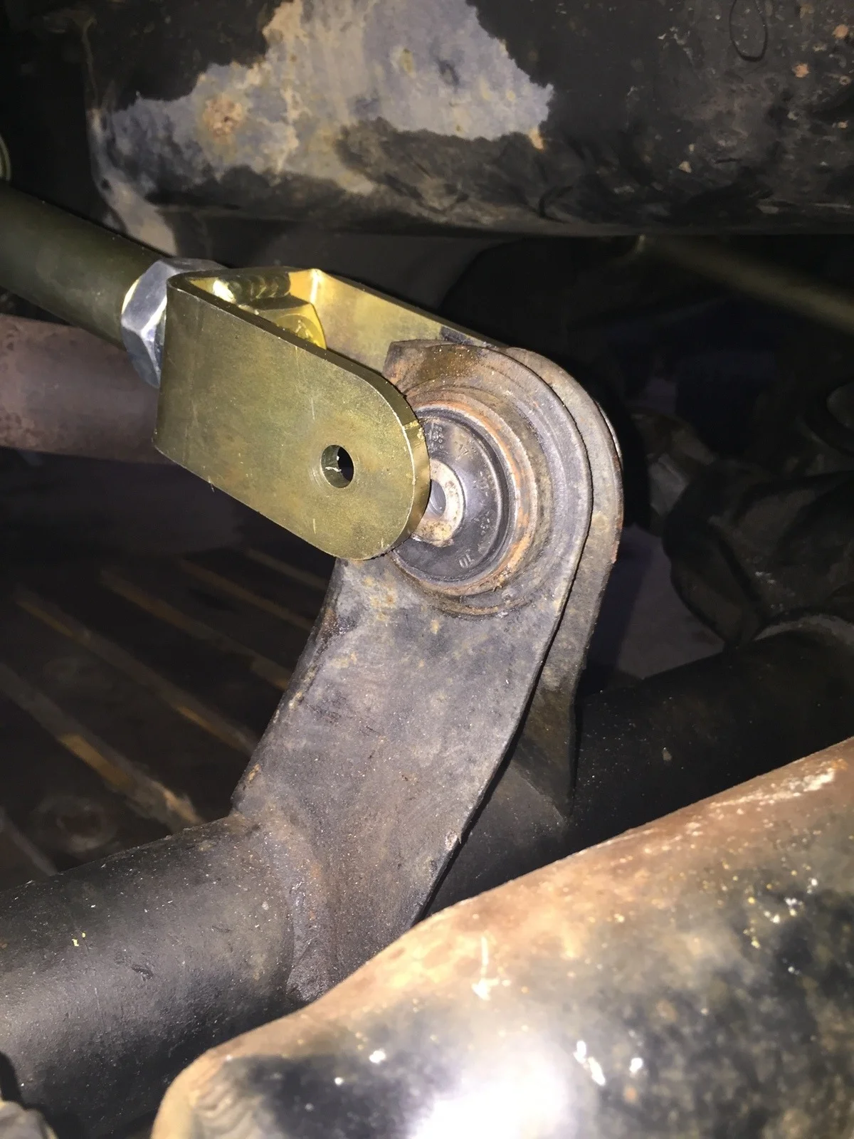

I finally have both bushings installed. How do I get the control arm forks to line up with the bushing holes?
I finally have both bushings installed. How do I get the control arm forks to line up with the bushing holes?View attachment 23821
Ratchet straps or a lot of force... It's not fun, I'll tell you that much. That's why I always do control arms with the vehicle on the ground and the wheels on, one-at-a-time. It's much easier that way. I made the mistake of taking them all off at once... What a nightmare that was to get them all back on. It took two people and lots of monkeying around.

Thanks. I’ll give this a shot tomorrow.
