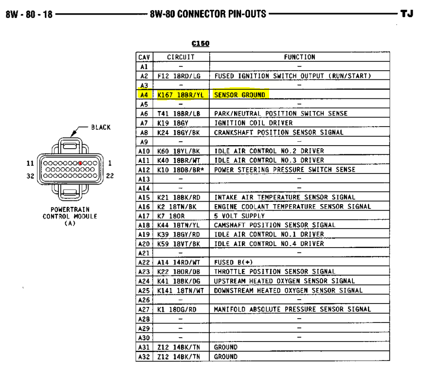

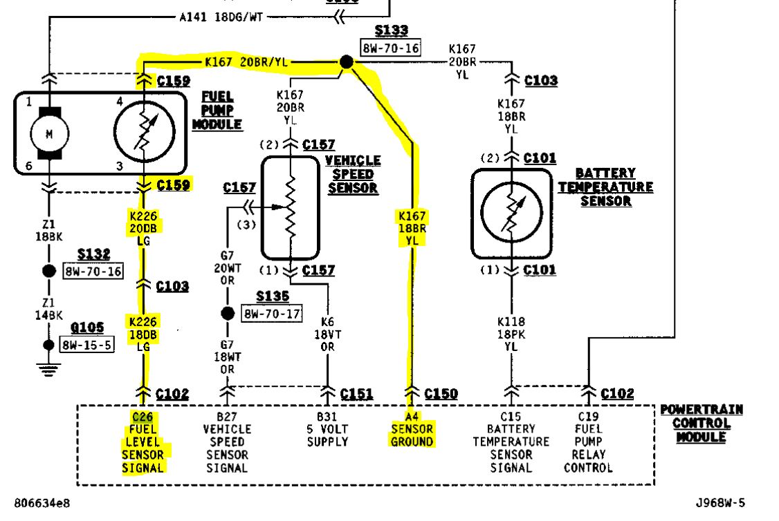

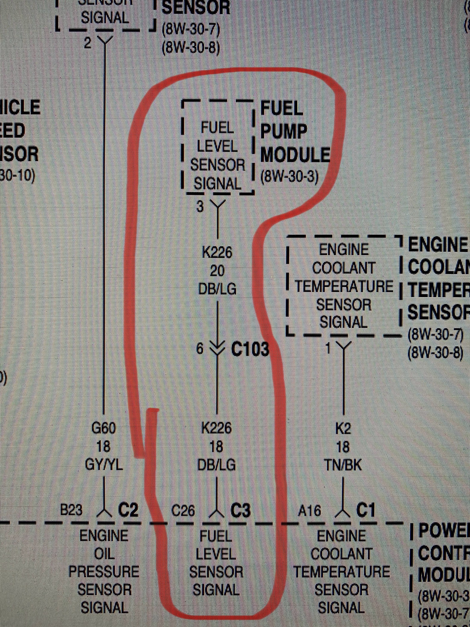

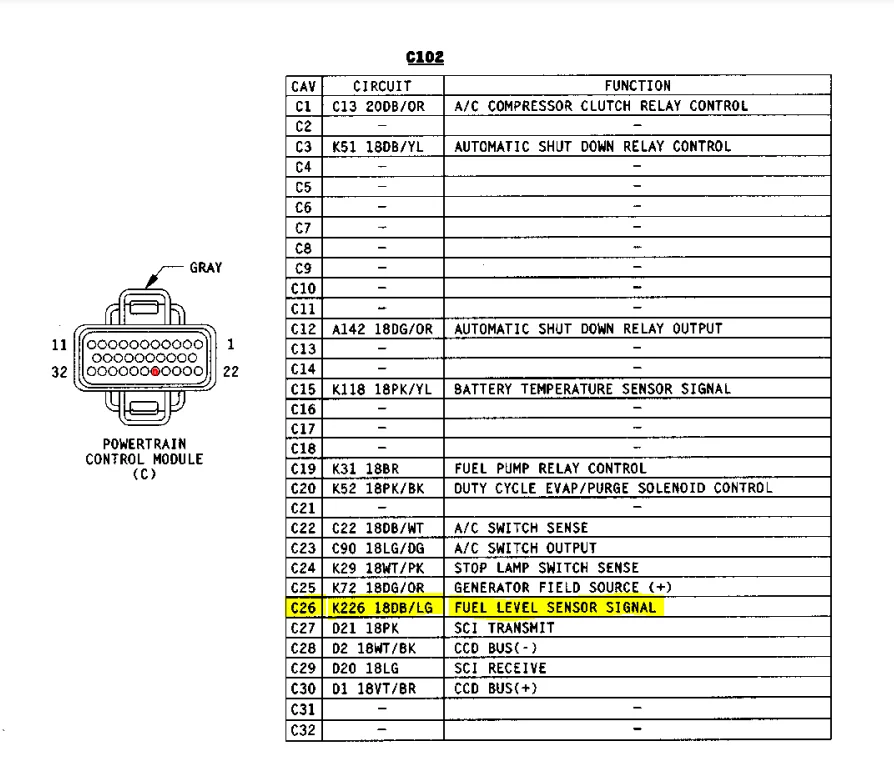

I think I searched and read everything related to my problem but here's my situation.
Ive had an inoperative gas gauge for several months, I was planning on changing out the sender and fuel pump assembly soon, but this week I've been doing a few things to the jeep and had disconnected the battery while completing my work, twice now I reconnect the battery I've noticed the gas gauge working fine for a few minuets before dropping to empty again.
So far I've looked at the Plug / Wiring at the top of the tank ( driver side ) and have done the gauge cluster test with the trip OD pressed and the Key on. everything looks good.
Any ideas ??
