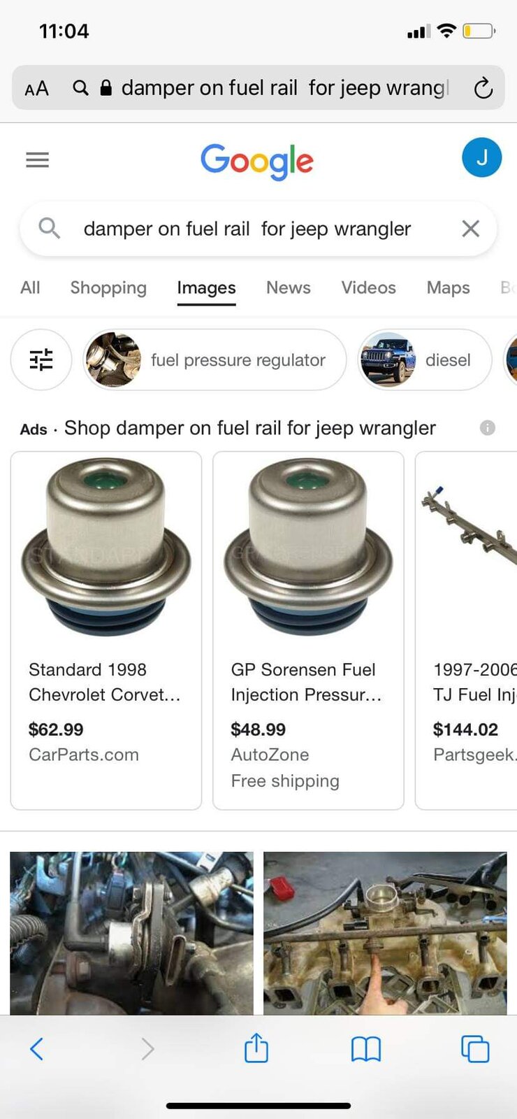

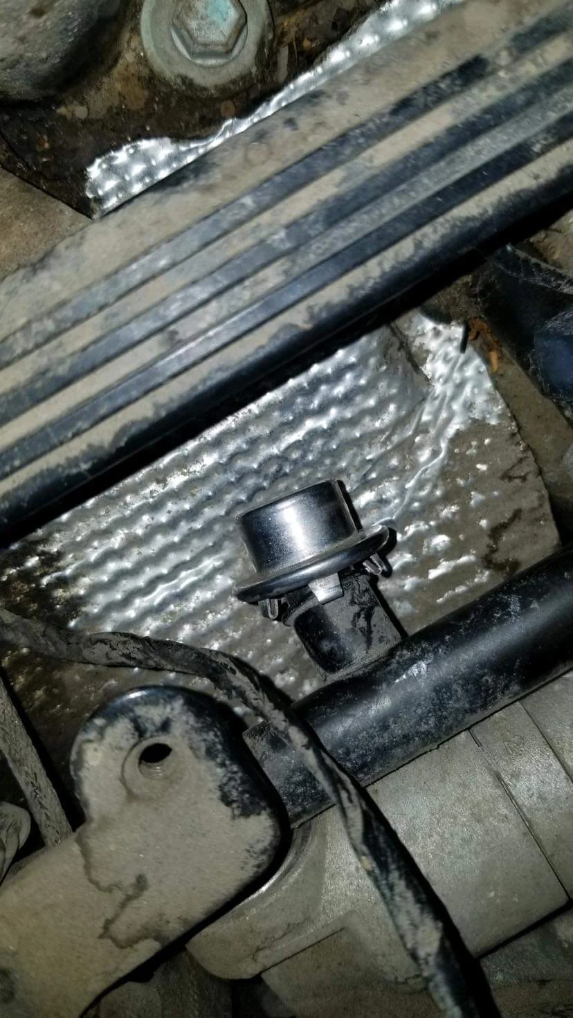

This part is what popped off she said:

I would replace it. That is the pulse damper assembly. Looks to me like the clips failed or it got bumped. Either way I wouldn't trust it anymore. If that came off when the engine was hot it could be a total loss event. Dealer for new, junkyard or Car-part.com for used.
