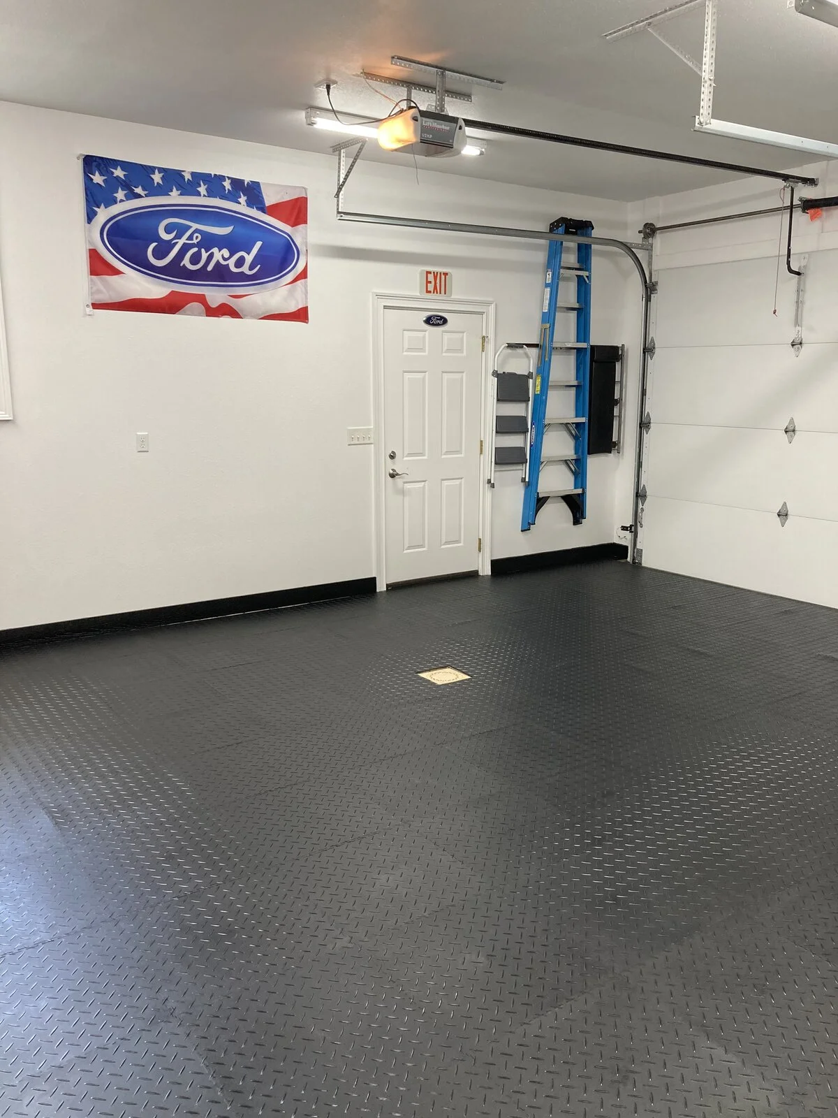

At that price you could do a garage/vinyl floor for less than half the price, something like this.
http://www.homedepot.com/p/G-Floor-...ct_203450706&gclid=COr81Ku8_csCFQckhgodvOEP9A
Yep, this is the route I may go. I would like half of the garage at least to be sort of a cool 'work shop' for my motorcycle where I can place all my nice tools, my motorcycle lift, etc. The vinyl may do the trick since the motorcycle is never dirty, and I don't turn the tires back and forth (to cause black marks) like my wife would with the car.
