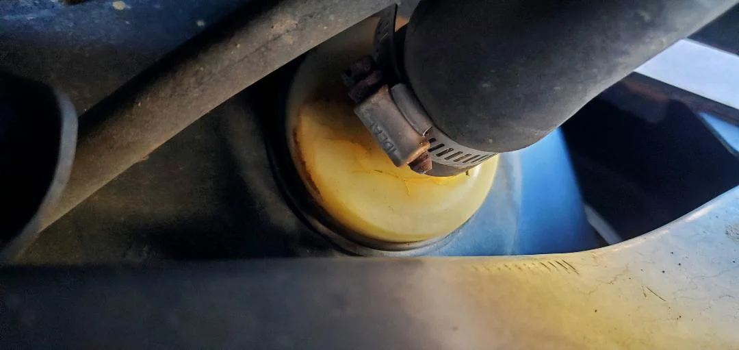

I have a crack in my gas tank at the filler neck. It is causing the CEL. My friends shop took care of the misfire codes, but this remains.
I am told Mopar no longer makes our gas tanks. My question is, aftermarket or a good used one?
Here we go. Can I fix this?
