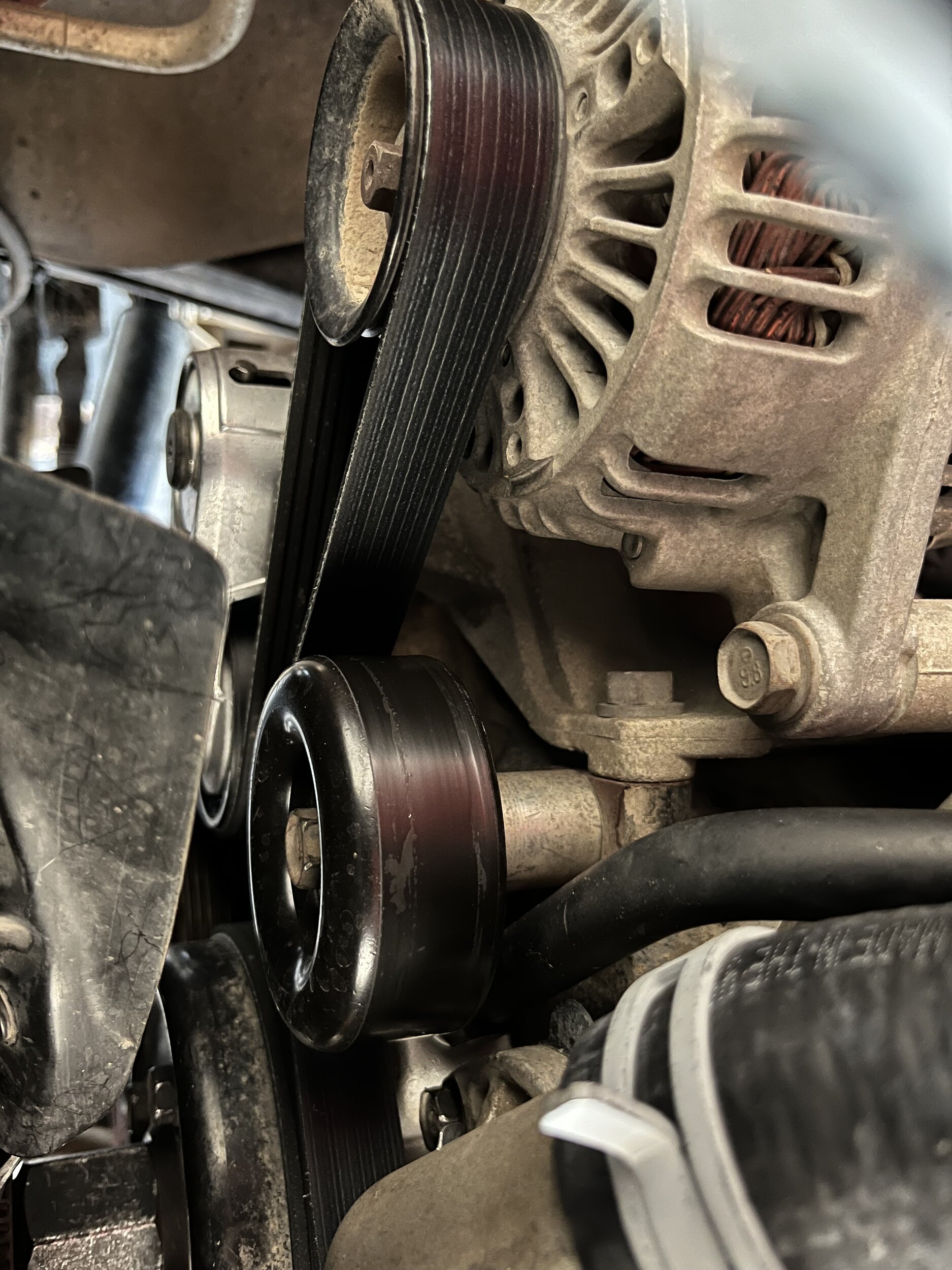

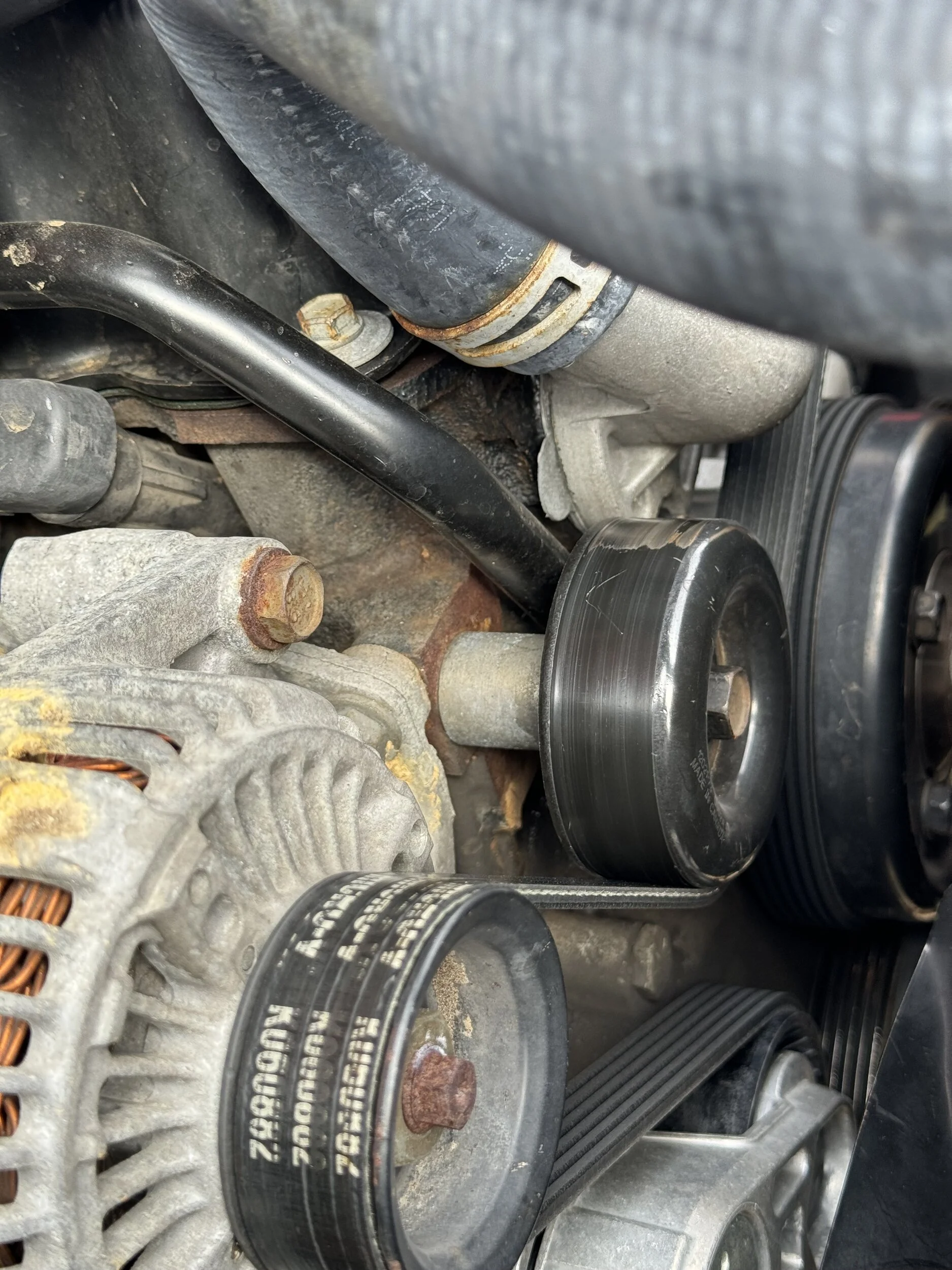

Just an update...I was able to use the Gates idler pulley on my 2001 Wrangler Sport from RockAuto along with belt tensioner and serpentine belt. Like Red02tj I had to re-use the original spacer mount and bolt also had to not use bushing in kit (like Ron Hall) and delete dust cover over bearing. Gates sent a letter with idler pulley stating if Mopar factory dust cover doesn't fit Gates pulley don't use because bearings are sealed and not really needed.
