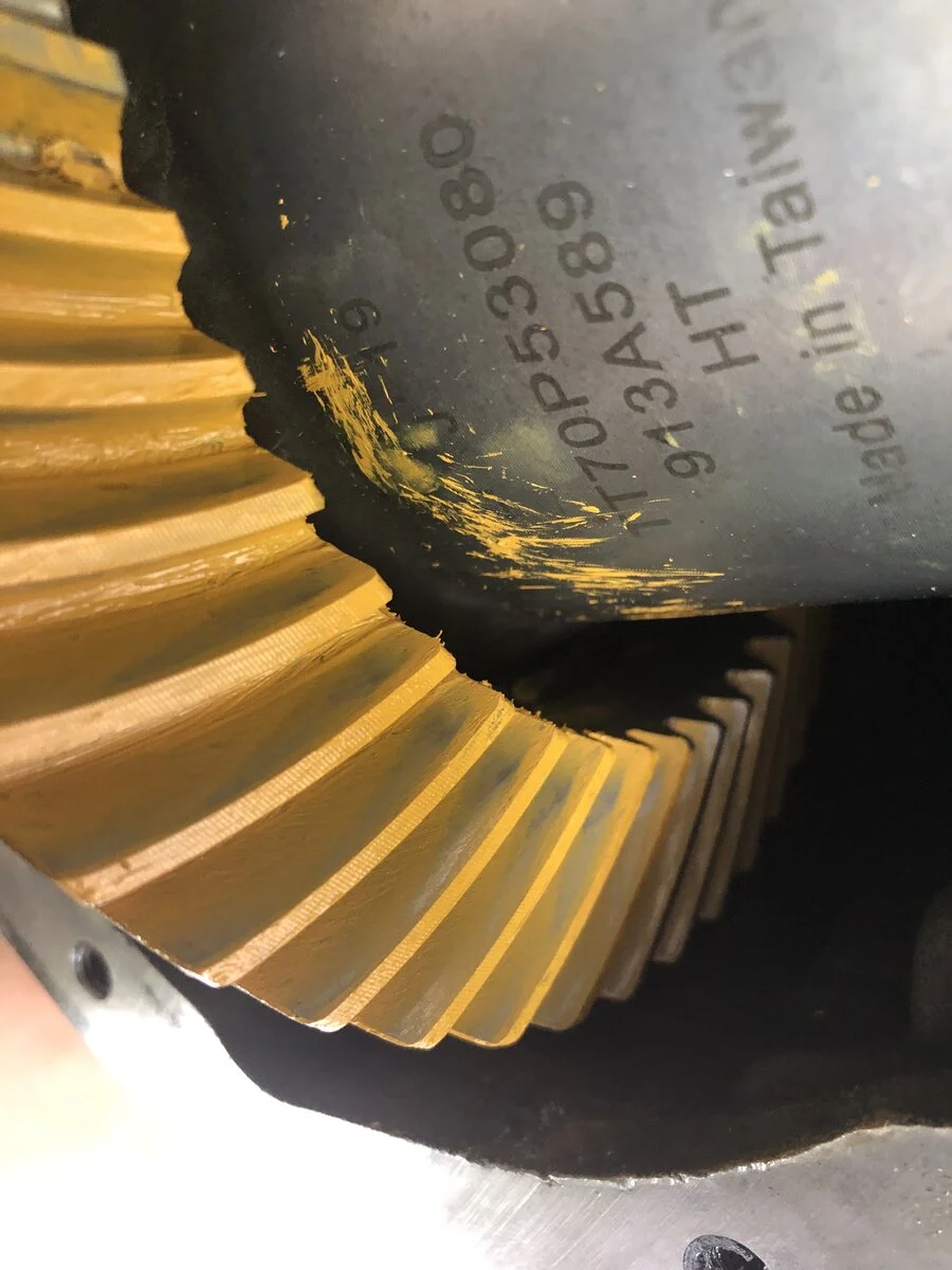

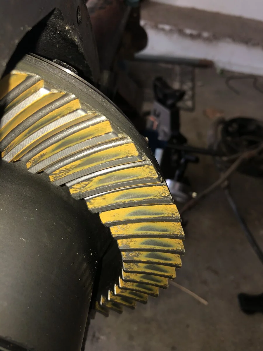

Please help me confirm I’m set up right or need to adjust. The only swap was on an open diff to an LSD. gears were swapped out about 3 years ago by an off-road shop. The first pic is drive side, second is coast. Backlash set to .004-.005 based on measurement taken before swapping the diff. I have not messed with the pinion at all, just the carrier bearings
Come on where are all the gear setup guru's at???? It looks a little to much toe on the coast side to me but I'll error to those with more experiance.
Thanks @Wildman haha. I feel the coast is pretty tight too. And that diff is locked in there!!! I broke two ratchets straps yesterday trying to get it out so I'll need to find another method. The manual calls for .005-.008 and I'm right at the minimum threshold. If I increase backlash on ring side by .002 I may be more in tolerance.....I think

Well, played around with shims for about an hour and pretty much back where I ended up but with more shim width to the ring gear side. Brought my drive side to the center and the coast side is ever so slightly pushed to the center. BL is .005. It could be the way the 4wheel shop set the pinion. Gonna try to Add to ring gear side and subtract from button side and see if that helps.

Ok, I’ve effectively managed to get the backlash back to .004-.005 and the gears feel really smooth. Almost no change to the pattern though. I’m happy with it and I’m going to roll it this way. Everything I’ve read said desirable contact pattern is center/center but coast can be more on the toe, which is where I’m at.
If you are re-using gears, run a pattern before taking it apart and take pictures of it. After swapping the carrier/locker, try to match the pattern. I always start off with the shim stacks exactly as they were originally as that should be very close if not the desired set up. If all you did was swap your ring gear from one carrier to another, then I would get the backlash the same as it was before. With all that being said, I can't say I'd run that because I don't know what it looked like prior to that.

Trying to setup used gears is always a trial and error thing. Back when I was first building my TJ I bought used gears since I couldn't afford new ones. I ran them for almost 3 years but they were never right.
The other thing to note is that used gears have a different backlash number than new gears. I looked and couldn't find it but I know they are different.
A carrier swap isn’t going to change your pattern so long as the backlash is the same. Seems to me your pattern concerns really stem further back than this repair.
