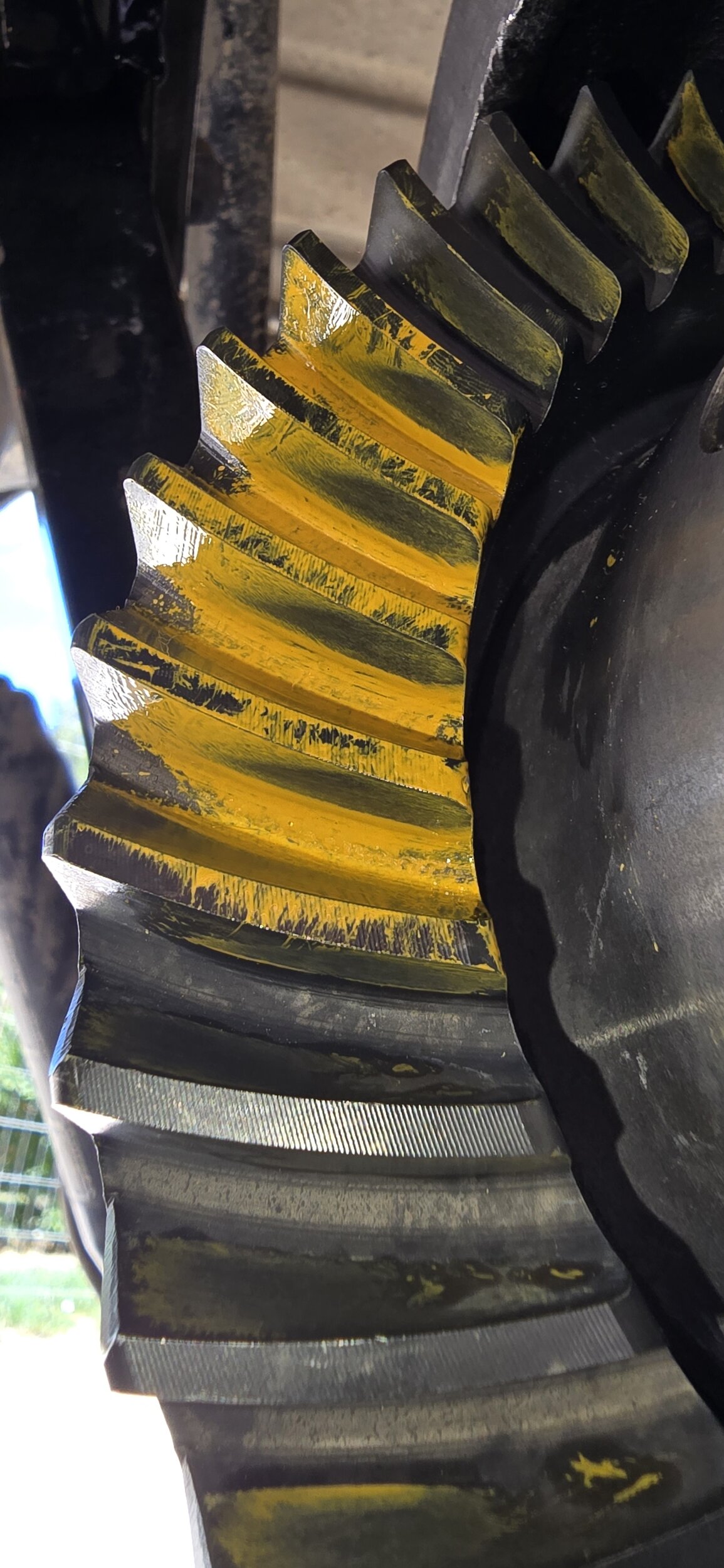

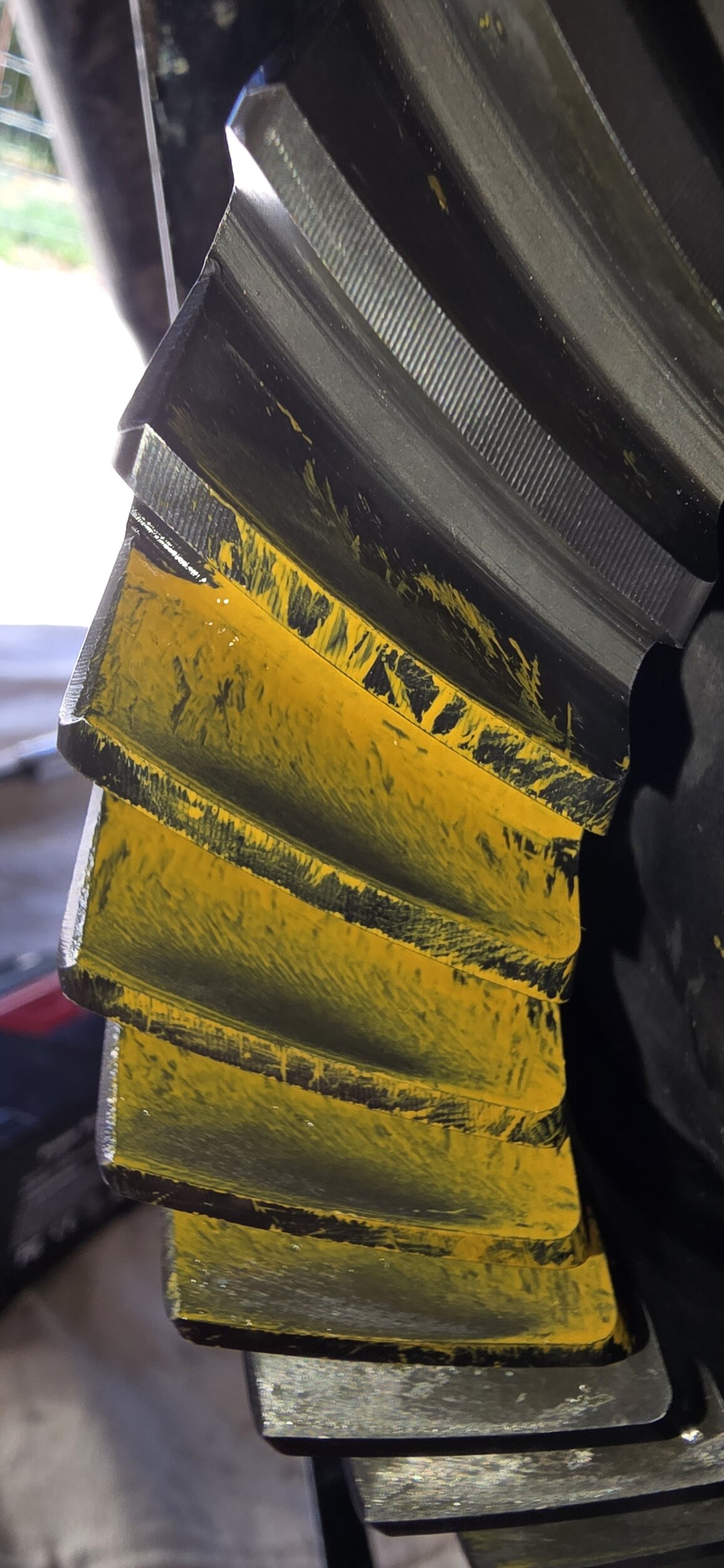

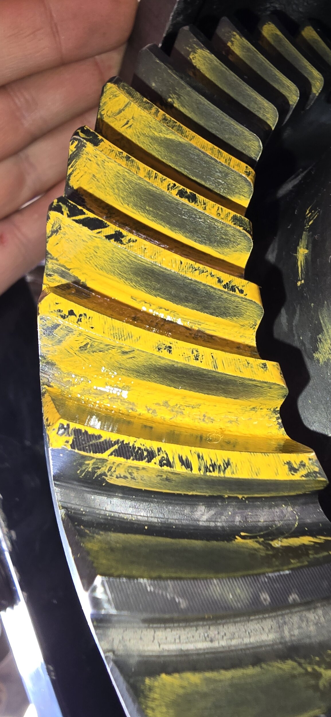

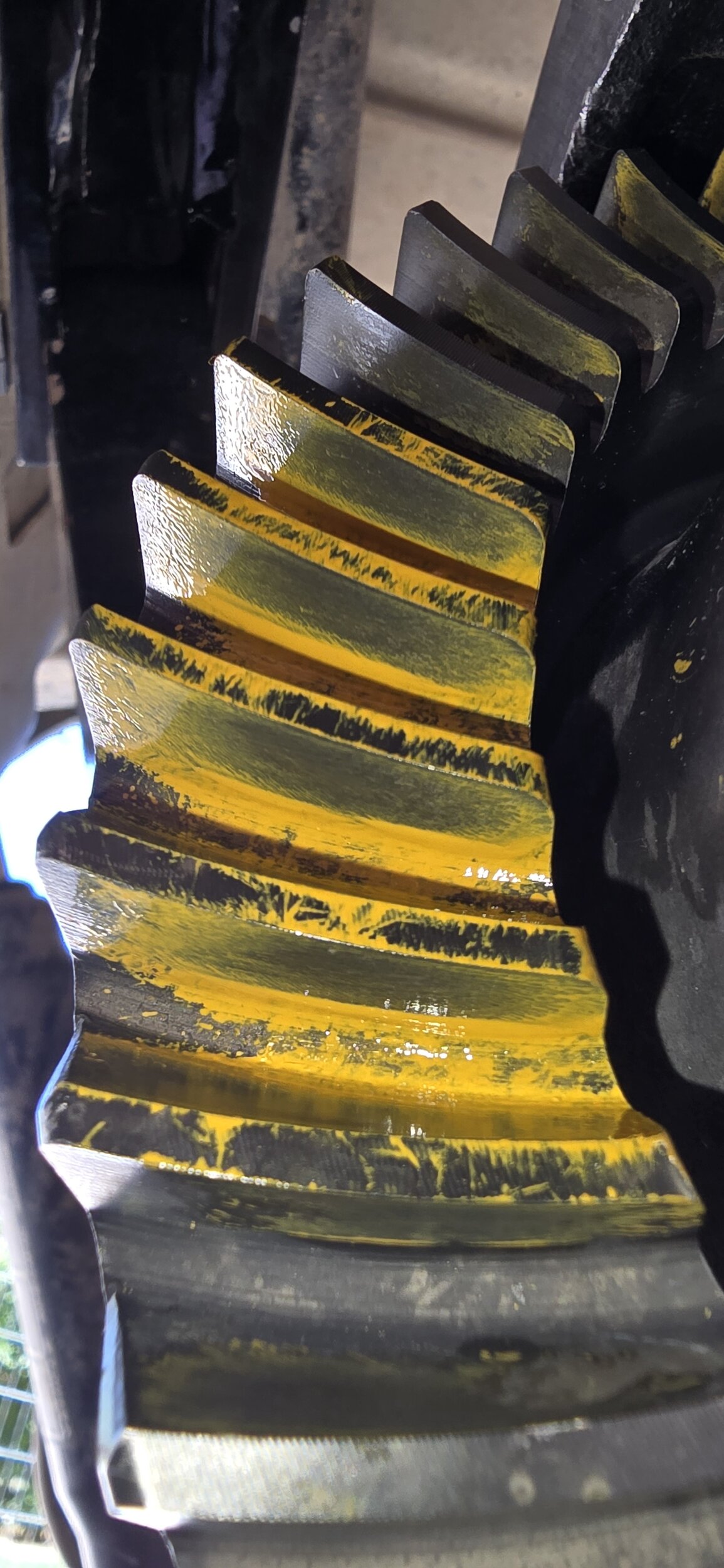

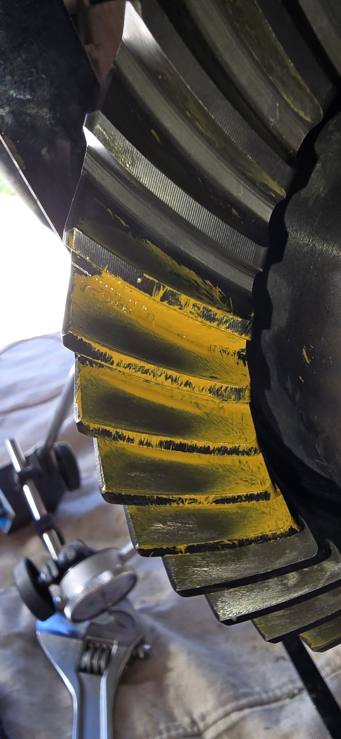

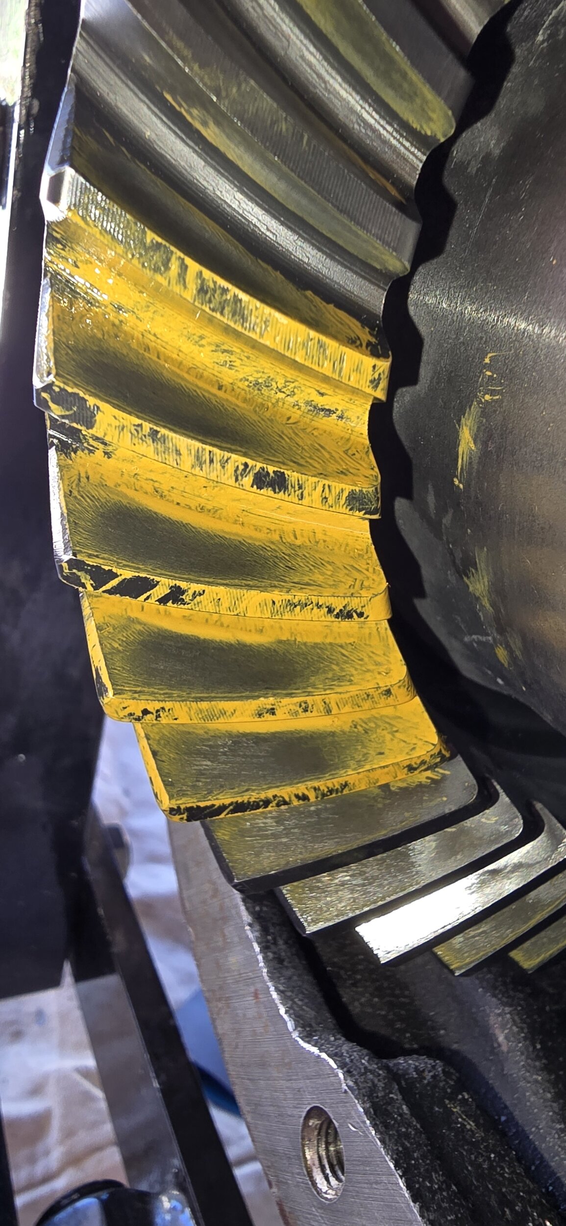

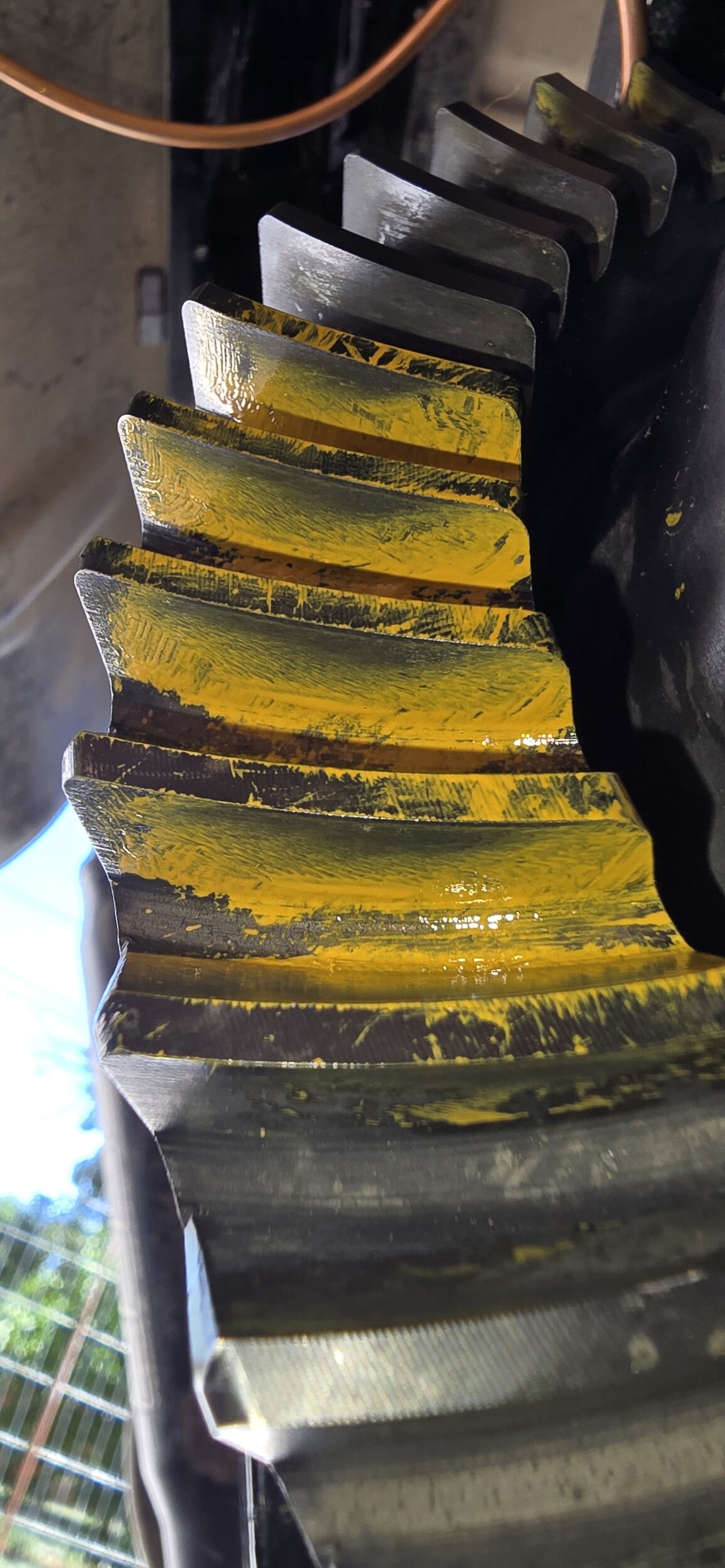

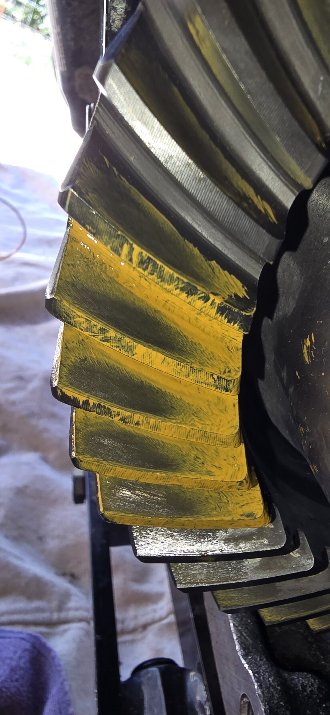

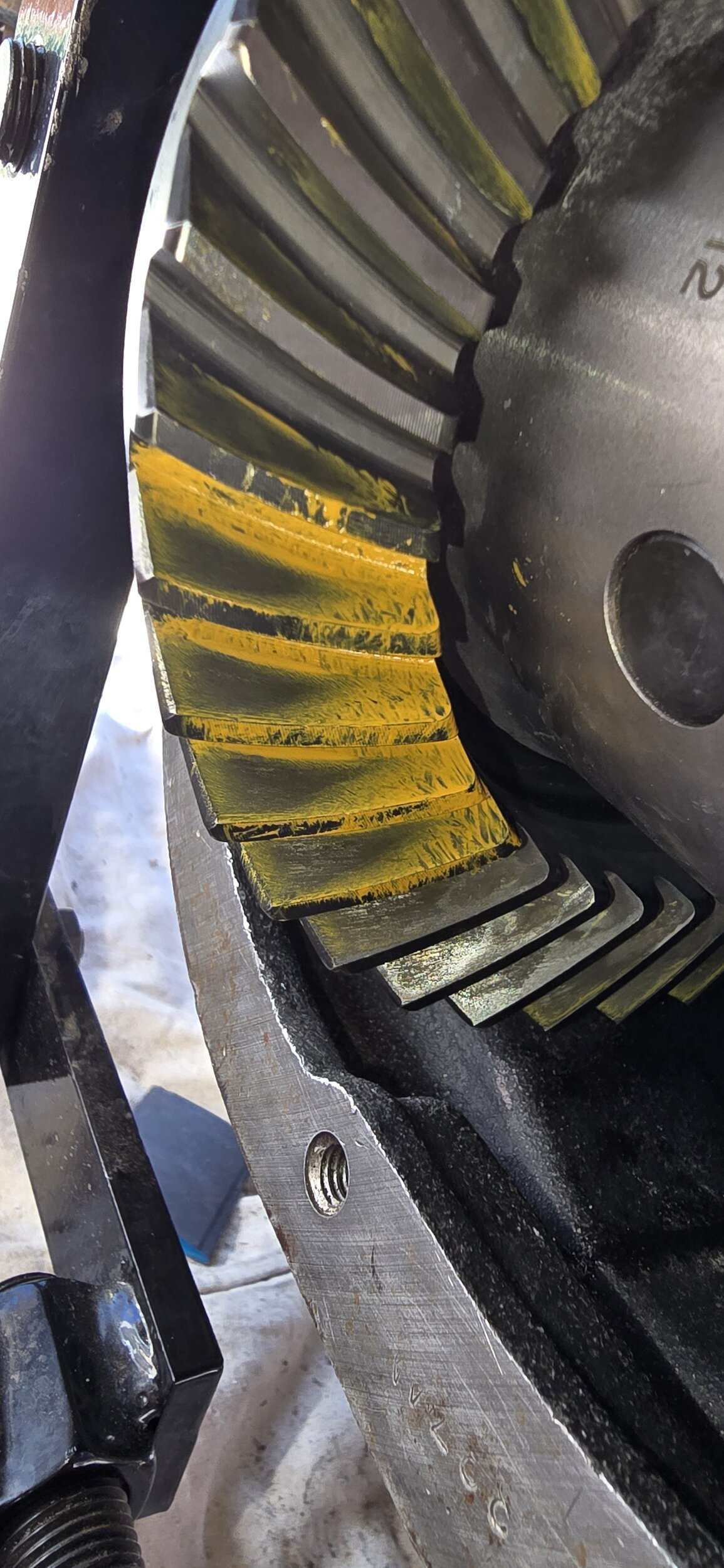

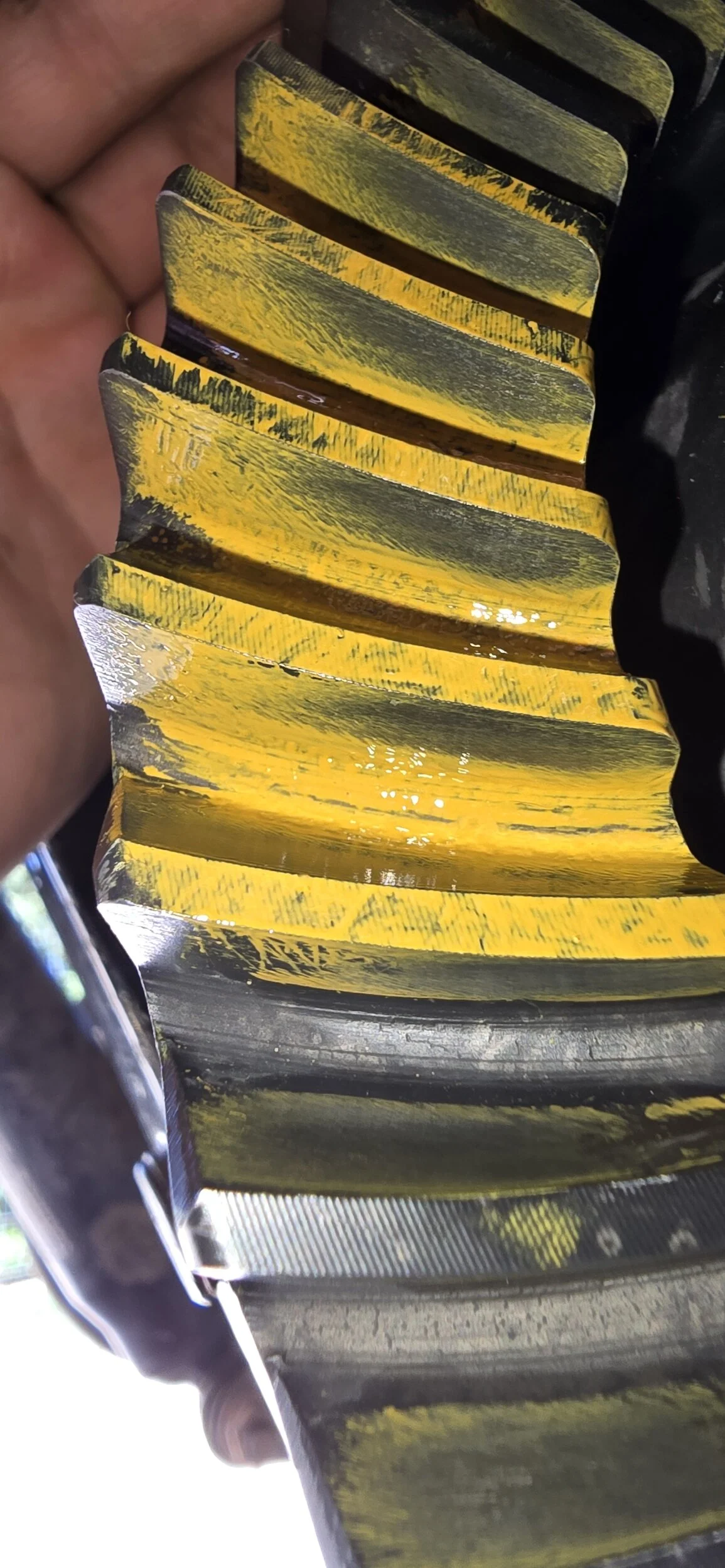

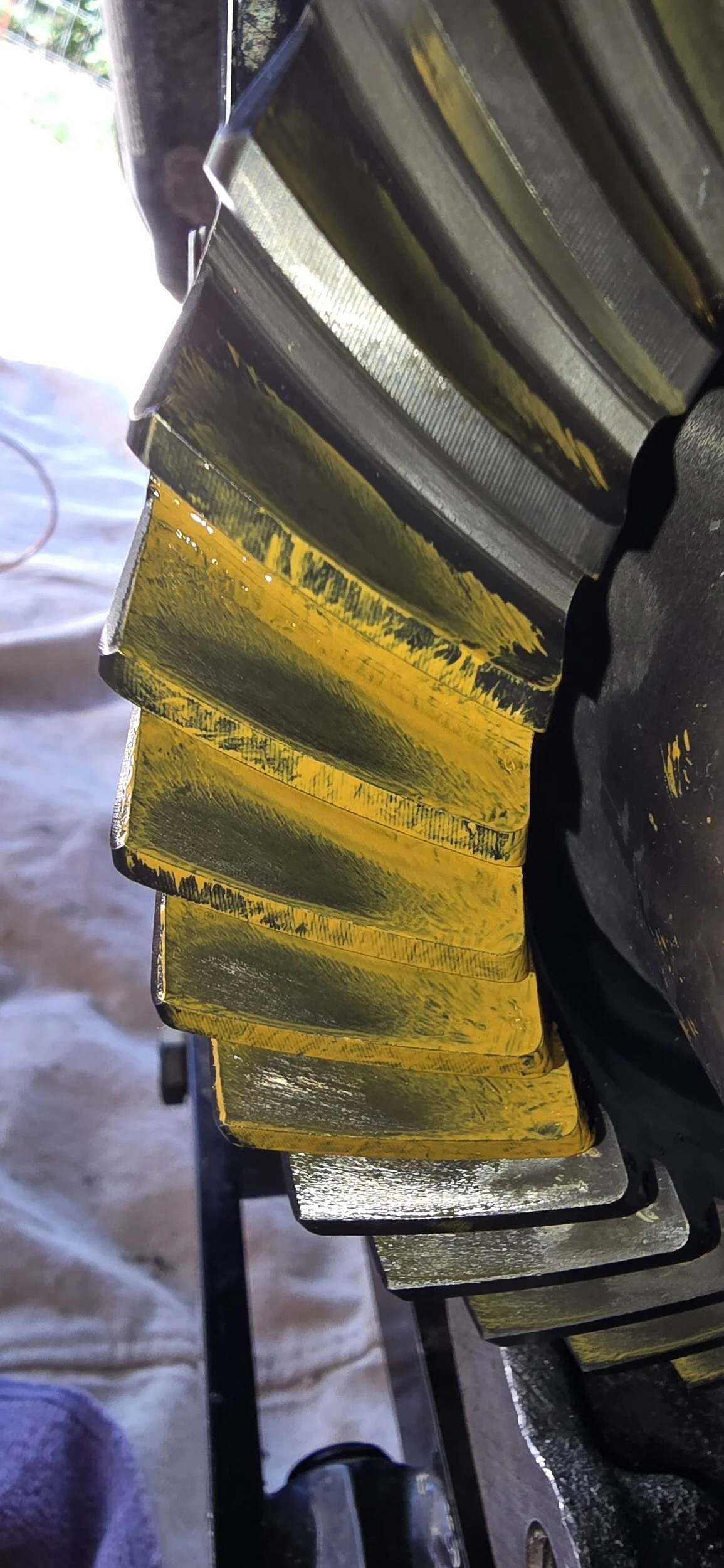

You are in the ballpark and have a good bracket to with with. Use less compound. The buildup at the root hides the bottom side of the pattern. Everything will look deep with the build up. Just enough to turn them yellow.
If I had to guess, I'd say your sweet spot will be 17-18
