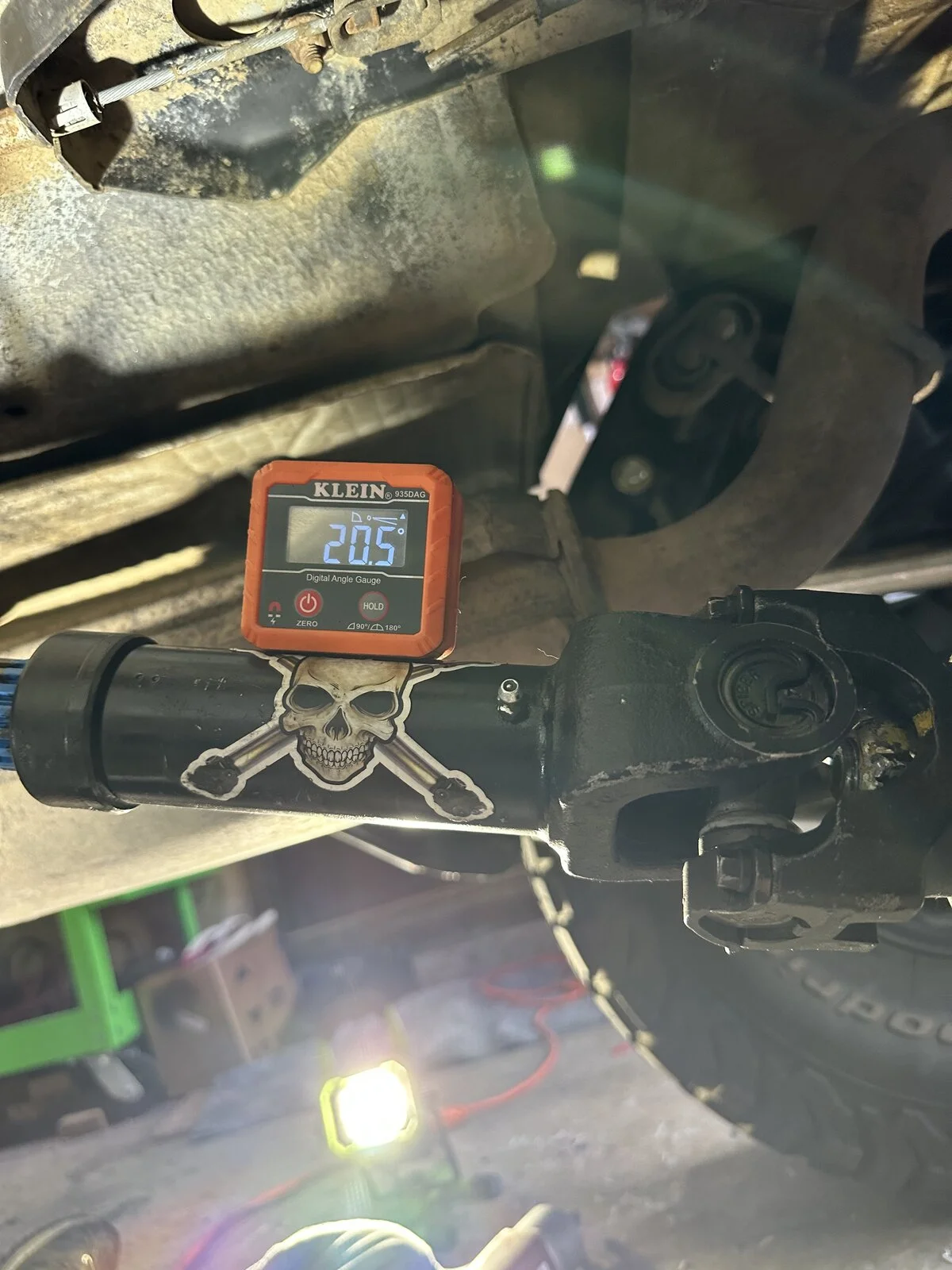

Installed sssye and adams d/c driveshaft a few months ago no problem no vibes. Put in a ucf ultra high clearance belly pan a couple weeks ago and started getting vibrations around 30-40 mph my driveshaft and pinion angle were about 3 degrees different….increased my pinion angle to about one and a half degrees lower now I get very slight vibrations at 50-55 mph. Am I too close to even and need to drop pinion a little…Any ideas?

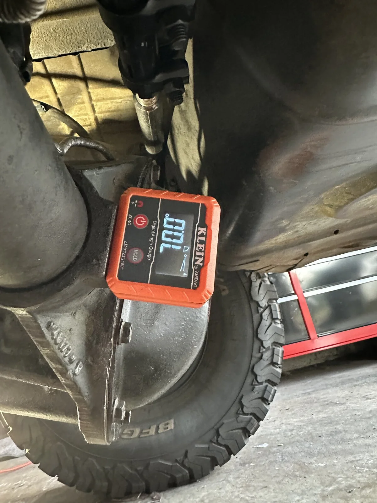

So basically put the angle finder on the underside of the housing? I can’t really see in your picture
Same spot on the back of the diff, just rotate the digital level until it reads 20-ish°.
You could try tilting the pinion up 1/2 degree, or down 1/2 degree, and take a test drive. Each Jeep reacts a little differently.
Rotate the angle finder on the back of the axle housing 90 degrees so it's reading the pinion angle and not housing angle. Doing that makes it easier to compare the pinion angle to the driveshaft angle.
yeah moved it up a degree vibe’s don’t seem to be there anymore
