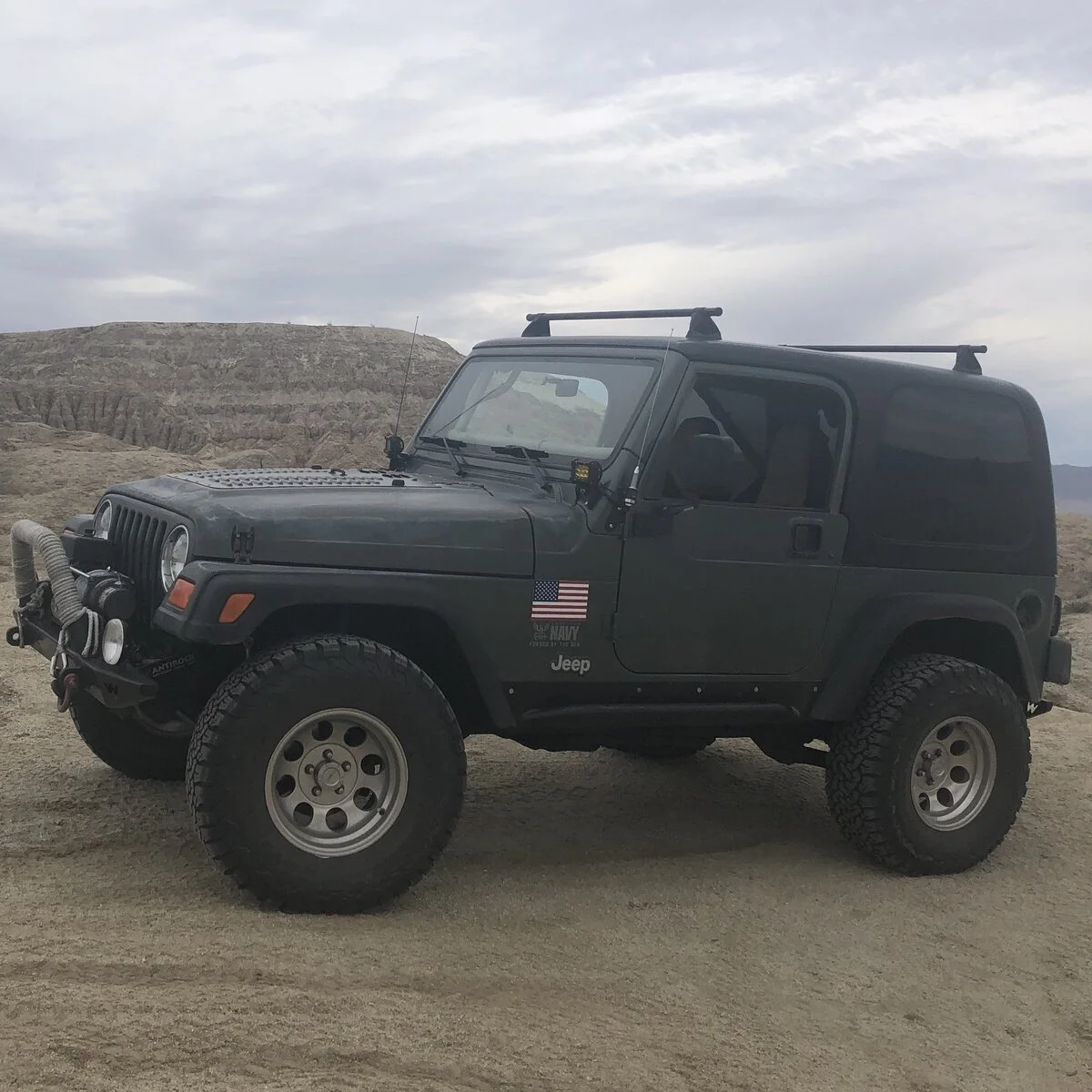

Here’s the most current photo I have of my Jeep

Here’s the most current photo I have of my Jeep View attachment 180913
looks like you've got a great base to start your build with 🍻
