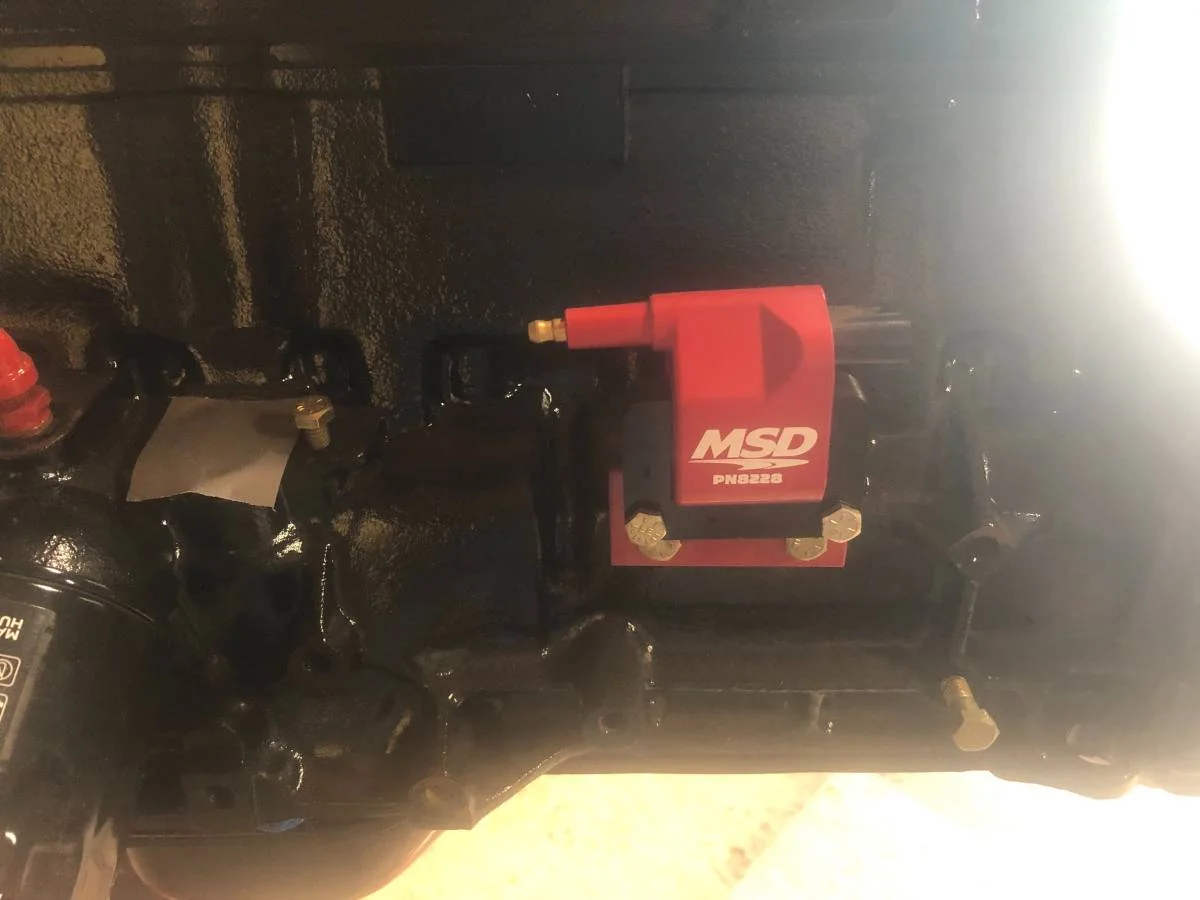

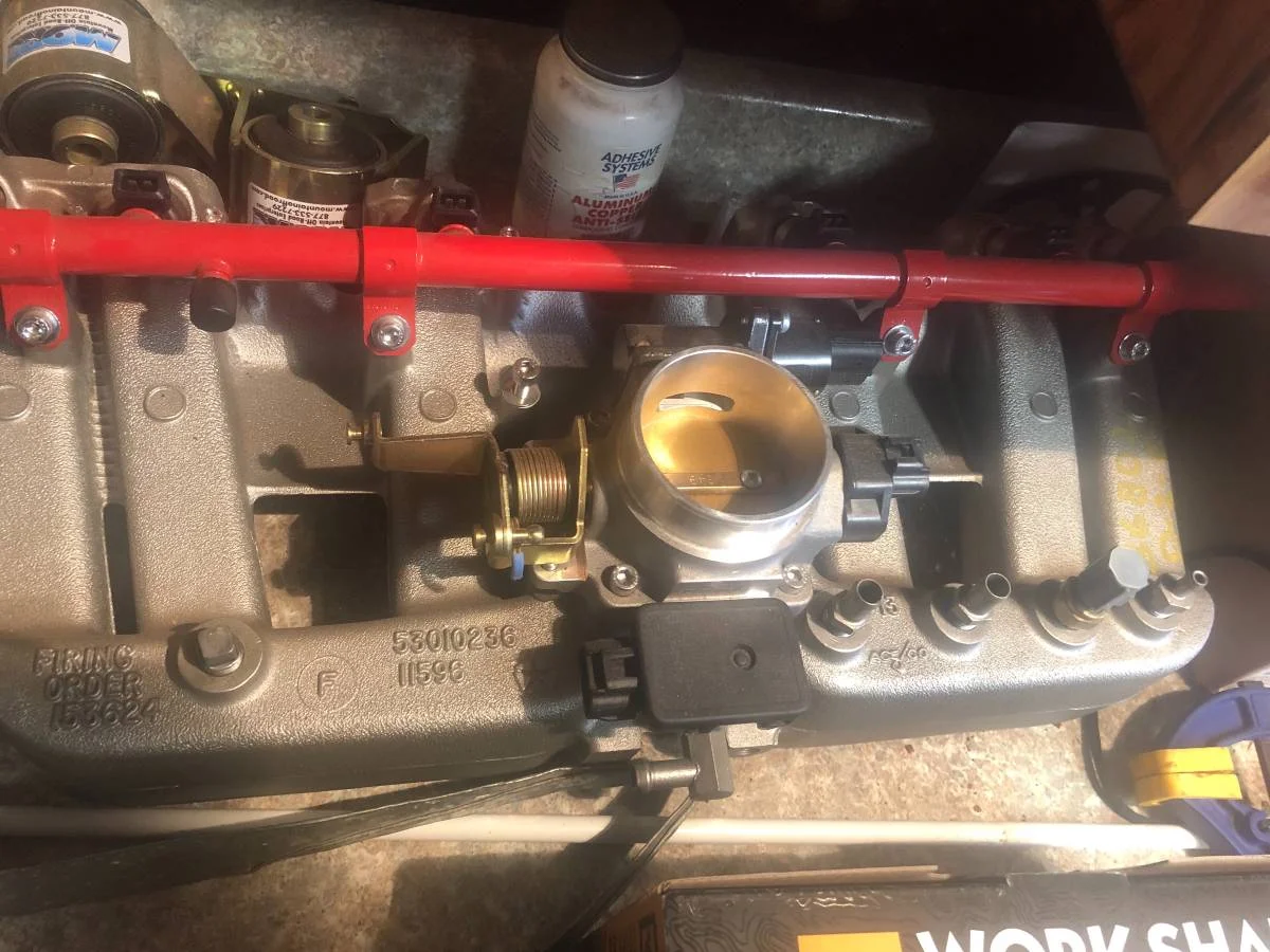

I had Golen engines build a 4.6 liter stroker for my 97-99 Jeep TJ. Circumstances changed and I am not able to use it.
I added an MSD ignition coil, (Jeep specific) high flow water pump, 97 intake manifold, powder coated fuel injector rail, new hi flow injectors, all new sensors at every point.

I think it would still work, wouldn't it? 97-98 had the distributor I believe, but 99 changed to coil packs (I think).

Different head. I don't see the casting bosses for the coil rail. Besides, I'm not going to pony up 6K on an engine that I can't hear run, just because some nut on Craigslist says its new! I'd build a stroker before I bought one, unless its one that needs a rebuild. Too much that can be wrong and that you won't know until its already in the Jeep and ready to go.

I talked to Golen Engines and they said everything will need to be changed to make it work on my 2004. In the future, I may go with their engines purely due to their customer service. They didn't care if I bought one of theirs, or used, or even found one in a junkyard. The guy I talked to just wanted me to have something that worked good for me.
The 99 still has a single ignition coil. That engine needs at least a 62 mm throttle body, cool air intake, header and a 4 core radiator with a 180 thermostat. It won't otherwise overheat, but it will run hot enough to thin the oil and lower oil pressure. Also, what was done to the head and which camshaft does it have? Mine had to have Chevy 1.50 and 1.94 valves with a much heavier spring to accommodate a mildly aggressive Comp cam. The ECM can handle the changes as long as you keep the restrictive exhaust and don't mind the 4,200 rpm rev limiter to go with a 6,000 rpm red line.
