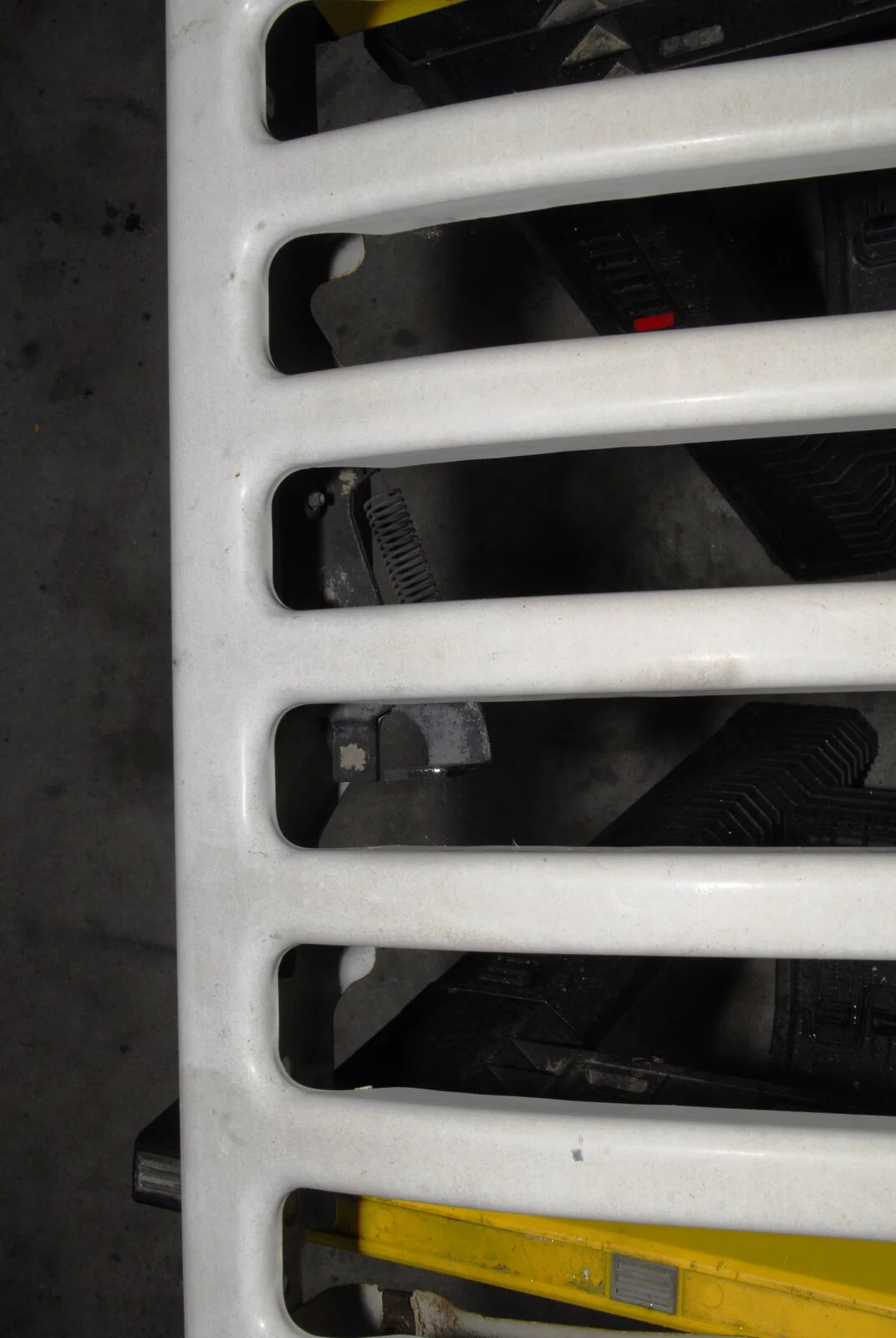

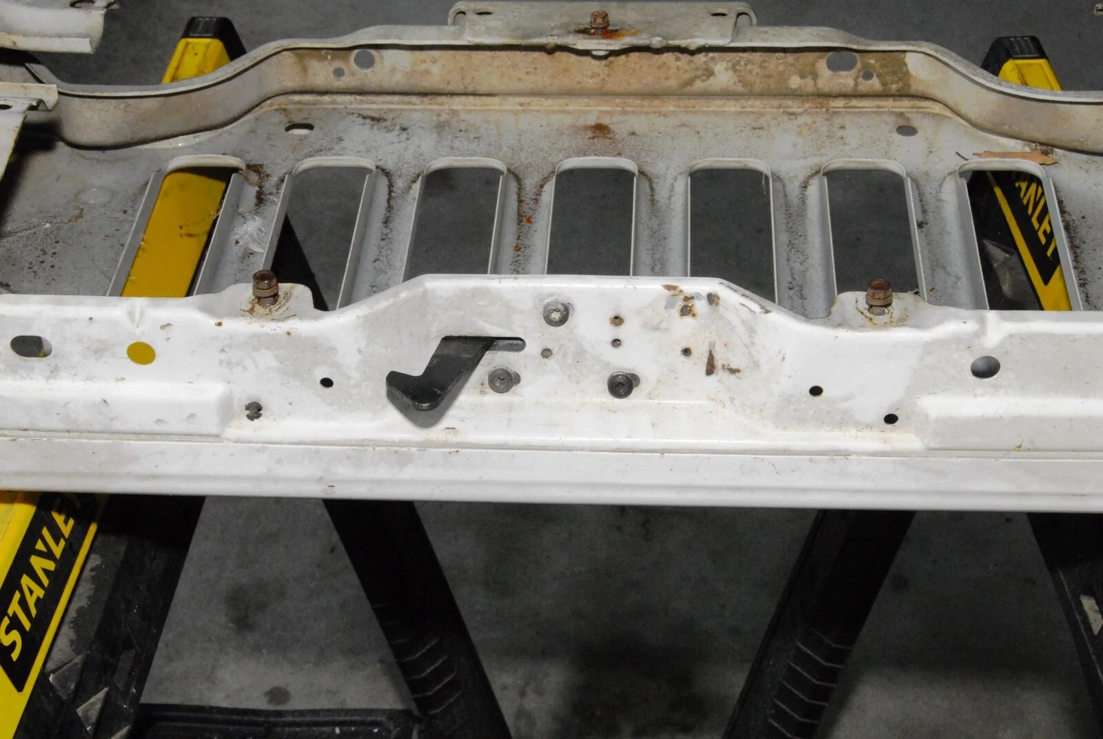

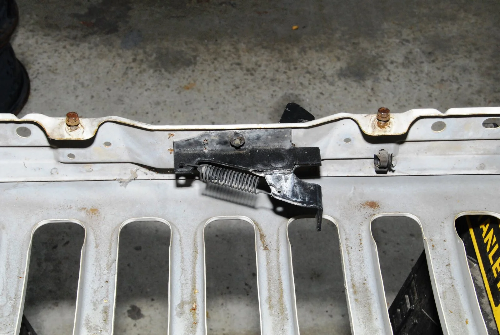

There are only two grill options. Both were available on the 97. After 97, they are all the same. The difference is the latch or safety latch. Early 97 you reach in the grill and push it to the side, later you lift the hood and lift the release handle which moves the latch forward.
Which do you have?
I have a little lever where I reach between the grille slots and pull it forward to release the hood.
That is the early one. Like the one below I just took pics of.

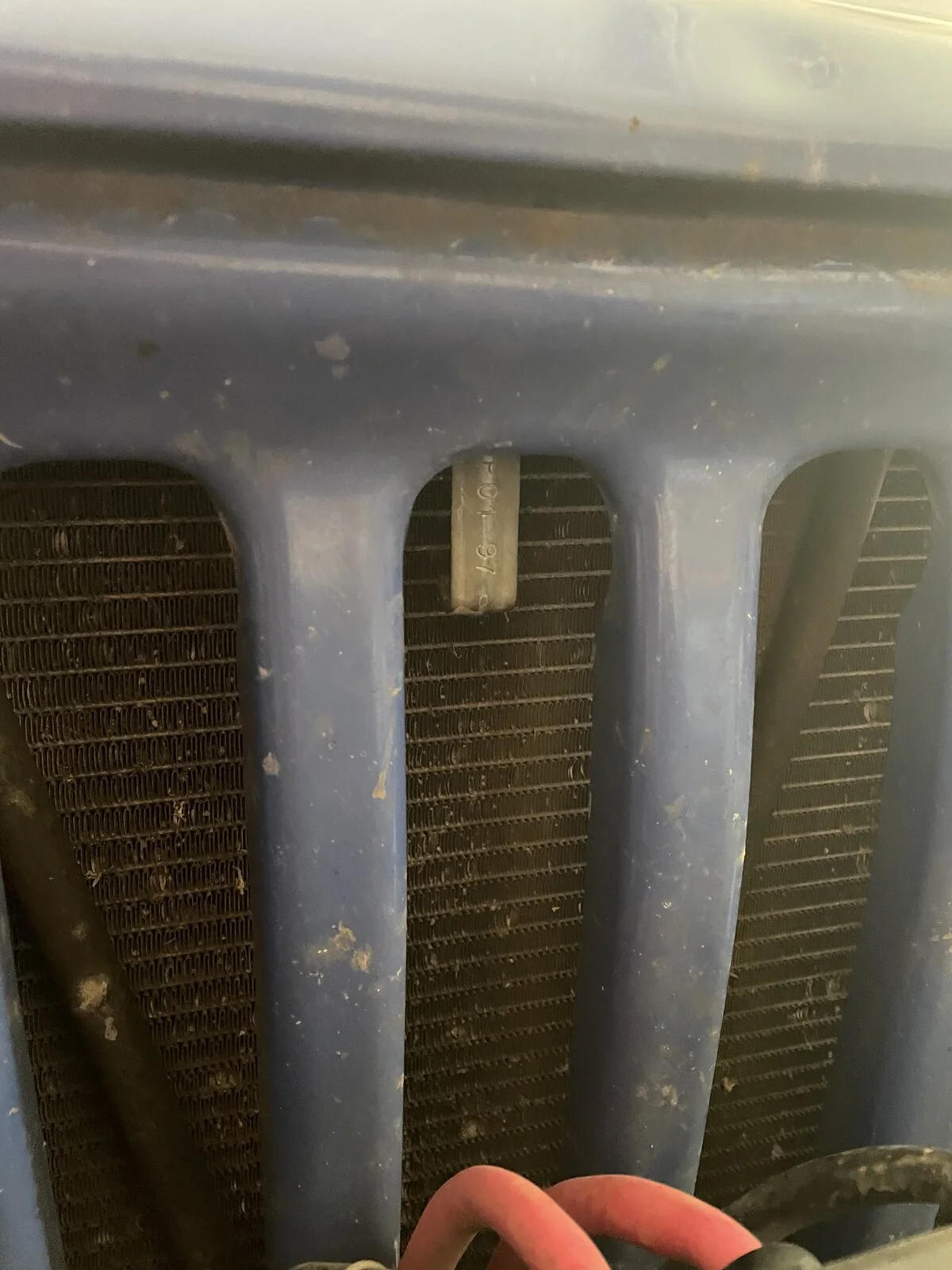

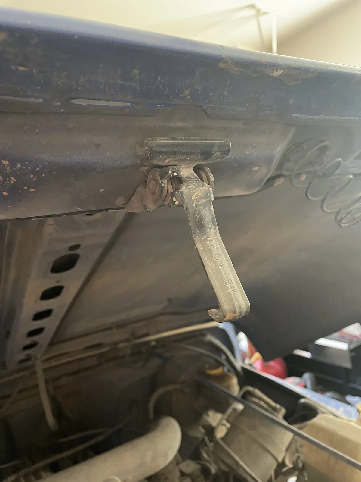

I may have not described mine very well. The latch mechanism is actually on the hood, and I have to pull it slightly forward to release.
You did not explain it well because you haven't figured out what that little finger tab that I circled is for. You stick your fingers in the gap between hood and grill, mash that tab against the hood and it swings the lower end forward to clear the slot in the top of the grill. That is also the later 97-06 grill for which the 99 you have located will be a direct swap.
