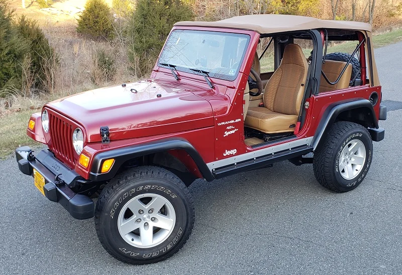

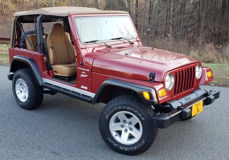

Ahhh... here they are. The first is before the H&R springs. The hard top drops the rear a little over the soft top.
