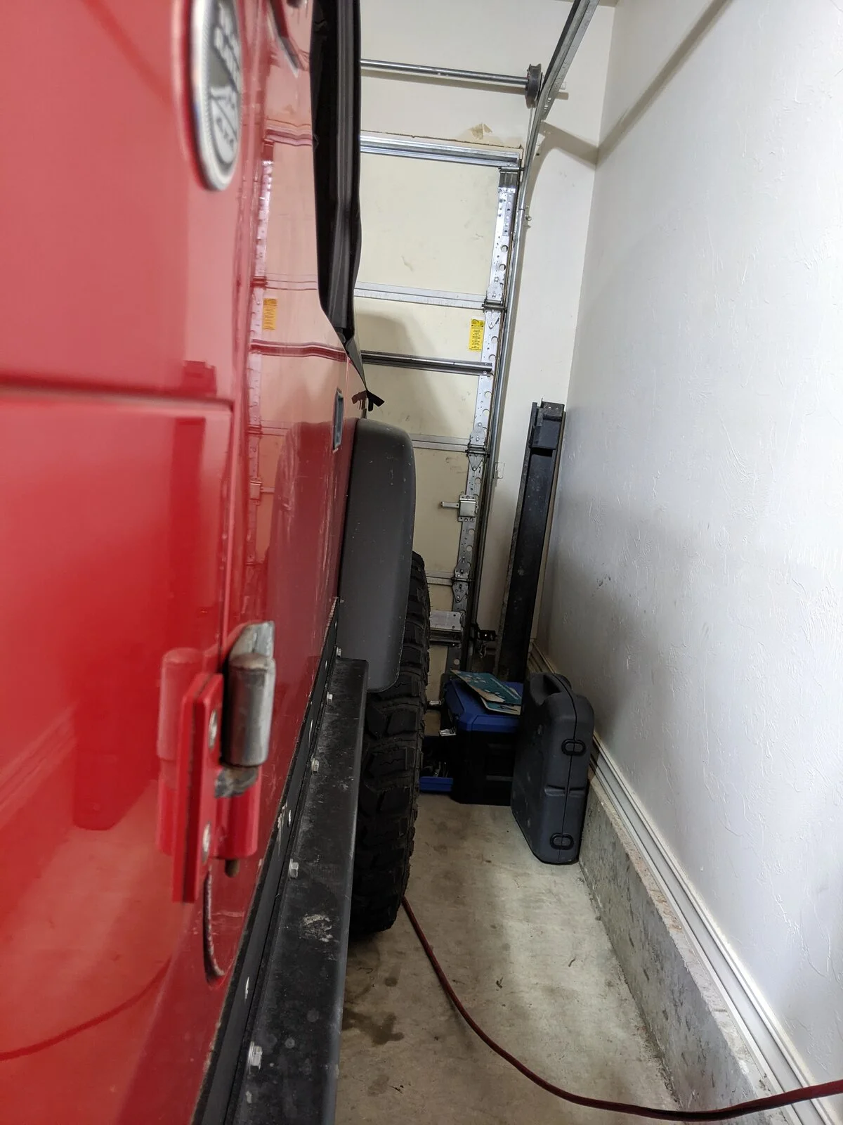

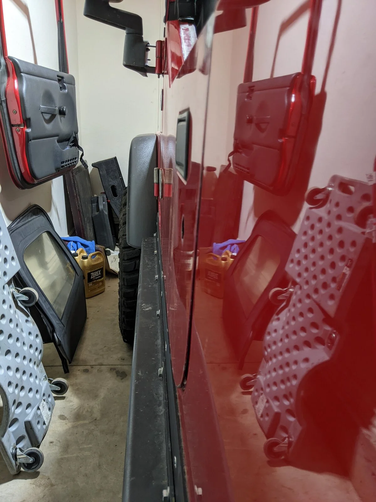

I can get the gaps even and things mostly lined up but there's not an obvious way to adjust for the door sticking out at the bottom but not the top. I can pull the striker farther in, but then it'll just pull the top of the door in past the outside of the tub.
It's present at front and rear, but front isn't as bad.

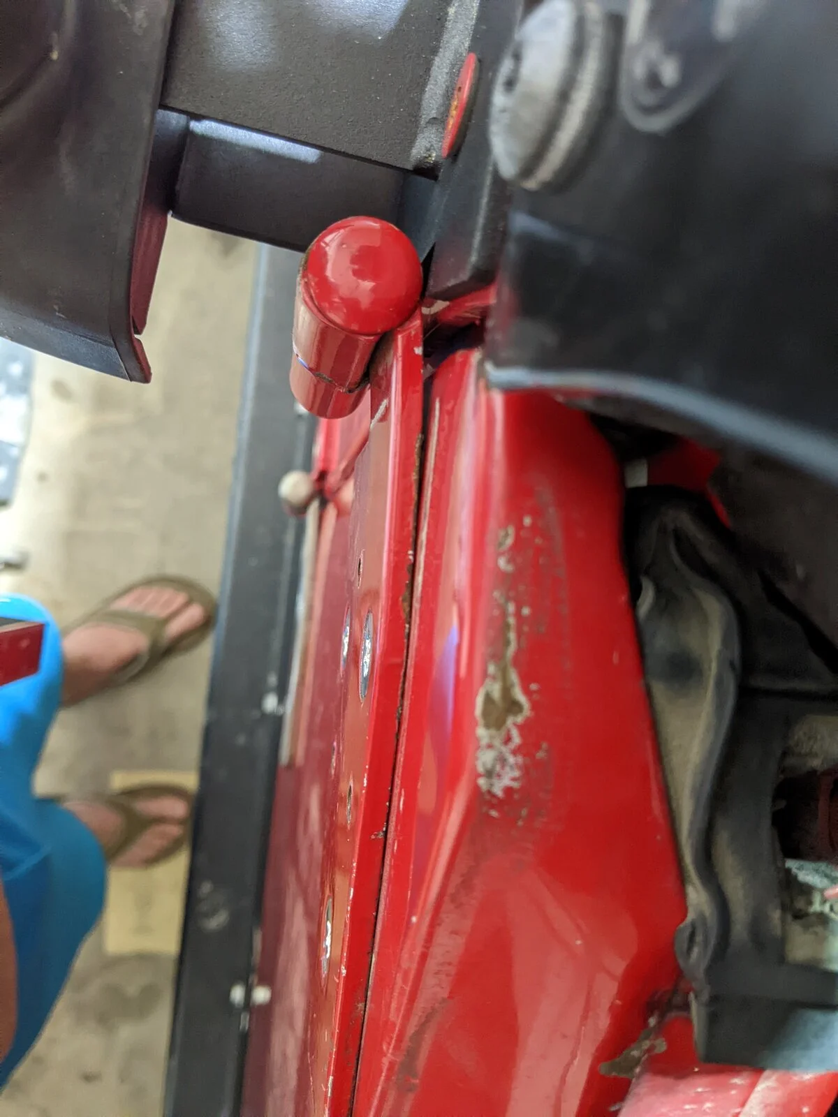

I'm using used OEM hinges from multiple sources so it's entirely possible the lower hinge is deformed. I hate the way they're all bent because it's so difficult to tell if it's bent the right amount.
This is the bottom hinge, which is actually a top hinge but I welded the mirror holes shut.

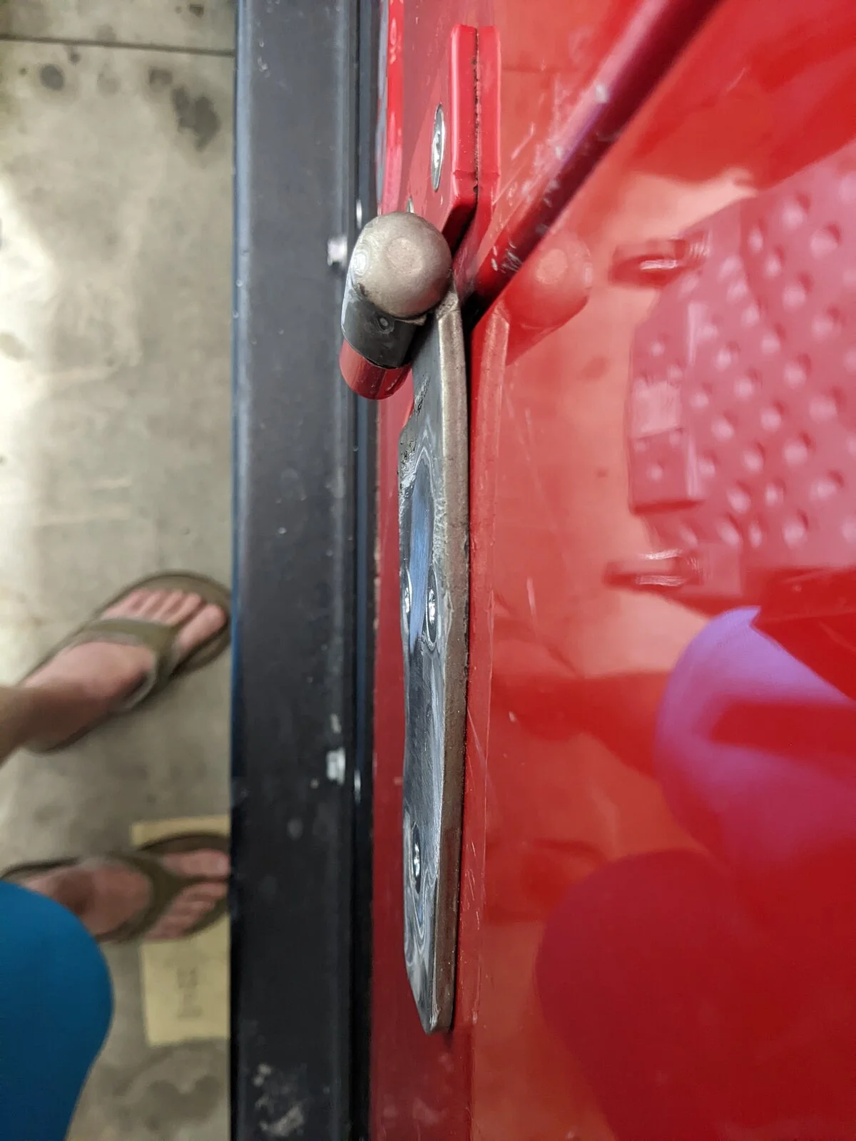

This is the top hinge, same door.
and this is a bottom hinge on my full door.
It does look like the khaki bottom hinge might have slightly less space between it and the door shell, so maybe that's my issue.
