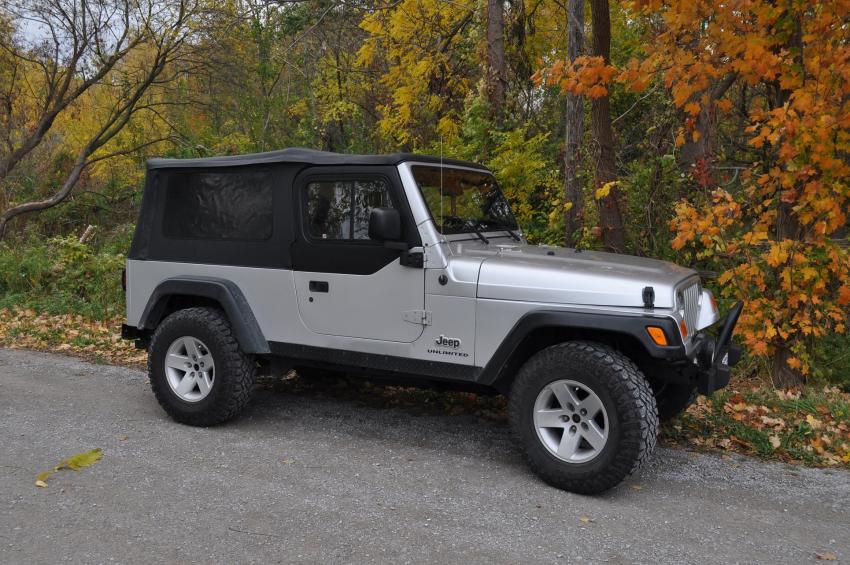

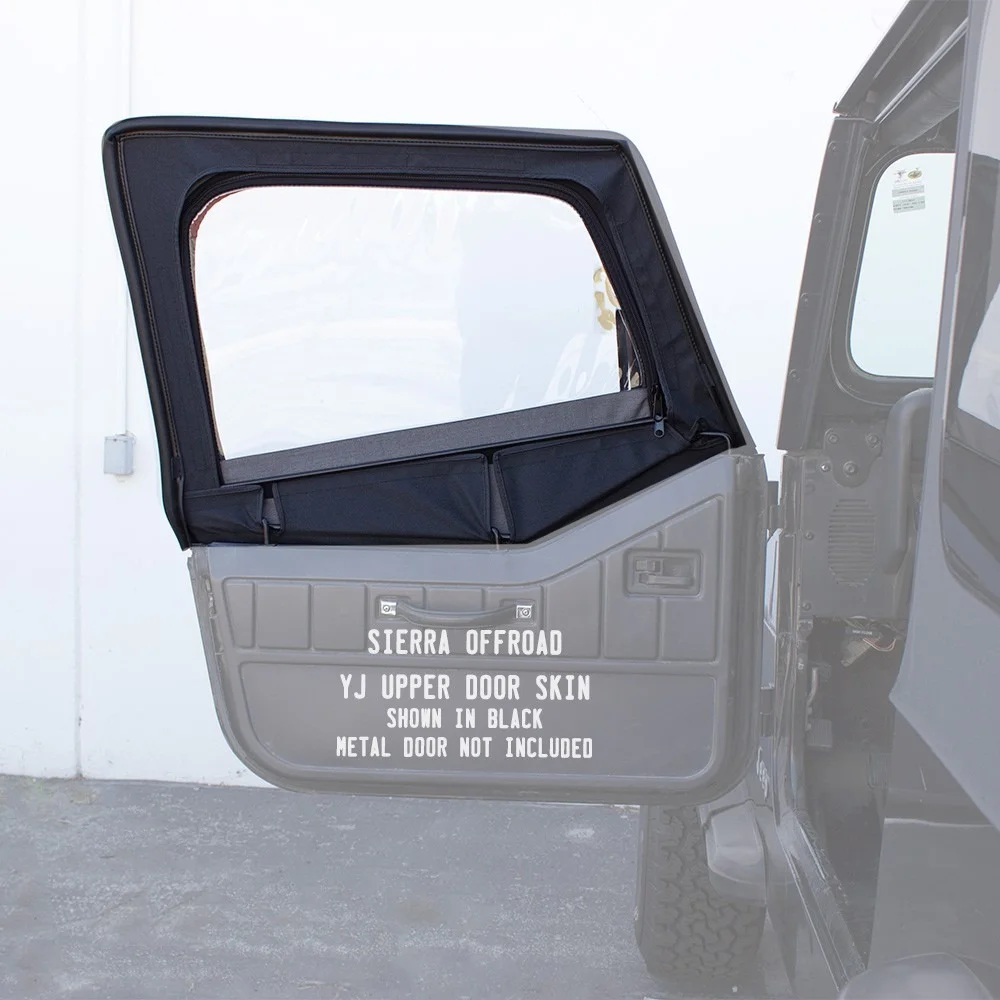

Here's an after market upper door for a YJ. Please note the top "squared off" outside corner of the door.

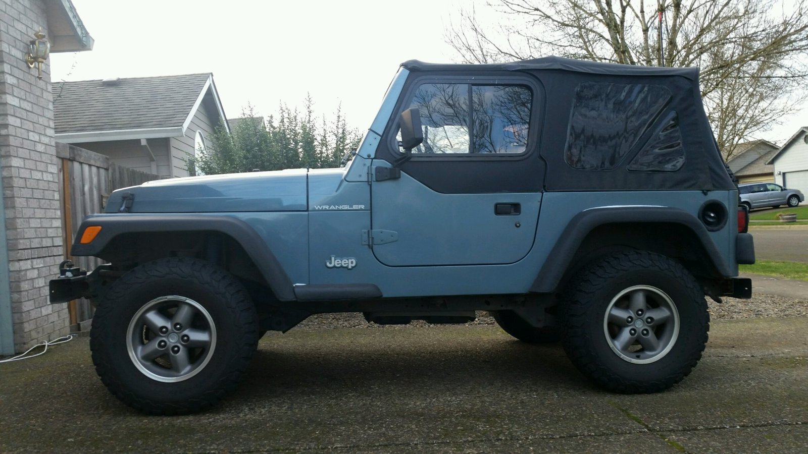

Here's an after market upper for a TJ (same manufacturer). Notice the "rounded" upper corner of the door.

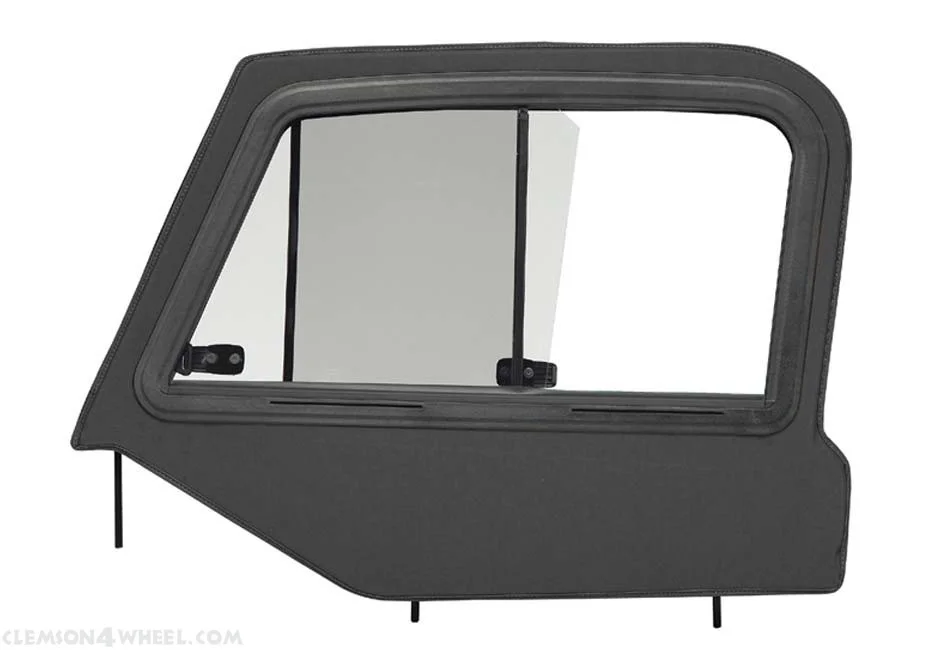

Like @Chris said, I think you are better off trying to find a TJ upper if you can. I have the Best top sliders shown below which I love. The funny thing about this last picture is that it is labeled a best top slider tj-yj from Clemson4wheel.com. so maybe it does actually fit both.

There you have it... Based off what I'm seeing visually, the difference between a TJ and YJ soft upper is very obvious. The TJ has the rounded edge, whereas the YJs is more square.

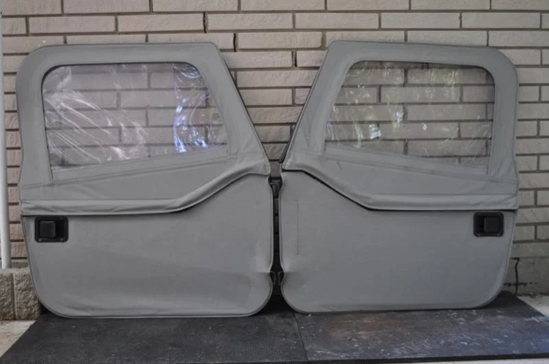

Thanks for the photos UpperMI. The first one clearly shows the YJ square corners. Here's a pic of my YJ soft doors with the later rounded top corners. The bottoms on their own fit fine with the TJ latches installed. You are right about the overall fit though. You can close them with the tops on but they don't seal. I drove around with them on and I think they might have blown out if I went any faster.

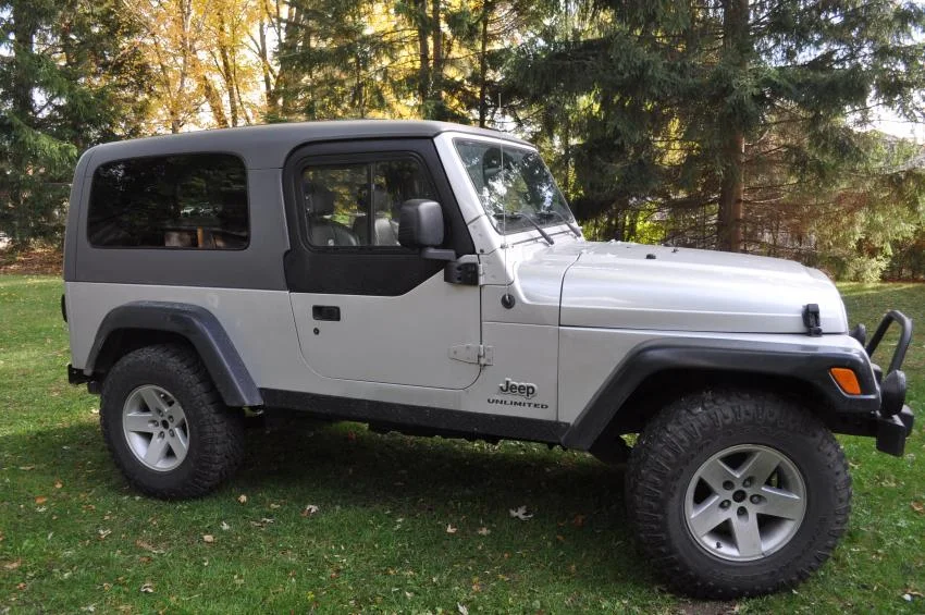

The upper sliders I have are a bit different to the Best Top ones posted above by UpperMI. Mine are hard fibreglass and I believe they were made by Black Hawk Industries (there was a small but vague sticker on the bottom of one of them). They were glossy black when I got them. I painted them inside and out with Duplicolor bed liner (the cheapest spray paint they have) in an effort to match them to my soft top. Although it's off a bit I'm happy with the results (it's hard to match plastic/fibreglass to vinyl). As you can see, my hard top is gray. I will be painting it to match in the spring when it warms up. I will likely go with Duplicolor again. If it's something else I will make sure everything matches.

I'll take a picture of mine when I get home and post it for you. How good it looks is different for every person.

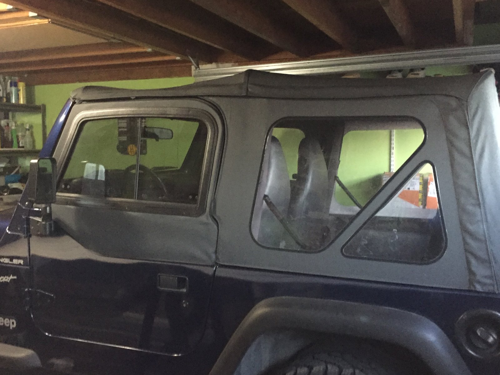

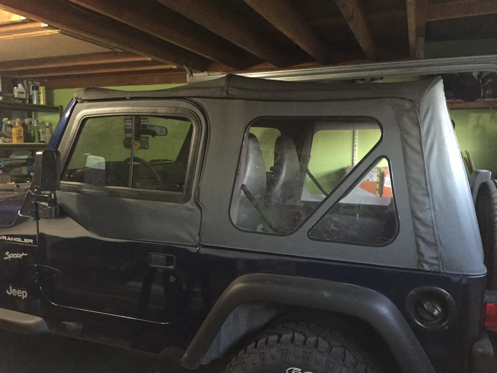

My jeep is an 02' as well so this is how the black denim looks. Sorry for the shot being from inside my garage but it was too dark by the time I got home tonight to take a picture outside.
