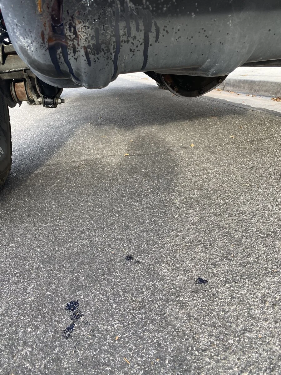

also I got home and I see dripping from the back what is that?
Assuming that leak in the rear is fuel, was there any provisions made for filler neck/tube when they did the lift? Have you checked to see if there is PS fluid in the pump?
Yeah it doesn’t look or smell like fuel smells like gear oil but I’m wondering how it got up there and why it’s dripping from up there. This shop does not seem to do clean work...
Dont be too surprised... like Fliver250 said, follow the breather tube. Also when my SYE seal blew I had fluid all over the bottom of my gas tank. Only located it by where the majority of the drips were in my garage.
Breather tube might be clogged or the diff overfilled.

ok so this is normal after a gear change then? nothing to worry about or have the shop do? still not sure why the power steering is so much harder to steer
No, not normal and not correct. The diff is probably overfilled. As stated, follow the vent line up from the axle housing and find out if we are correct.

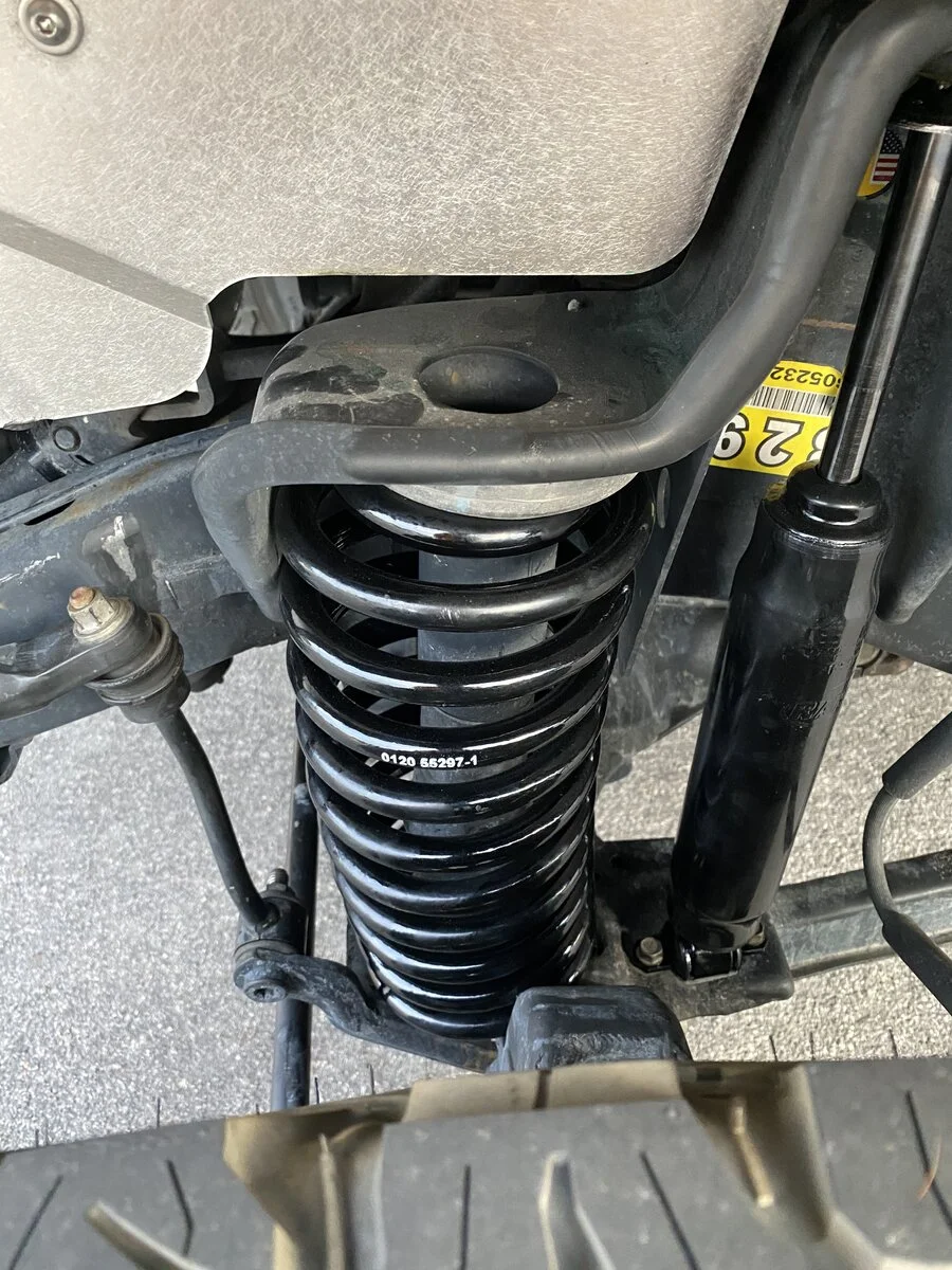

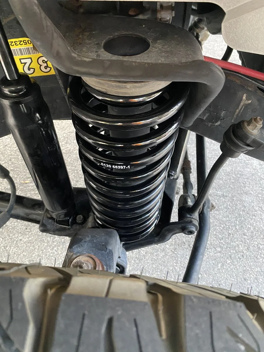

Thanks for the help! I’ll look into the vent hose and see if that is it it sounds right. I have one more questions about the springs. The driver side (first pic) is not centered like the passenger side. Is this an issue?
Very common issue. The spring company missed the inner diameter of the pigtail on top of the spring and it won't center on the isolator correctly. Your choices are to make a centering ring or get the springs warrantied.
Welp, there’s another thing I learned today...
