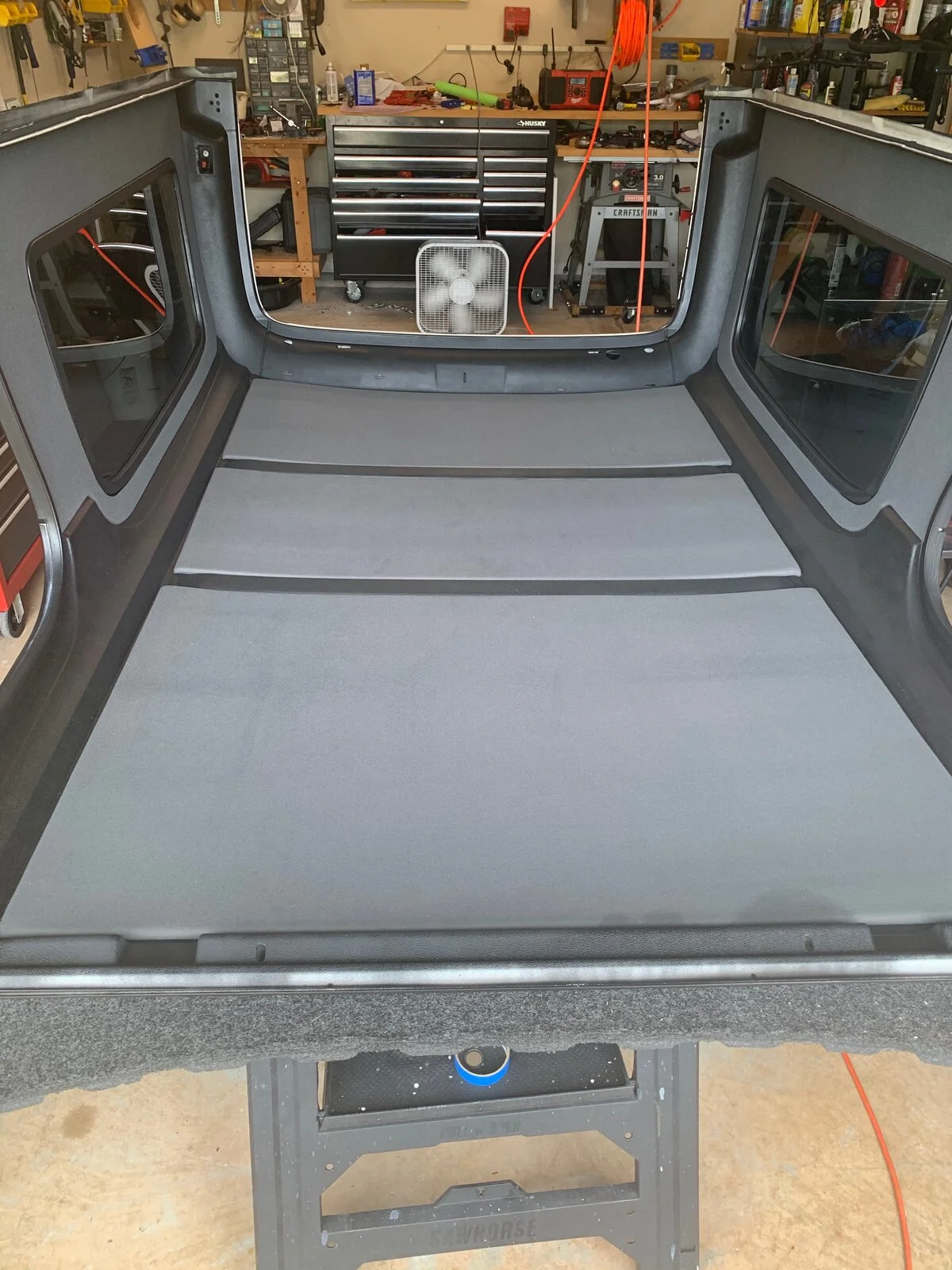

I used Design Engineering boom mat for my hardtop and it works great. Half the price of Hot tops.
Makes it really quiet and keeps it cooler in Fla heat.
The only thing I did was also use some 3m spray adhesive to help hold it in this heat. Just making double sure it stays up.

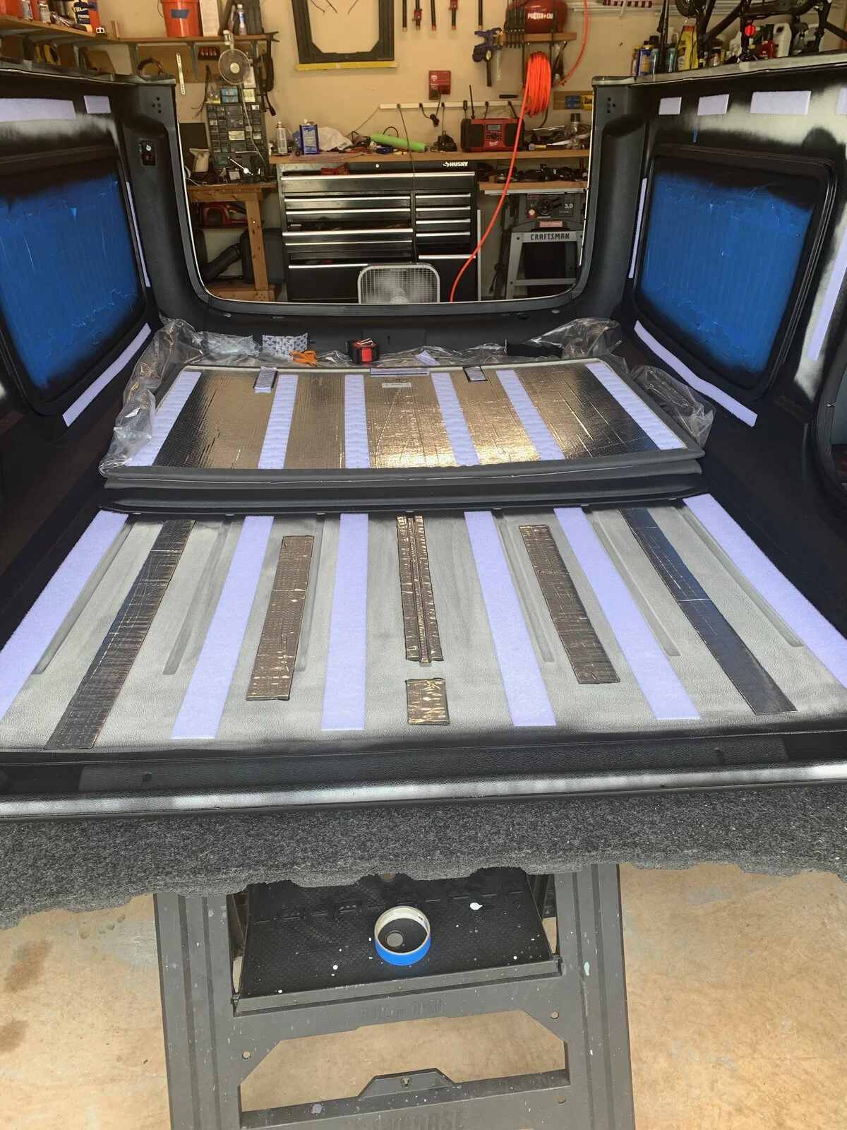

Here is what i did with my Hothead. They explained the sound deadening did not need to be everywhere to cut down on the vibrations.

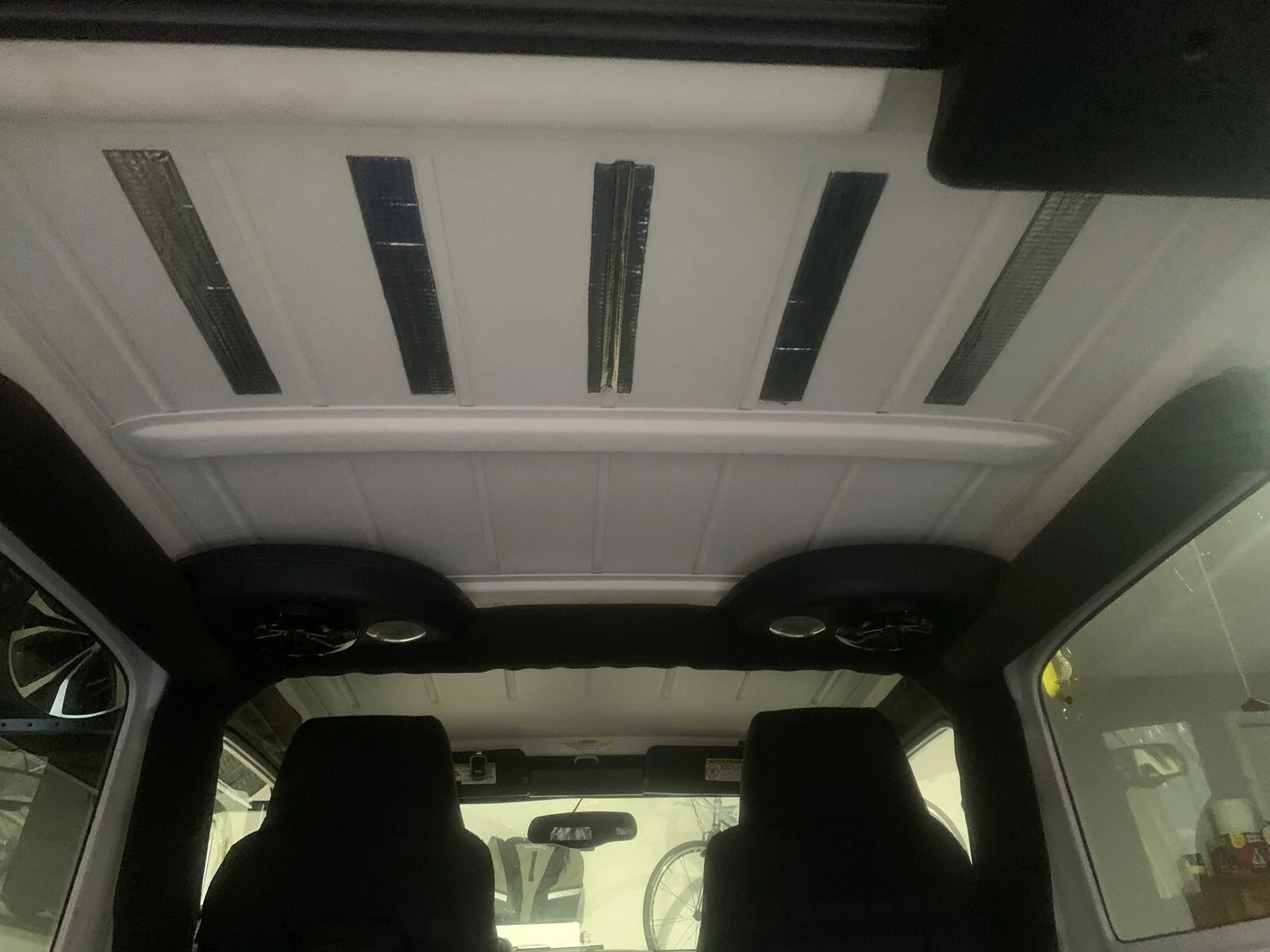

So I finished the install of the "Sound Assassin" and HotHeadz Headliner. The Sound Assassin is just basic sound deadening material, had I known that I would've used leftover I had from lining my whole tub last spring. What you see below is the Sound Assassin strips, I'll take another picture if the finished install. Overall, it's a lot quieter in the cab and there is barely any reverberation if ANY off the hard top now. Remember its a TJ/LJ so its not going to ride like a luxury vehicle and I can still hear highway wind noise slapping my windshield when I'm driving 60+ mph. But overall, I am pleased at the convenience of the package and everything included, as well as the outcome. My sound system sounds even better now! :)
