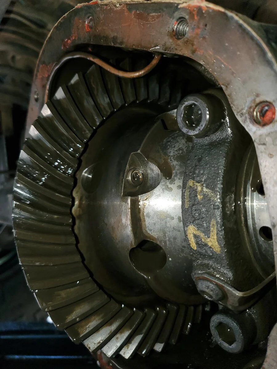

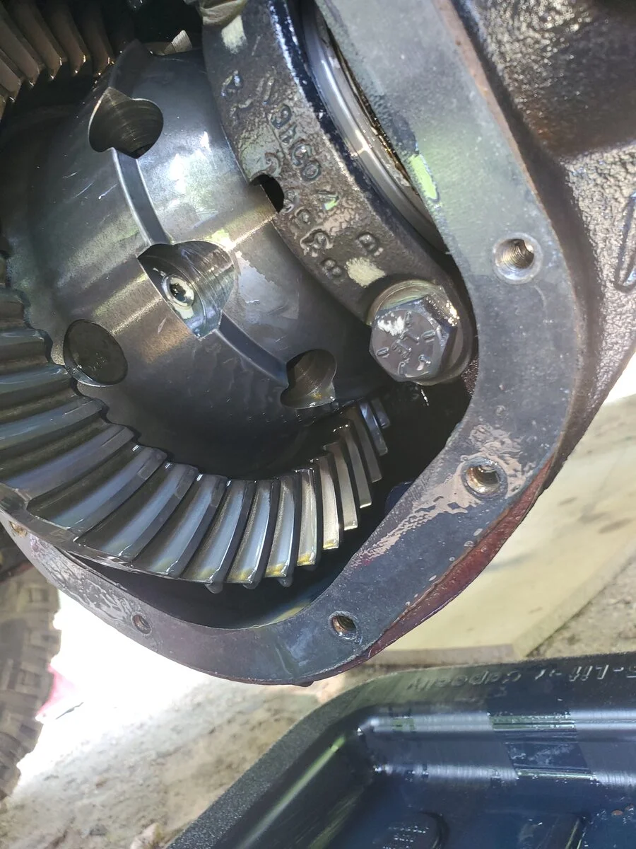

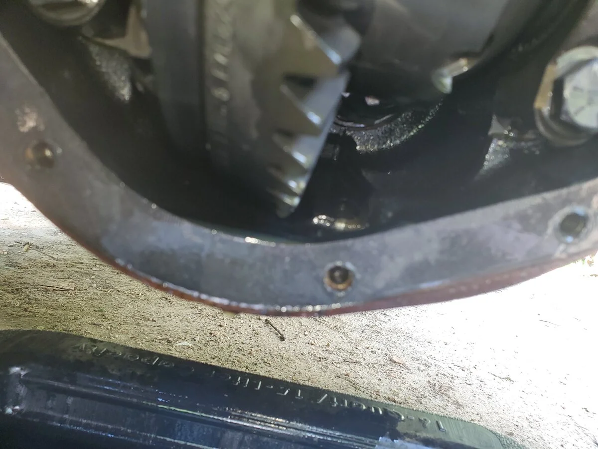

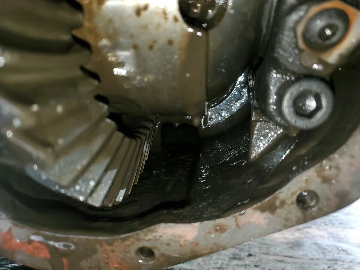

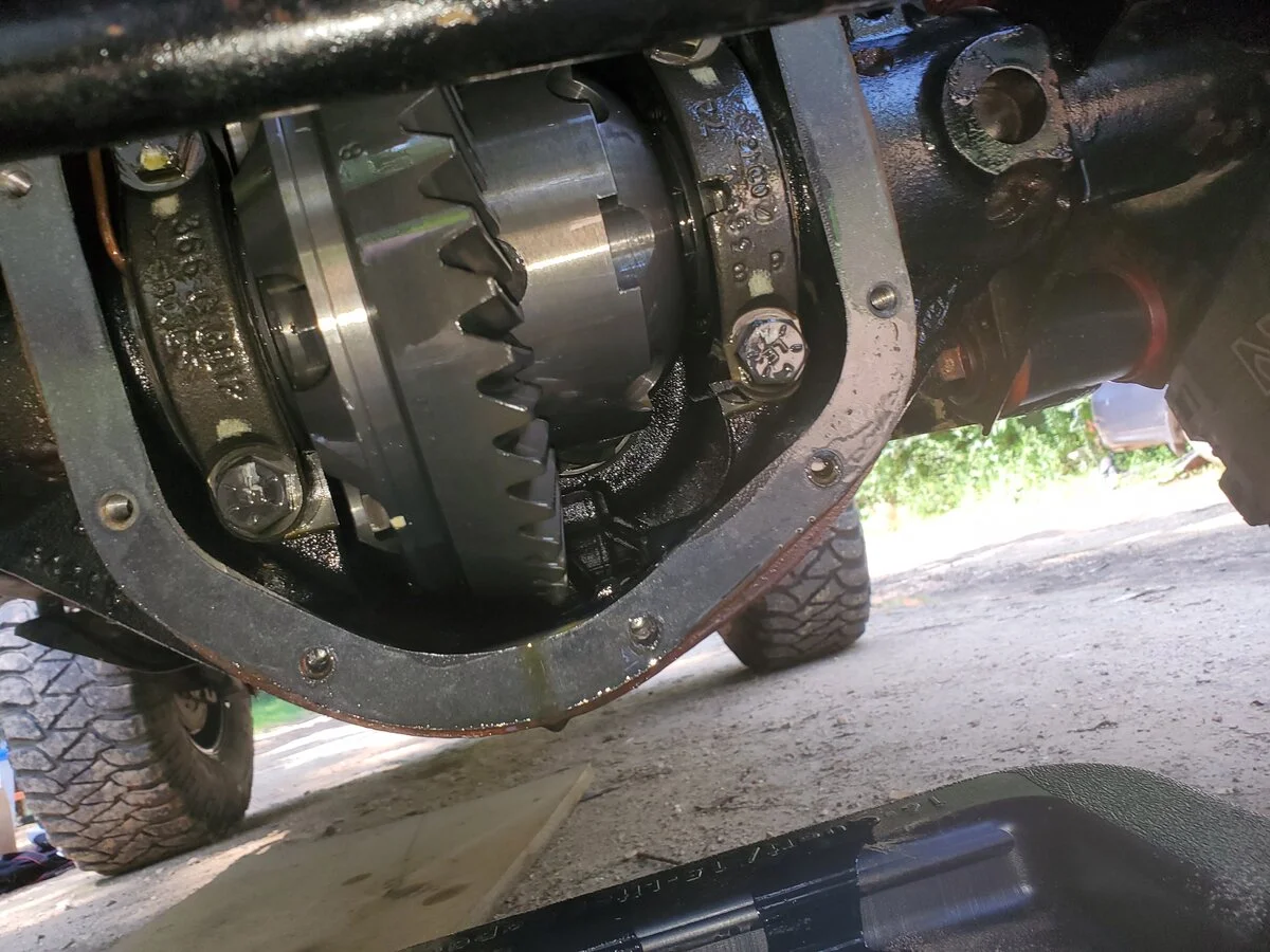

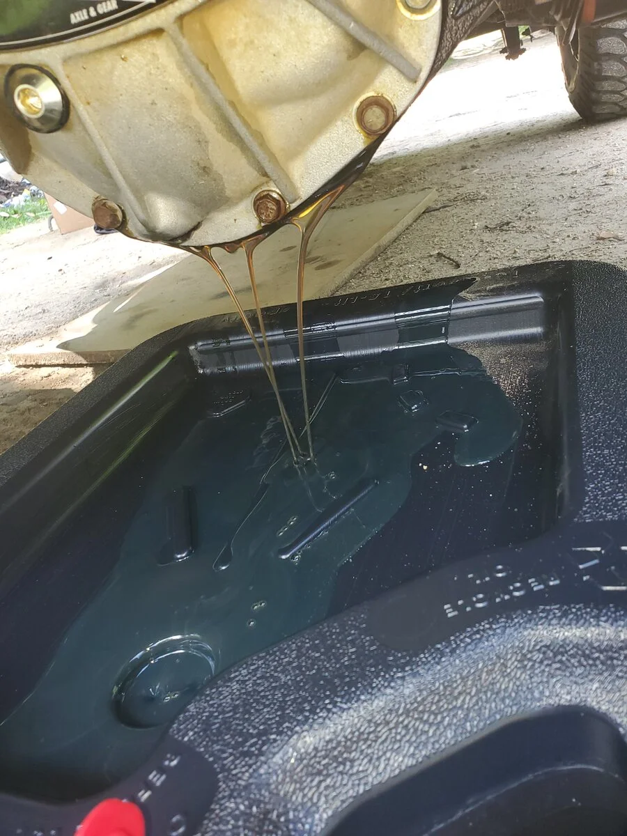

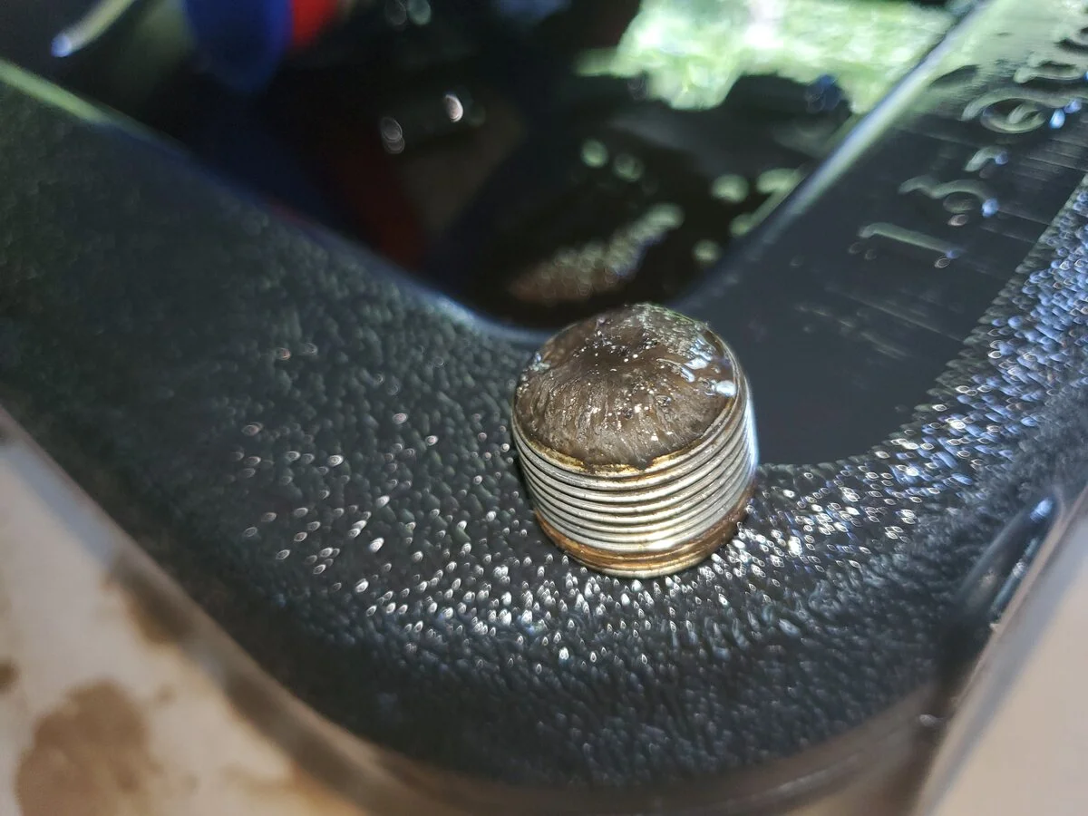

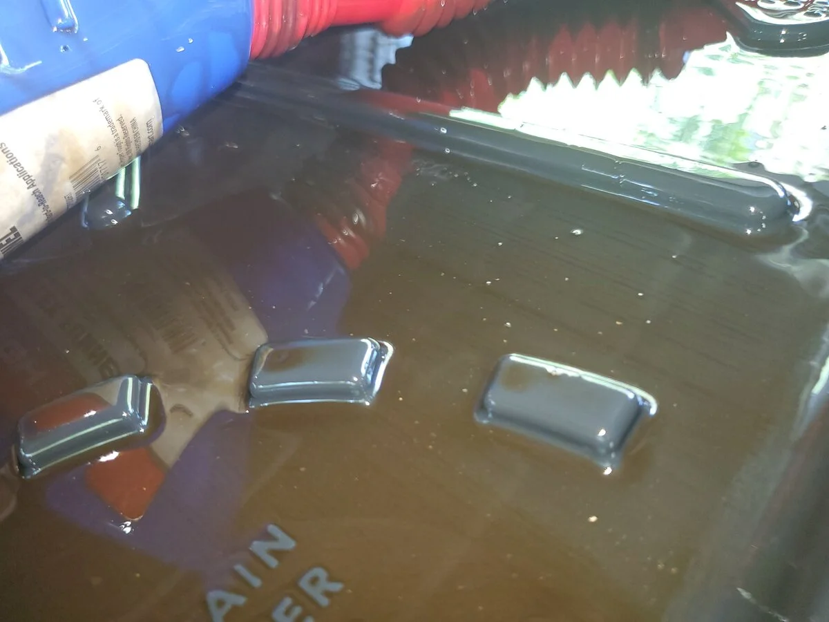

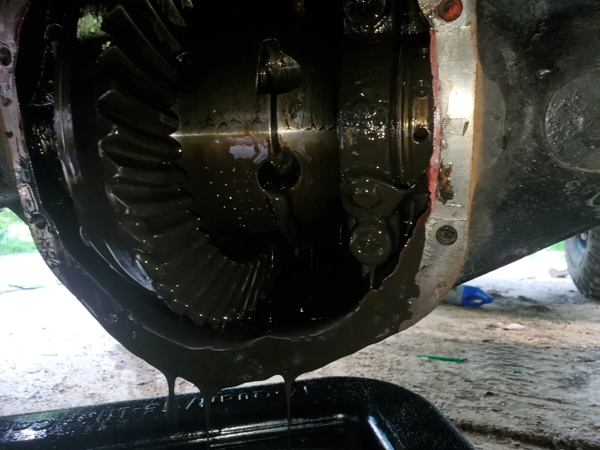

Okay so I've worked my way from the front to the rear. Here's some pics.
Front diff
Trans.
Transfer appeared to be normal for never having been serviced
Rear diff.....
I believe it was either the trans based on how many shaving was stuck on the plug. And now to the rear diff oil, I didn't know G2 axles made chocolate😂 I hope by deep cleaning the diffs and changing the fluid will help tremendously with this noise. If not im gonna narrow it down to a bearing somewhere.
