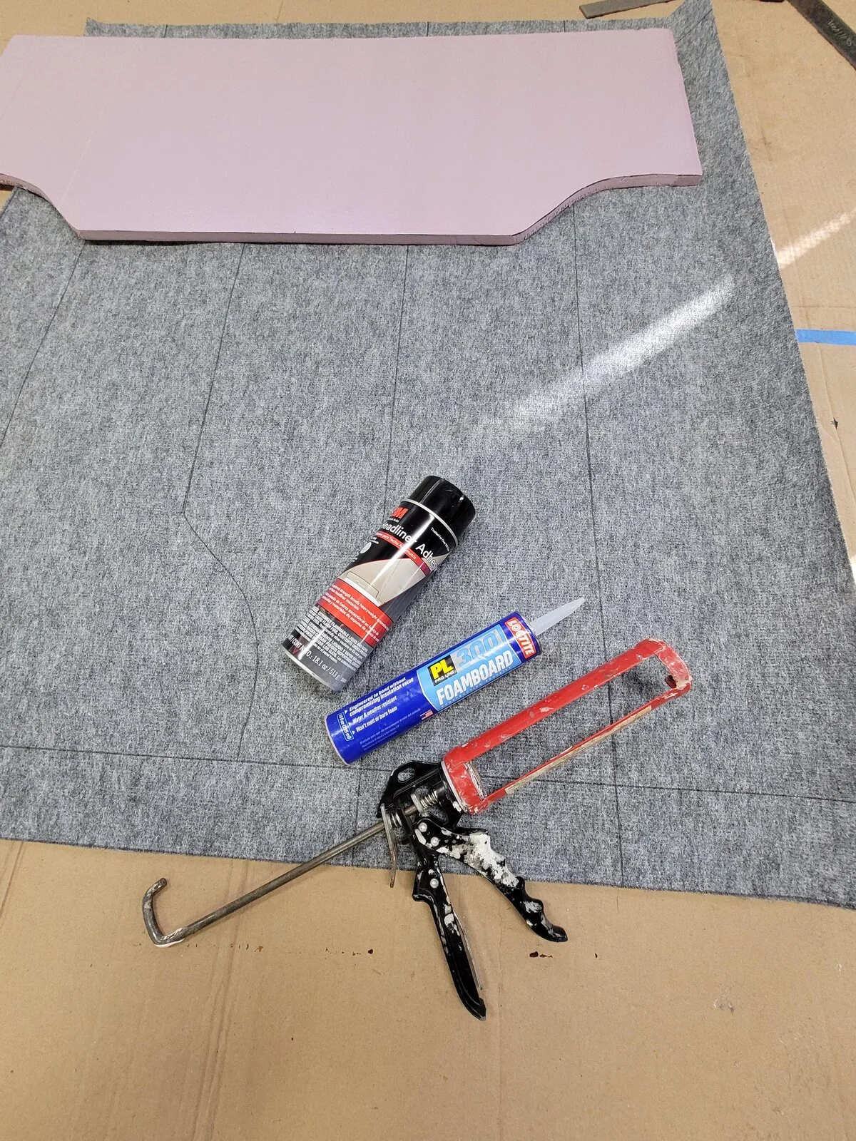

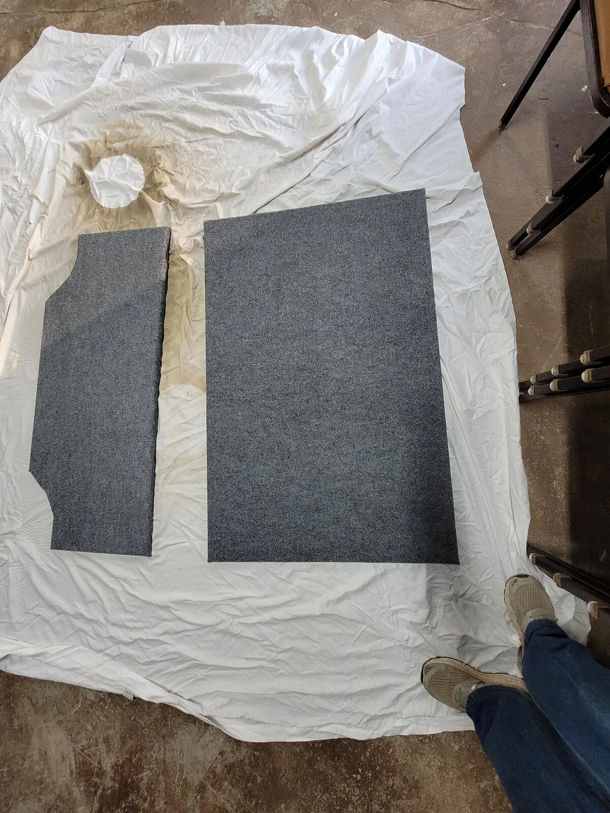

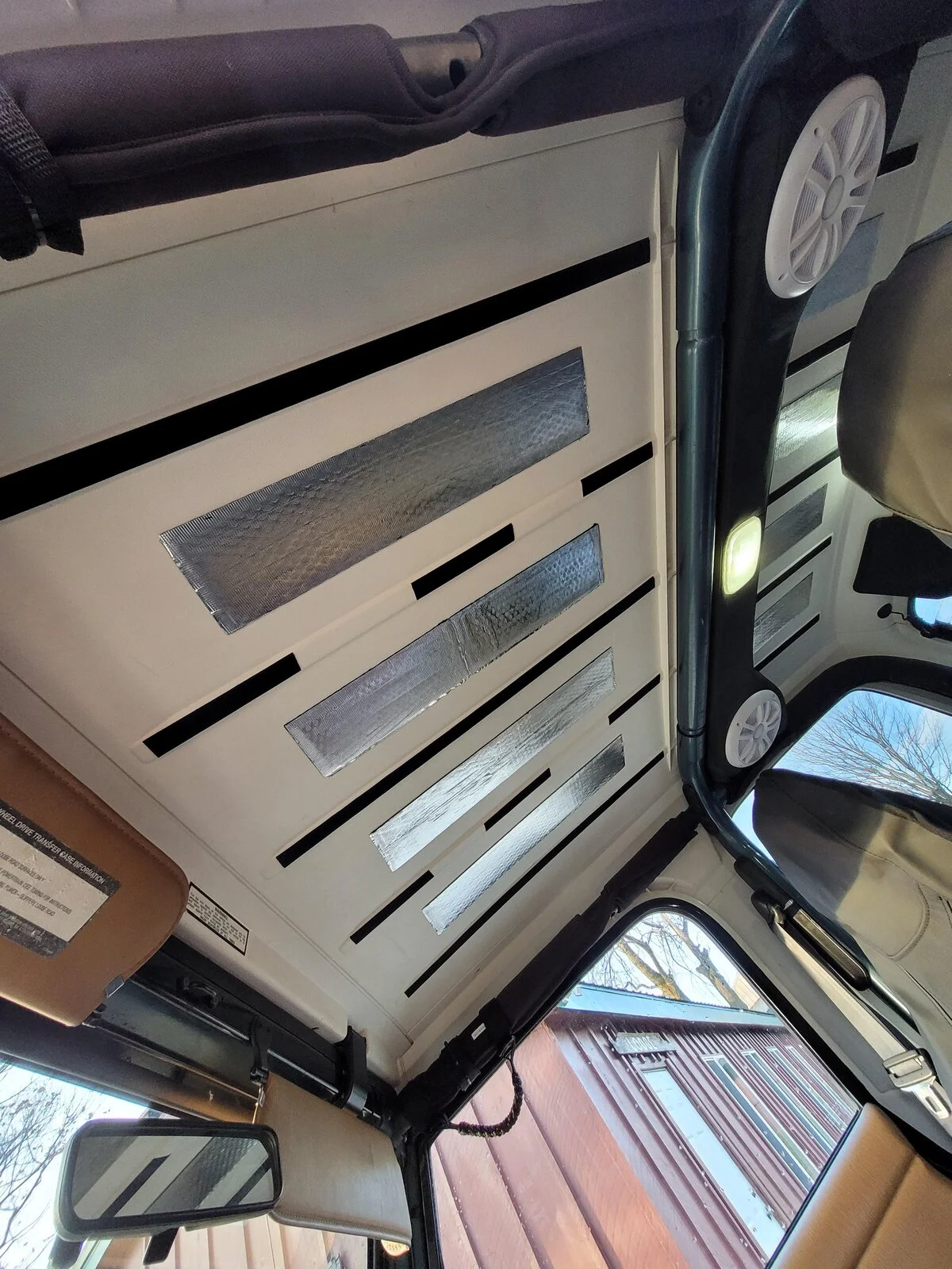

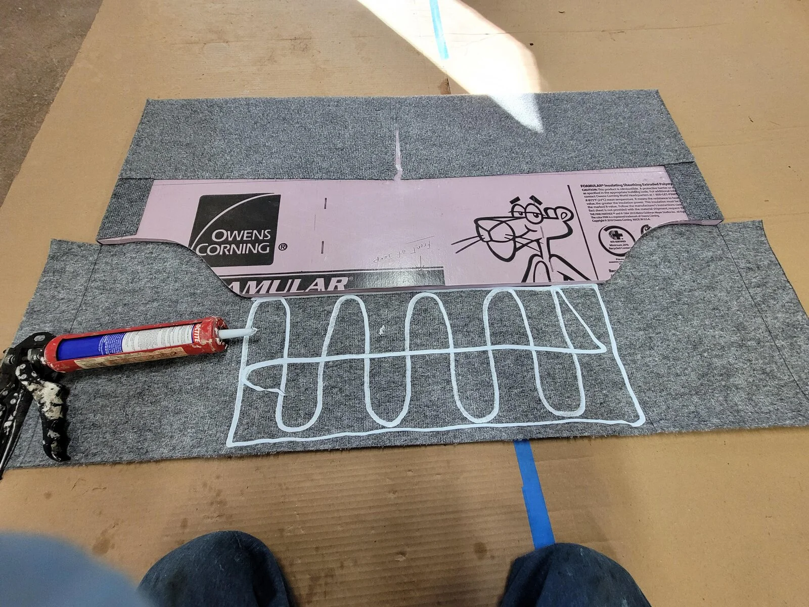

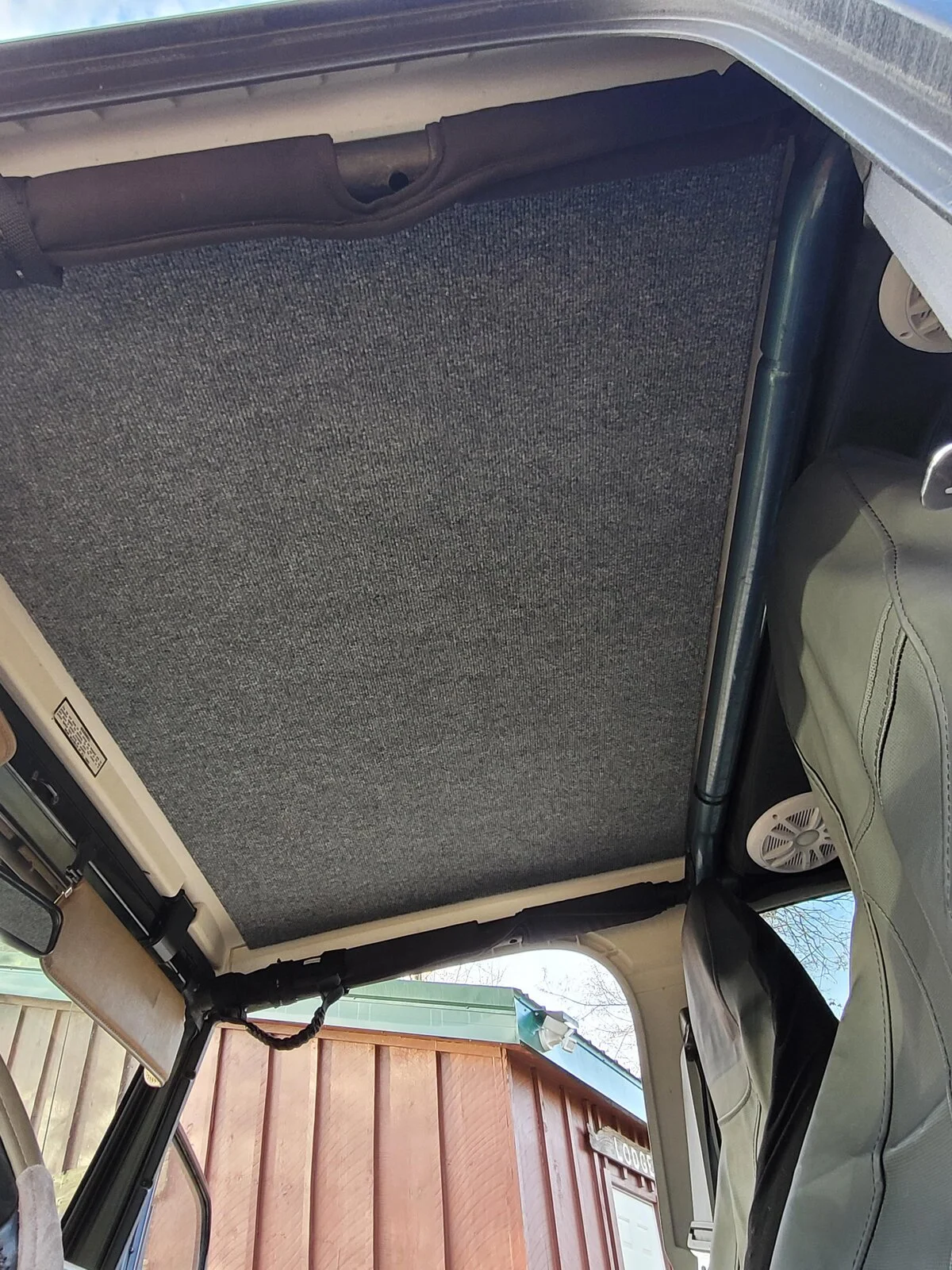

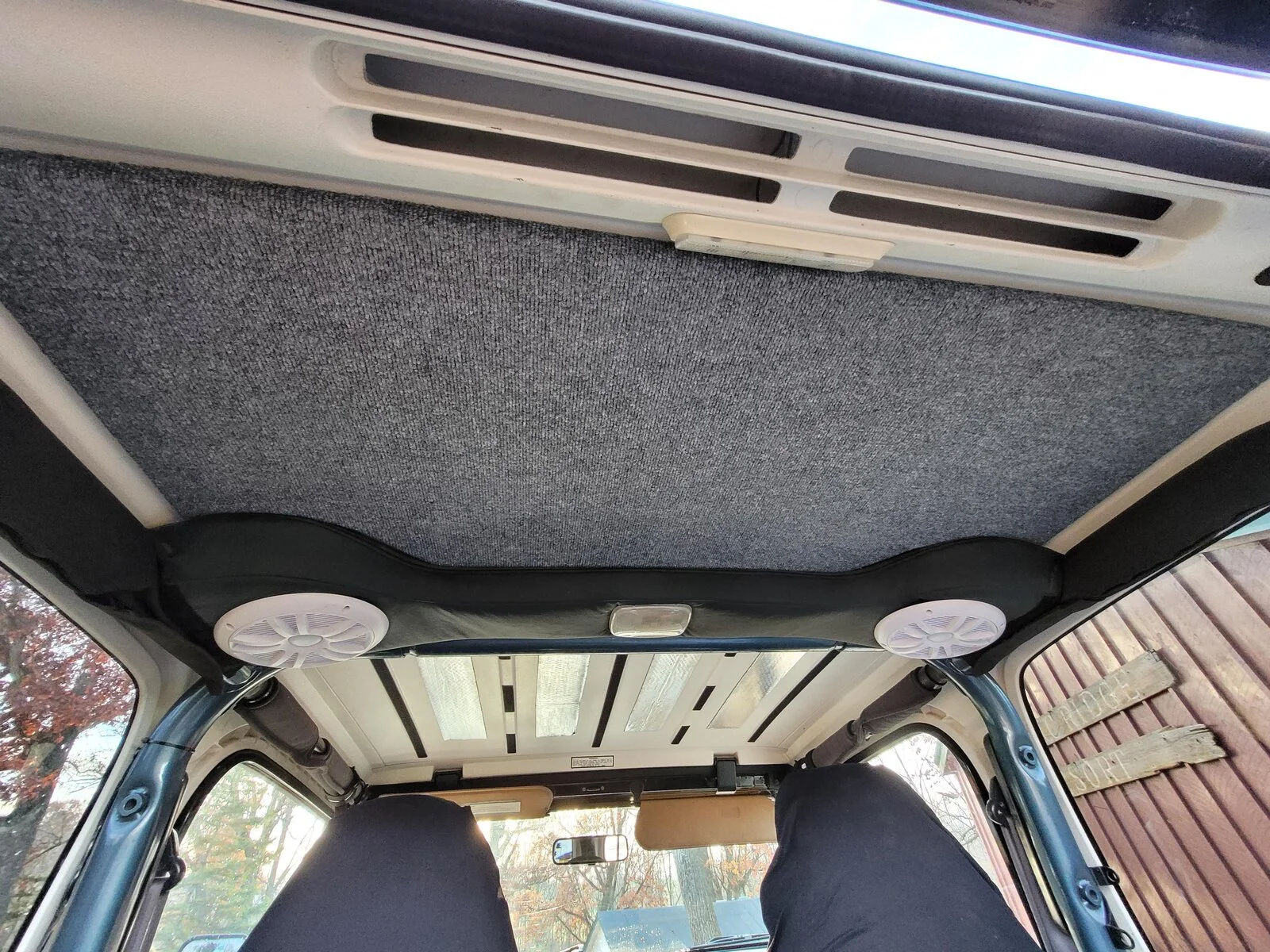

I went with the 1” thick foam Boom Mat. Installed it over the summer while the top was hanging from my garage ceiling.
I painted the interior of my top about 2 weeks before installing the mat, so I used an aggressive spray adhesive to insure it would stay in place.
100% warmer and quieter in conjunction with the floor insulation/heat shield I also added.View attachment 298804
