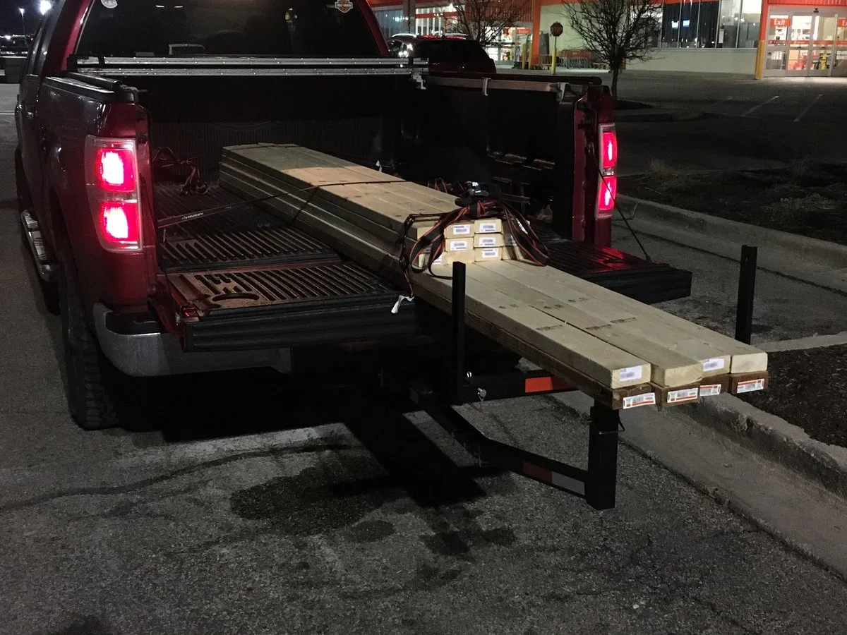

I have an F150 with a 6 1/2’ bed, roughly 8’ with the door down.
Is there a way for me to safely haul 16’ 2x4 lumber?
How many 16’ 2x4s?
Regardless of the answer keep this in mind.
They have to stand 4" tall not 4" wide.
You will need some weight on them near the cab to make that end heavier than what is sticking out.
A red flag much be attached to the end.
Check your state law to see if they have a maximum length anything can hang out the back.

I used one of these racks for hauling 14’ pieces for a deer stand in my 5.5’ bed. Worked great on a three hour drive.
https://www.farmandfleet.com/products/589835-lund-trailer-hitch-rack-truck-bed-extender.html

I didn’t end up going with 16’ boards: the 16’ PT lumber at the store was so warped and twisted that I could’ve used it to uncork a wine bottle. I ended up bringing home 12’ boards instead.
The bed extender served its purpose and I’m definitely happy with the investment!
