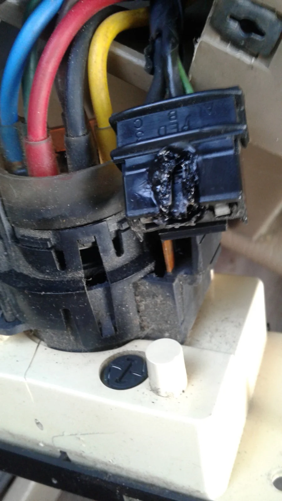

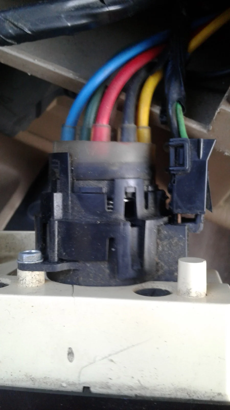

Apparently it's a fairly common problem. Fan starts to go bad and pulls too much juice. Mopar even makes a replacement plug kit.
http://rover.ebay.com/rover/1/711-5...0001&campid=5337789113&icep_item=321912569696
If I hadn't already replaced the blower, I'd have to do it anyway.
From JP magazine 4x4 network, 4th one down the list:
http://www.fourwheeler.com/how-to/electrical/154-1004-top-ten-jeep-electrical-problems-and-cures/
