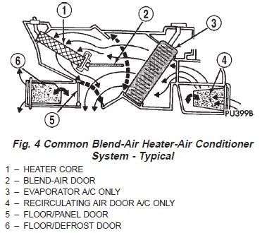

The fan motor is shut off when the main HVAC control is turned off. The heater core is always receiving engine temperature coolant so the heater core is always hot while driving. The amount of heat that is allowed into the passenger compartment is regulated by the blend-air door inside the HVAC enclosure. The blend-air door is controlled electrically by its small motor. It could be that the blend-air door assembly/motor is bad so it's not able to close off the heat from the passenger compartment.
