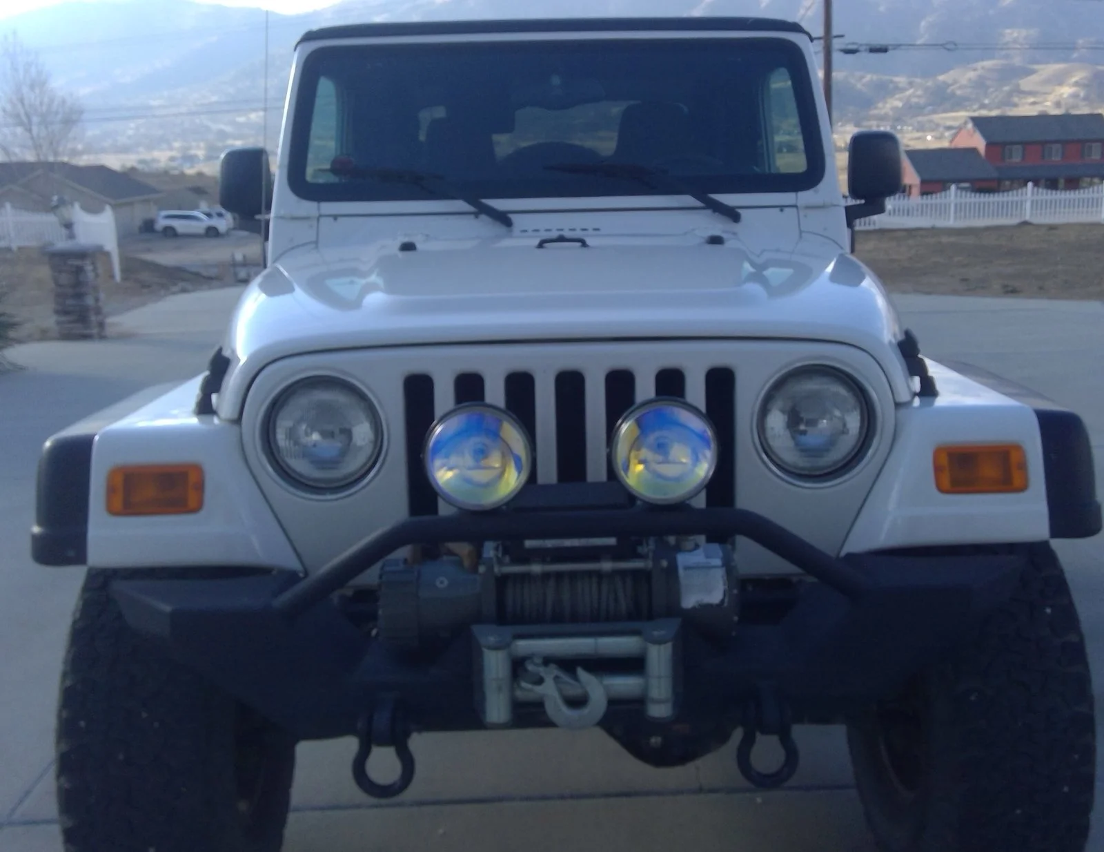

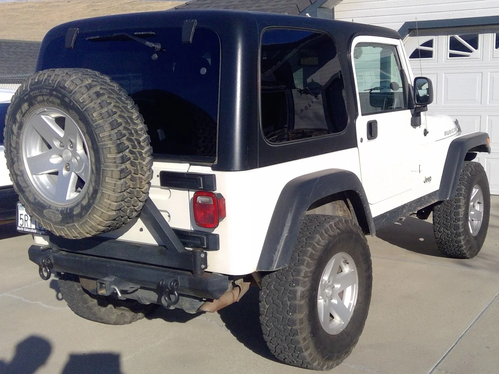

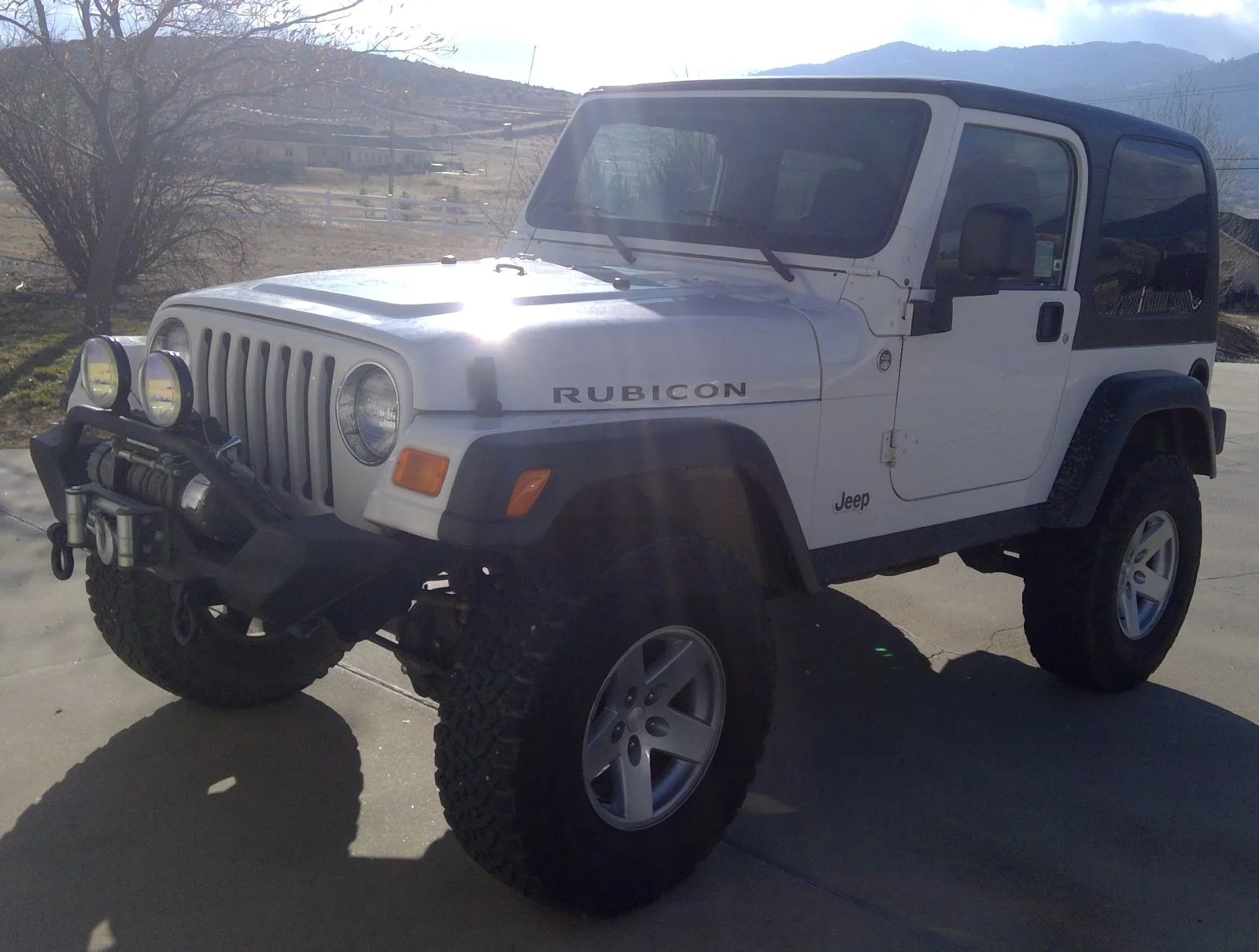

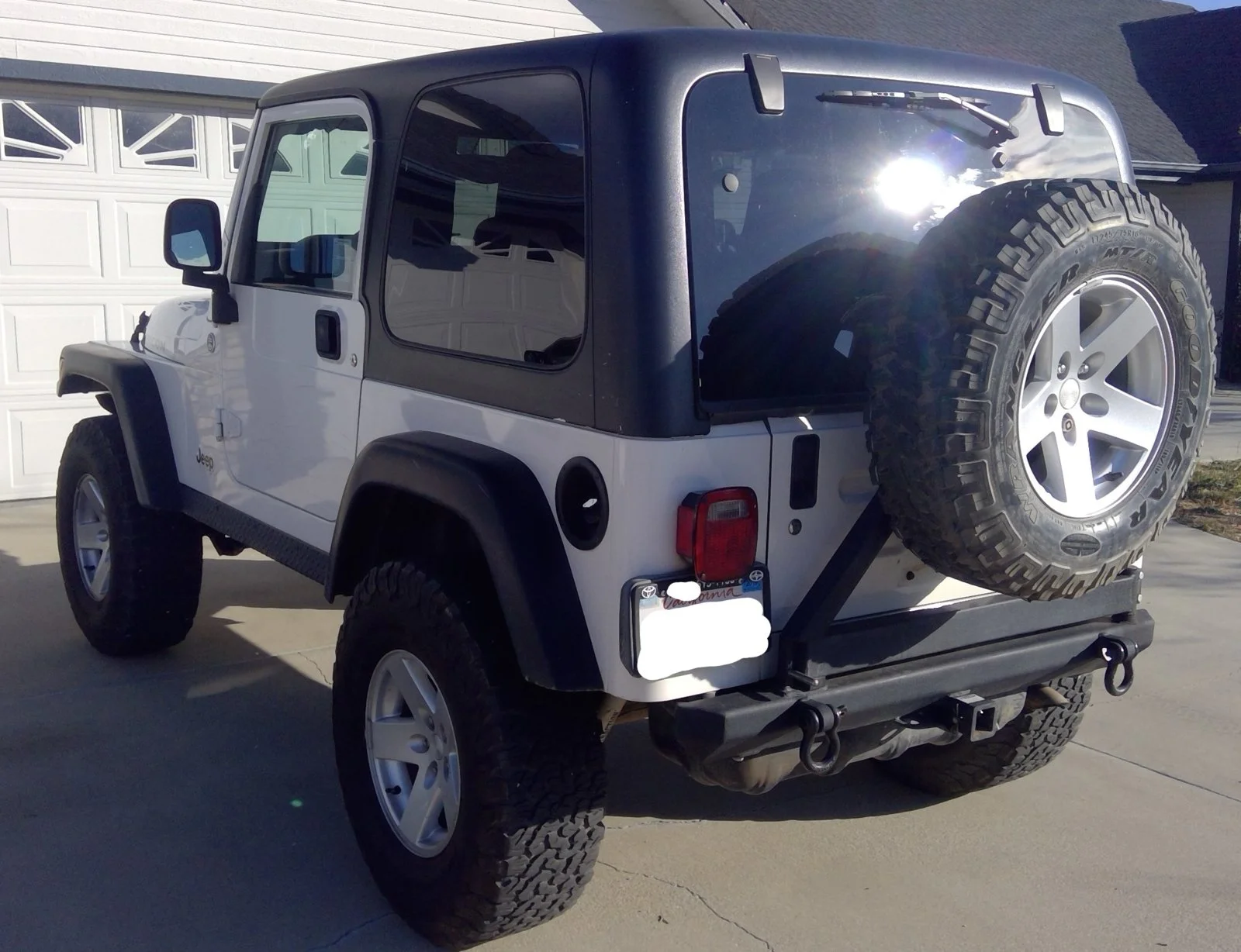

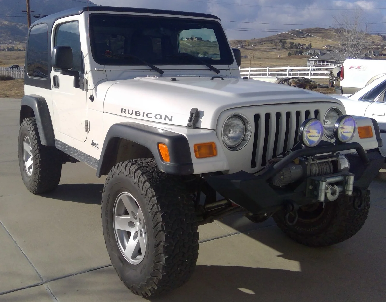

It has just over 74K miles, with a few upgrades as seen in the photos. It is the 4.0 with 6 speed manual.

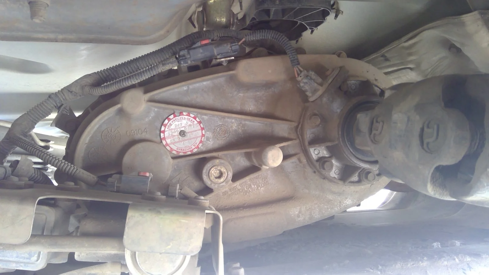

1st is the 4 wheel drive light is on. The PO stated he went through a washed out rode filled with mud and debris in 4 wheel drive and when he went to place it back in 2wd the light remained on. That was over 2 years ago. He was only using the Jeep for hunting and fishing trips and did not put a lot of miles on it. He assumed it was mud in the sensor switch. I ordered a new Transfer Case switch and am hoping it is the issue. Any Insight otherwise ??
2nd issue is there is a slight whine that is RPM driven. It is not from the motor, but noticed when the wheels are turning. ( It has the sound of a speedometer cable that is worn in an older car, or a Ground that you can hear in your radio that goes up and down with the RPM of the vehicle. )
The sound is noticeable by both myself and my daughter, and it appears it is coming from up front. I thought it was on the Pass side, and my daughter thought drivers side.
I am wondering if its the drive shaft ? Wheel Bearings ? U Joints ?? WORST fear … Transmission ???

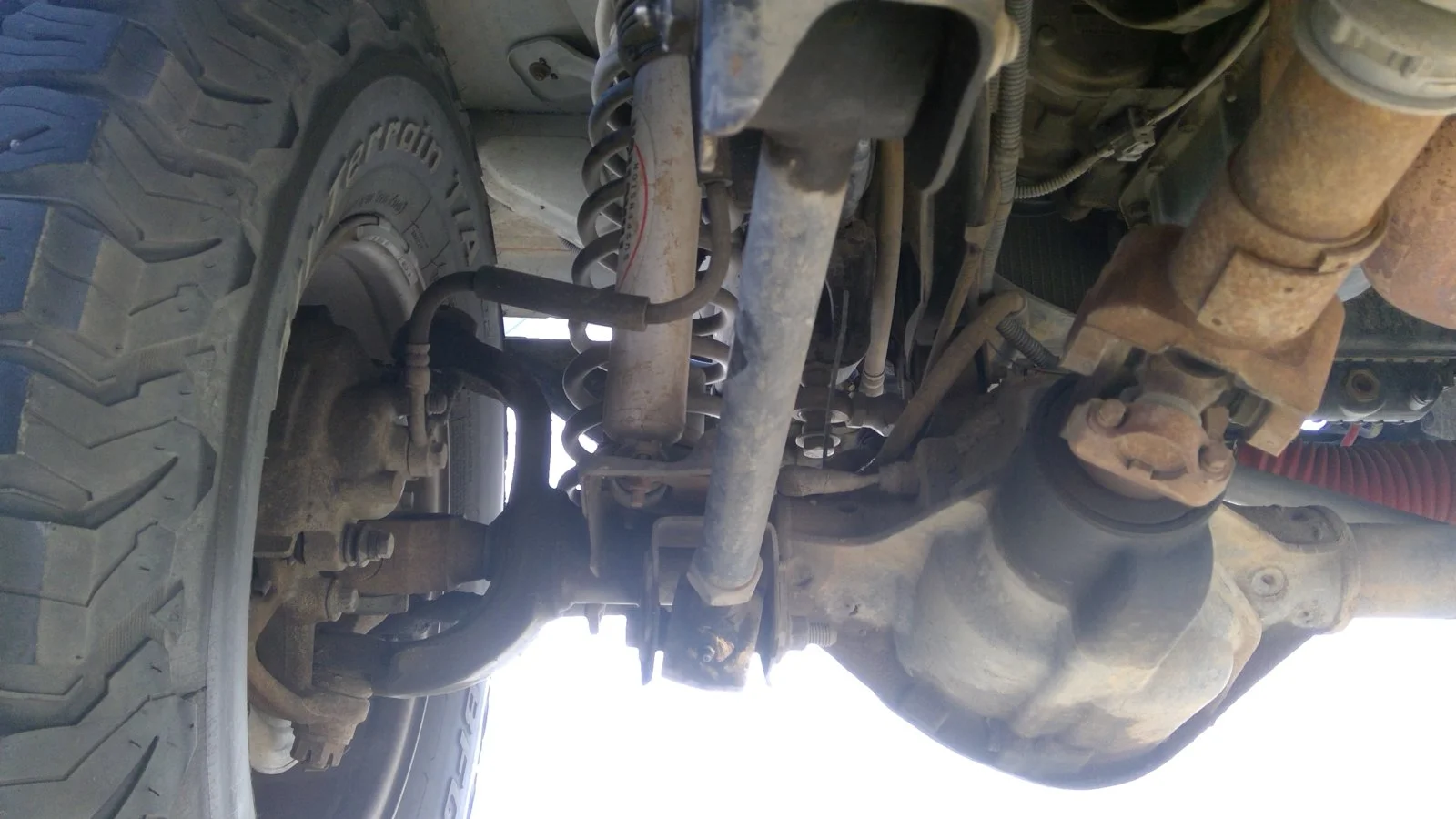

There is also a harmonic DRONE and very slight vibration from the rear when the Jeep is on the Freeway. I am thinking it could be the U joints, tires, or drive shaft issue, but wanted to ask here if anyone had some insight. This is the least of my concern compared to the other 2 issues.

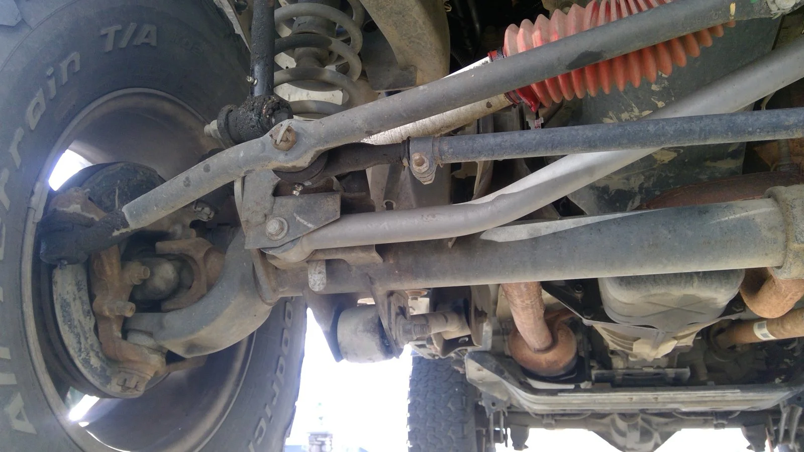

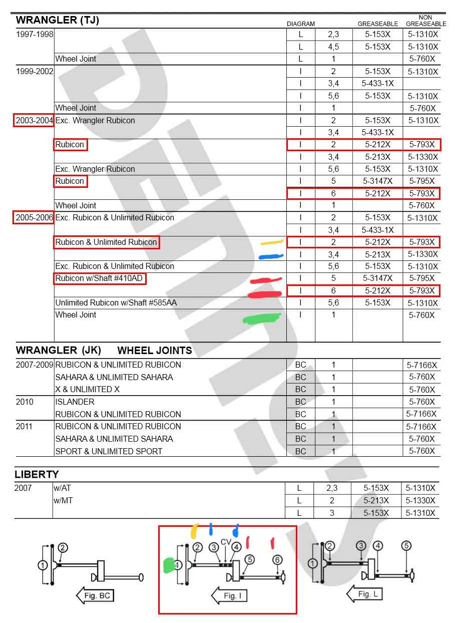

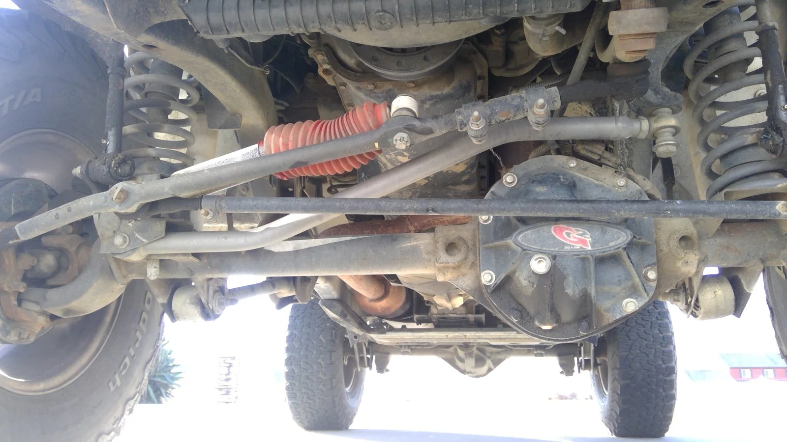

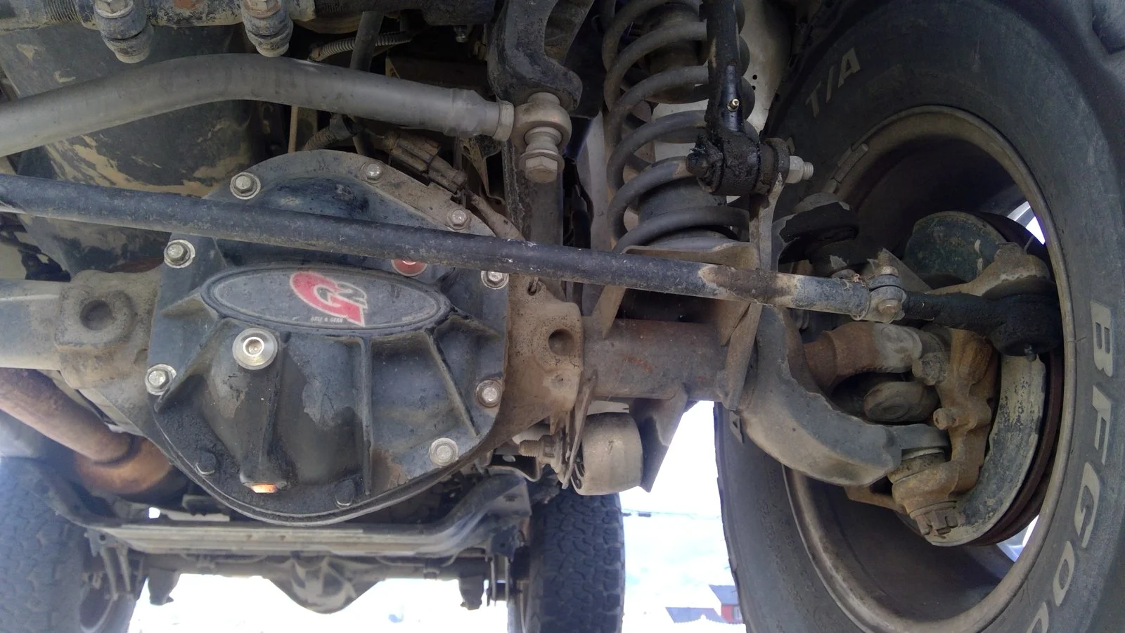

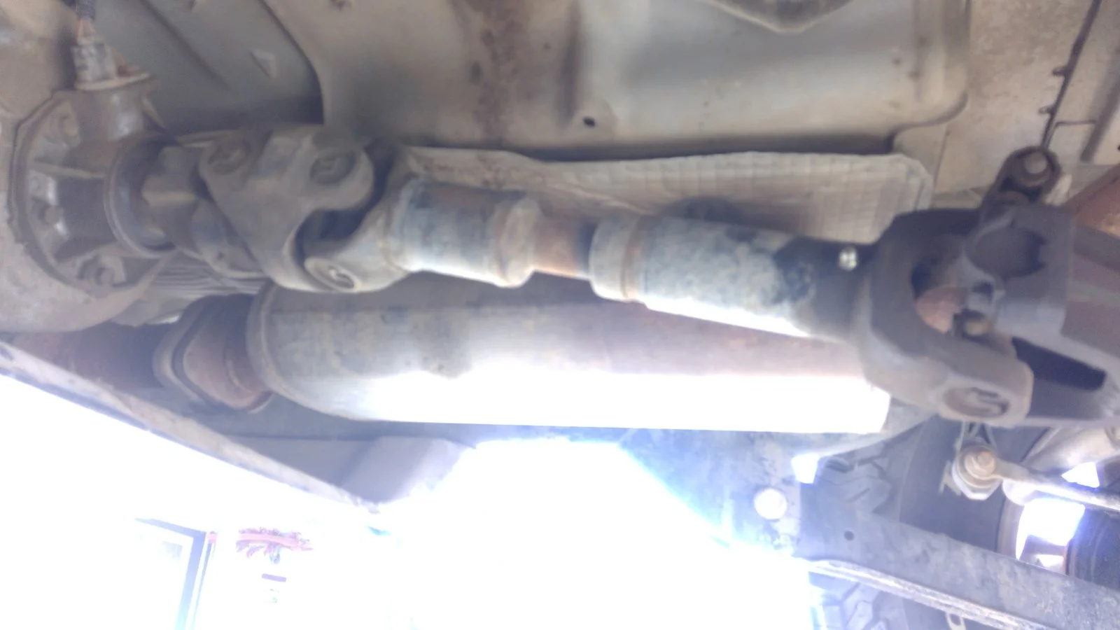

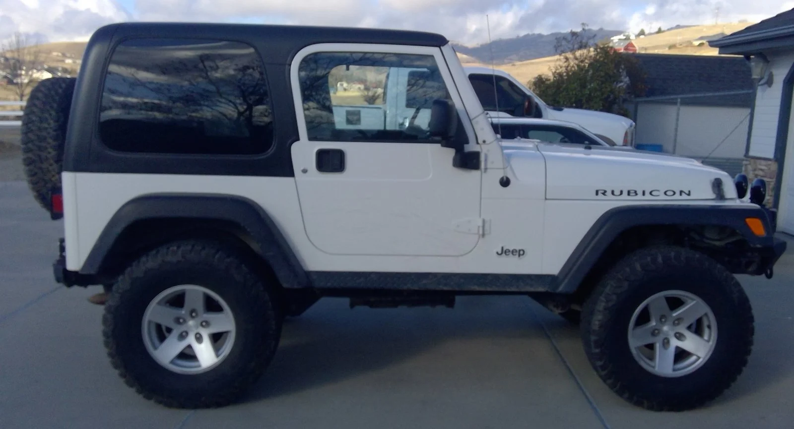

My plans are to change all the fluids. I read on this forum all the suggested brands and amounts, so My Amazon order is long and adding up. I wanted to order the U Joints also, but its confusing on the chart what I need. Plus, according to a buddy, it appears the suspension has been changed from stock which makes me more concerned on getting the correct parts.

Stock spring height is 12’ for the front and 8’ in the back so anything over is your lift.
On your ujoints it can get confusing having just replaced all mine.
You’d have to check what shafts came on yours for 5&6 in red. ( although I think I am correct with the red marks as you don’t have an Unlimited )
