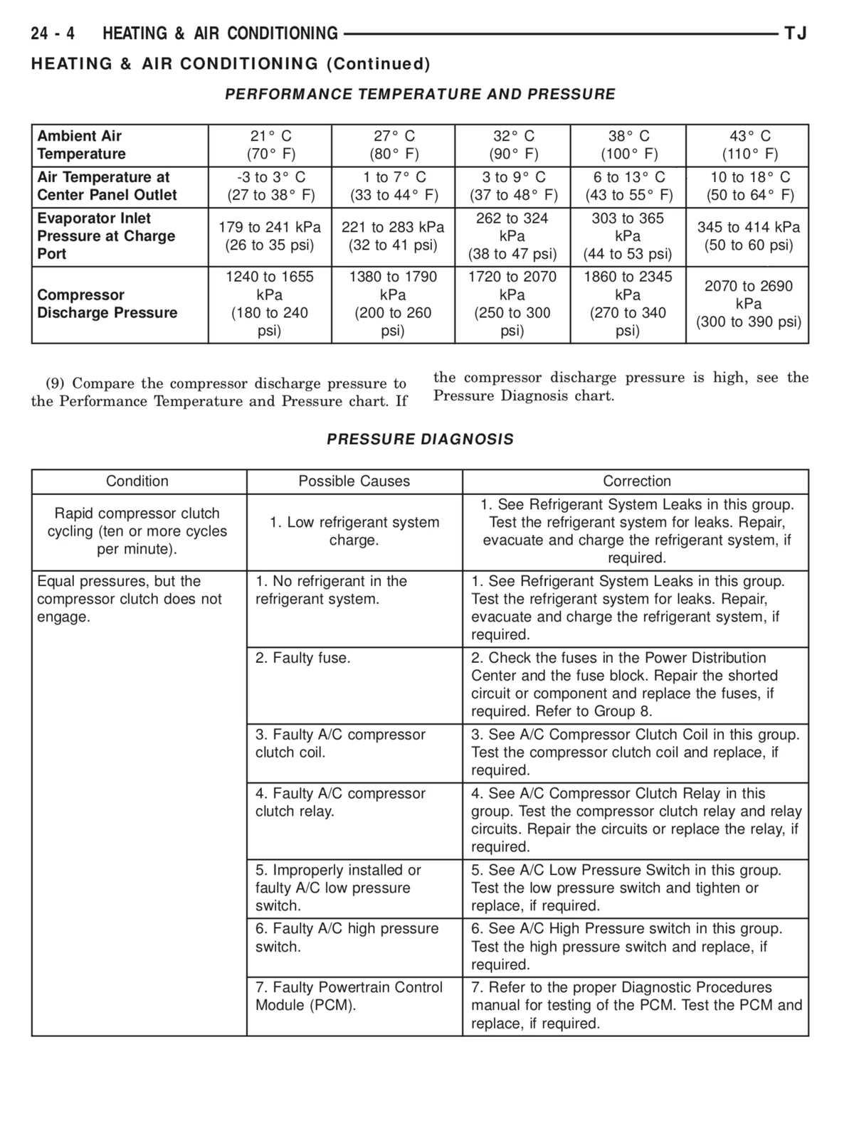

From the service manual it seems that at about 70F the pressure should be just below 40. This is why I'm hesitant to just add more freon. Is the low refrigerant situation kind of like the voltage reading on a bad battery, where the standing voltage may look OK plummets when any load is applied? Before going straight to a vacuum test, is adding freon a bad idea? I'm not sure why the reading is 70 when the A/C is off. Is that to be expected?

Thanks, that's what I've been itching to do but was confused by the low side dial bouncing between about 50 and 20 during compressor clicking on. The manual spec for 70F says it should be no higher than 35psi, but I guess it's confirmed that this is the expected reading while compressor is constant running, right?
Correct. That chart is used only when the compressor is engaged.

According to the Factory service manual (FSM) the low pressure switch opens at 25psi and closes at 40psi.
Also the FSM says you may need to jumper / bypass the low pressure switch when charging.
