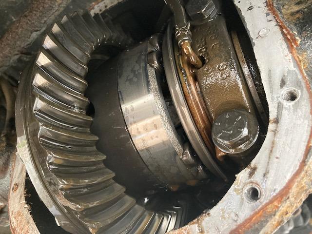

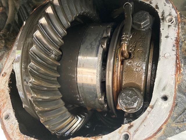

I was out wheeling yesterday and was going up a new to us trail and it got pretty tough so I was locked up front and rear with the stock Rubicon lockers when the rear dif light started to flash and there was a mechanical clicking noise was coming from the rear of the Jeep. The trail was still tough going so a little hard to be sure where exactly the noise was coming from. I tried unlocking both difs and after some maneuvering they unlocked. I got turned around and started heading out and needed the rear locker again so I engaged it and it went right in and made no abnormal noises. I went the rest of the day with no trouble but the Dif 1.jpgDif 2.jpg noise along with the flashing locker light convinced me there was a problem so I drained the fluid today and there was no metal on the drain plug and I pulled the cover and there was nothing obvious to me. Could this be a locker pump problem? Any ideas?

Thanks for the reply Jerry, the rear locker had been engaged for about 20 minuets and the front for about half that. I have read a lot about the Rubicon lockers and try and lock them sooner rather than later. I plan on moving my pumps up to the engine bay and will check all the wiring and air tubing at that time. I am glad that there is no obvious damage but it makes me wonder what went on.
