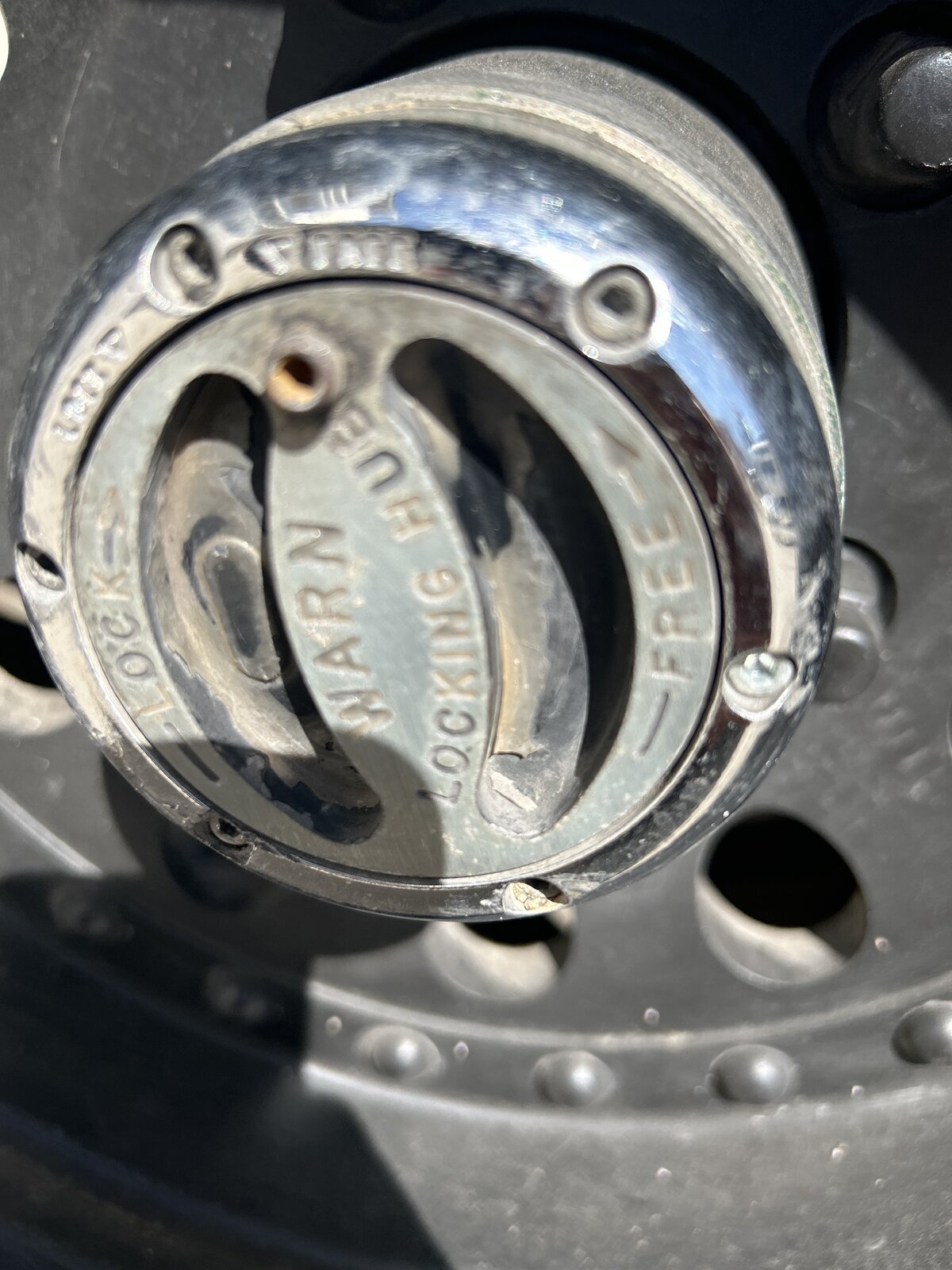

Help identifying axle for parts
Ok well that would lead me towards the front having a Ford or Dodge wheel hub and not a Warn. Can you get me some more pics inside the knuckle and the brakes? I found some stuff I will try to get it scanned and posted later today for the rear.
Well shit that is definitely TJ knuckles and brakes so that has to be a hub conversion. Weird though is that the Warn conversion basically used the same hub for the floater as well and those just do not look similar to each other.

Ok so here is the spindle chart for all the spindles Warn used.
  • WARNSPINDLES.pdf
Reactions: Wildman
Here are the instructions for a Scout 44 floater. Good news is that the majority of floater kits use the same bearings and seals:
Outer bearing set A35 lm501310/lm501349
Inner bearing set A47 lm102910/lm102949
Seal CR22353 and try to stick with CR if you can.
These are the same bearings and seal the Warn 5.5 front hub conversion uses as well.
The common Dana 44 wheel hub used:
Inner bearing set A37 lm603011/lm603049
Seal National 4250
Hopefully this gets you in the ballpark of what you have in there.

Thanks for your help! I’ll let you know how it goes once I get into it!
