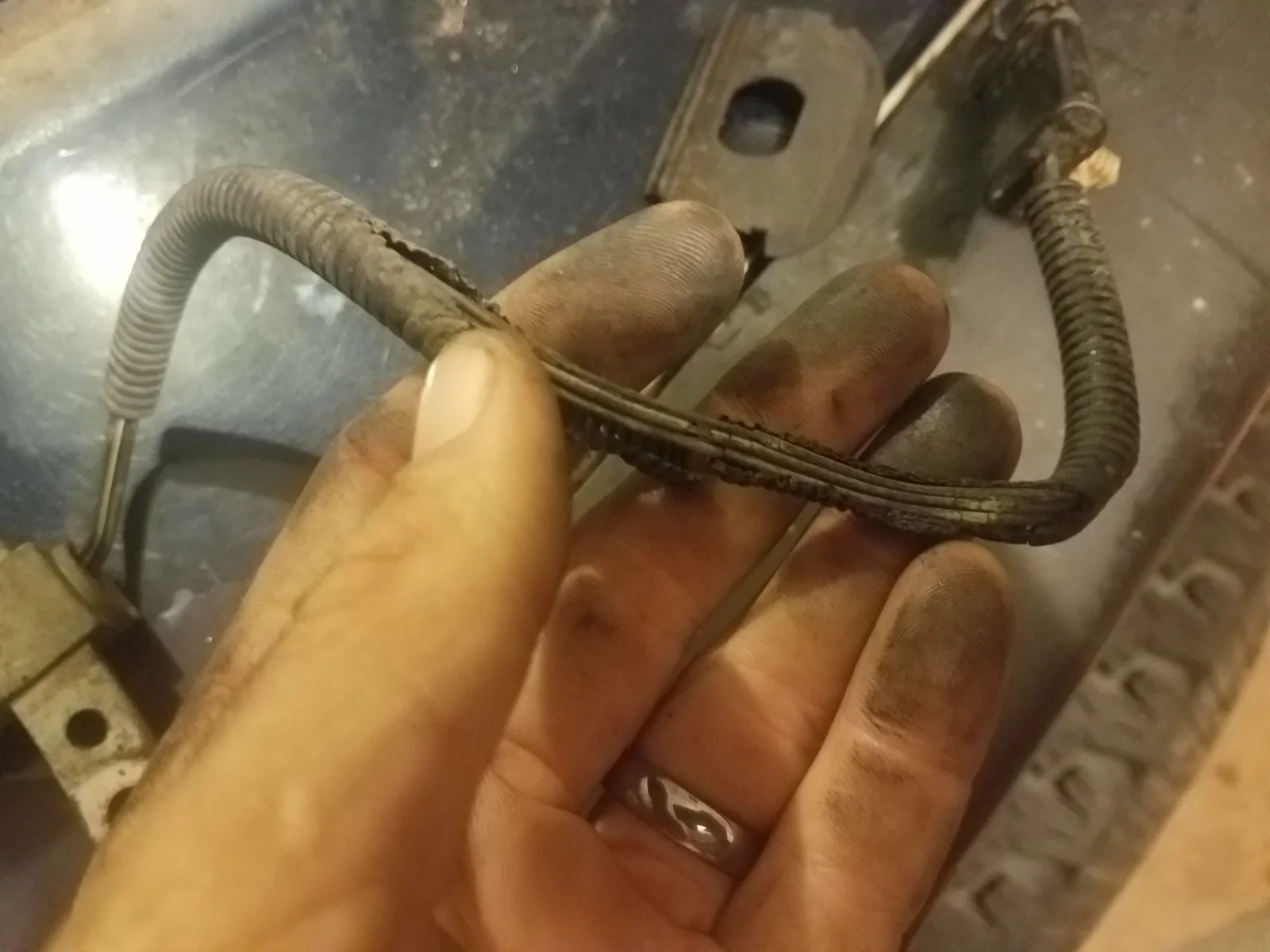

    So I think I found the culprit! Took the cps off and the wires are cracked and melted. Looks like they were hitting the header. Getting a new one in the morning hopefully to solve the problem! 20180613_220210.jpg

    So I put a new crankshaft position sensor in and the jeep runs and drives good so far. Thanks for the advice and help! Hope this thread helps someone else.

    If i understand correctly, the engine would run fine in open loop (cold) mode,
    But when the engine reached normal operating temp, it enters closed loop mode, where it then starts gathering input from sensors , so when it checked the bad cps, at warm up, it shut down
