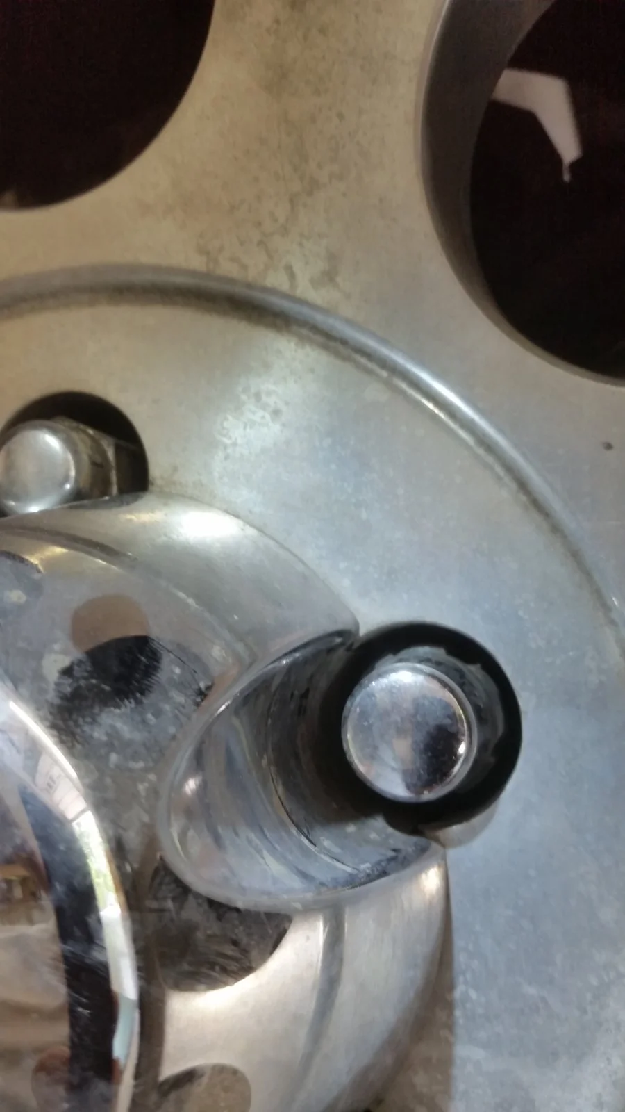

I was gonna replace brake lines today but there's this dumbass nut on my wheel. Is this some kind of anti theft ?
What special tool would i need ?
Naturally it'd be easier job with wheel off. Lol

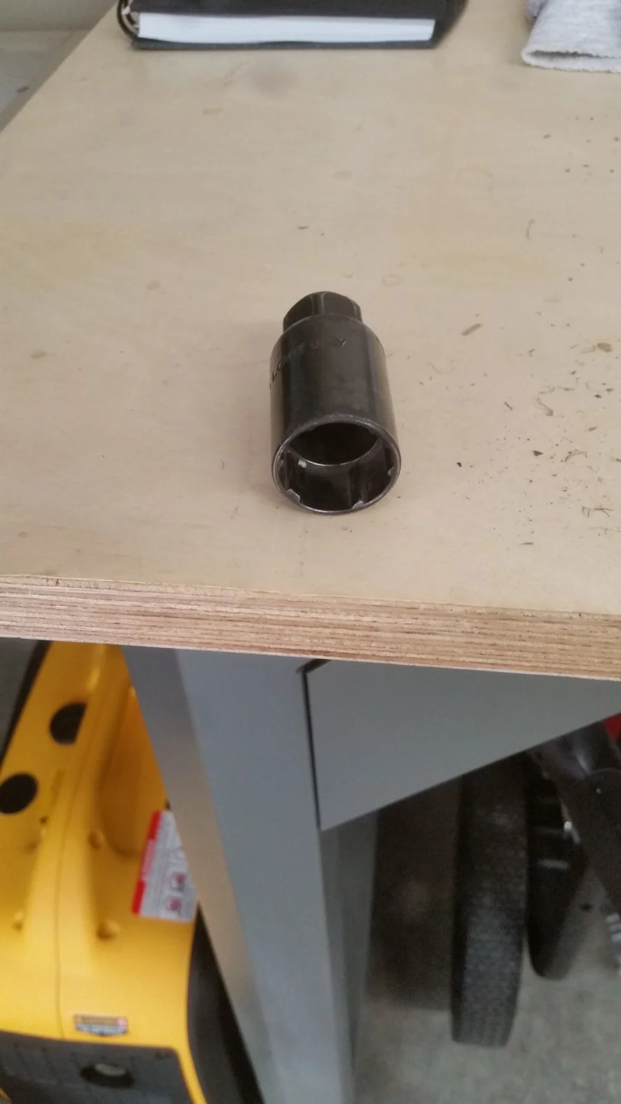

That lugnut takes a special socket. You could try to hammer a deep socket that fits tight. It might catch enough of the nut to get it off.
Nevermind. Good you found the key.
I went ahead and replaced the hoses and calipers, was easier with the wheels off.
My first wrangler, didn't realize Jeep did this but i know now :)
Get rid of the locking lug nuts. They don't work anyways. I know cause my spare had one and I was able to break it by using a tight fitting socket. I hammered it on and snapped the lock with minimal force. I then used a press to get the lug nut out of the socket. All told it took me less than 10 minutes.
