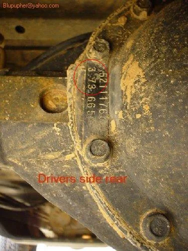

Following on from this, how can I find out what the gearing ratio of my TJ is? I don’t have a full service history and it’s had multiple owners. From what I know, the original owner had it lifted then the guy I bought it from dropped it back down to stock but he doesn’t know anything about the hearing either. It’s currently running 245 KO2s.
FWIW I’m putting new springs with a 1.5” soon.

It may not still be there but the factory installed a ratio tag at the 9 o'clock position of both differential covers.
This tag is indicating the axle has 3.73 gears inside.
