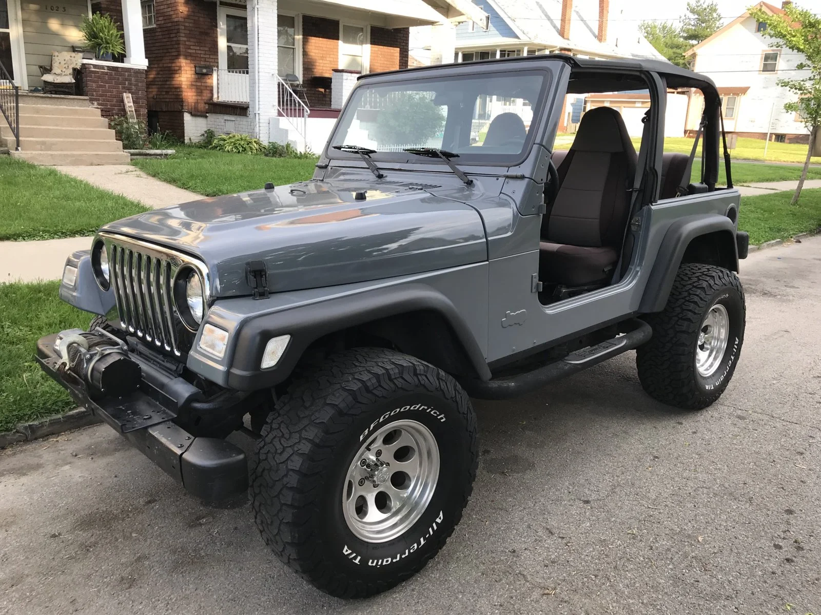

Okay all, so a new update here. 7 months later and still dealing with the issue. I am now onto the 4th ECM, every time has been a separate set of issues. This most recent ECM is the most promising being that......

Dude this thread sucks! I feel for you, even though it's a toy and not a daily driver it's basically an anchor. Your paint and rims look cherry, you need to get this thing sorted and on the road (or dirt)!
