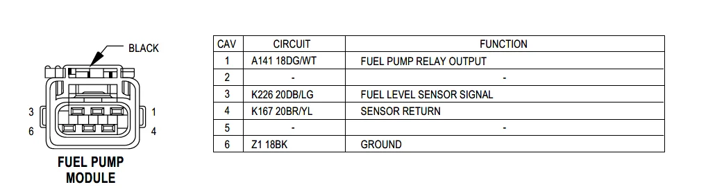

Here's a snippet of your FSM and the colors going to the pump - maybe you got the power & ground backwards on your new harness?
This is the information that I have in my Haynes manual and what I have found online. The harness on my TJ has the following 4 cable colors; GN/WH, BU, GY/YE, BK.
Hmm, if your TJ doesn't line up with the diagrams in the FMS then I'd suggest checking for continuity to figure out what your hot wire is from the fuel pump relay, or you can also check for voltage when you first put the key in the 'run' position
