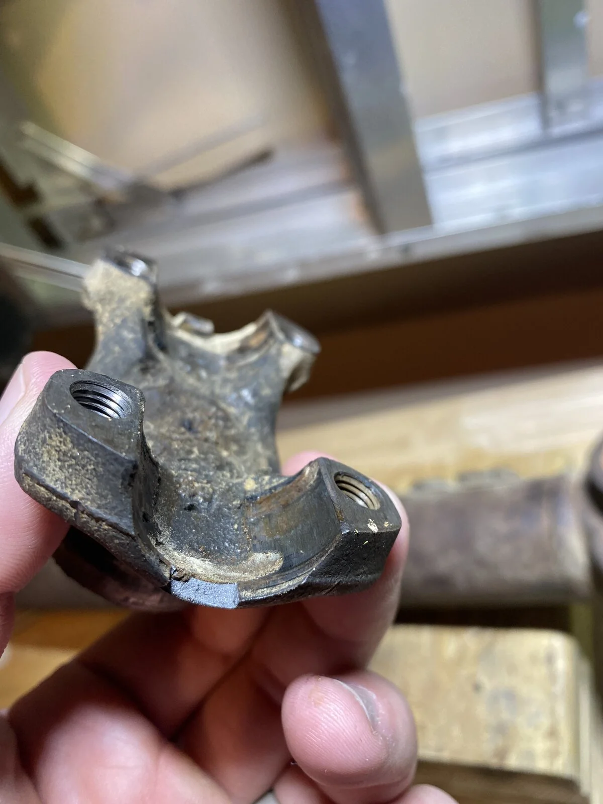

Photos of what you've got right now might help. I broke the little tab off the centering yoke the very first time I did one.

That’s exactly what I did. I had the H yoke sides in, and the one side on the centering yoke, and then I broke off the tab (💪🏻) trying to get the last side in.
New centering yoke is coming today.

ok, seat the caps in the centering yoke first, THEN hammer in the caps on the H-yoke sides.
