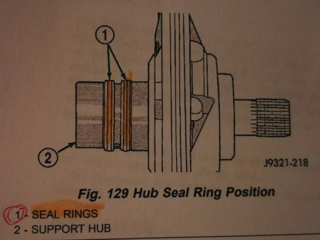

I had always (since I bought the vehicle) a very small oil leak (a few drops that fell from time to time) but nothing serious, I checked daily oil levels and I do not I have never found anything missing ... But the expert insisted to treat this defect and told me that it was an easy repair ...
To summarize, he told me that it comes from Seal rings, which he replaced.
By reinstalling the transmission (32rh), the problem was supposed to be closed, but to my surprise, the car was not moving forward or backing off either ...[emoji19]
