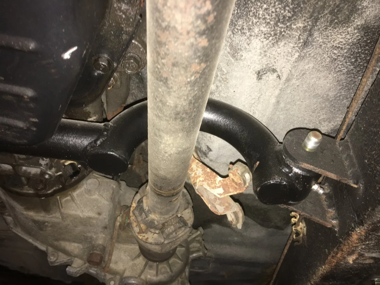

Now my first concern was the rear trans support. I have not seen anywhere this mount before. It has One mount on each side by the frame with one bolt through on each side. At the front drive shaft it has a loop that goes over top of the drive shaft. Has anyone ever seen this type of rear mount before and who makes it?

That style of rear mount is fine if the front are hard poly like the AA donut style engine mounts.

Only comment on the tranny mount is the lack of thought process to center the drive shaft in the hoop. That is only cosmetic but it is an indication of the thought process with everything else.

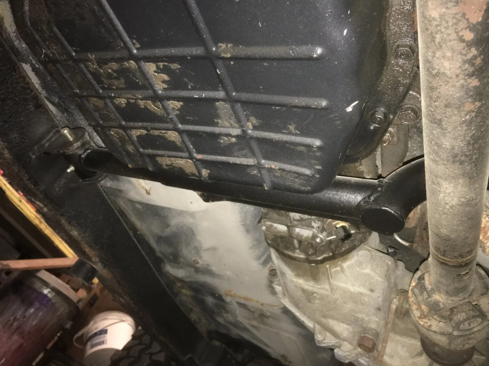

Is that a plastic oil pan on the tranny? If so, definitely keep it an inch above the skid.
I don't think you can raise the engine/ motor mounts any like you can with the 4.0. The stock intake manifold on 5.9 is tall already and you might run into clearance issues. Looking at your pictures I think the transfer case is fine but if you don't like the angle then install a transfer case drop.

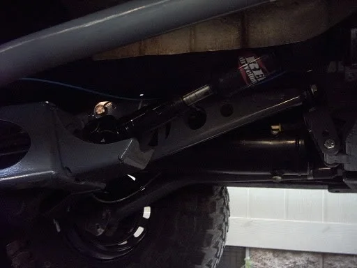

Not the best picture but here is my rear driveline and I have a V-8, auto tranny & STaK's transfer case. I also have a high pinion rear axle. But you can see my angle and it looks about like yours would be.
So something has to be done to the angles. I have the sye drive shaft for a lifted tj with 4.0l. I extended it as far as it would go and put in in place. The u joint yokes are binding.

I believe the transfer case rear mount is a custom built unit, not necessarily an off the shelf item. Hard to say.
