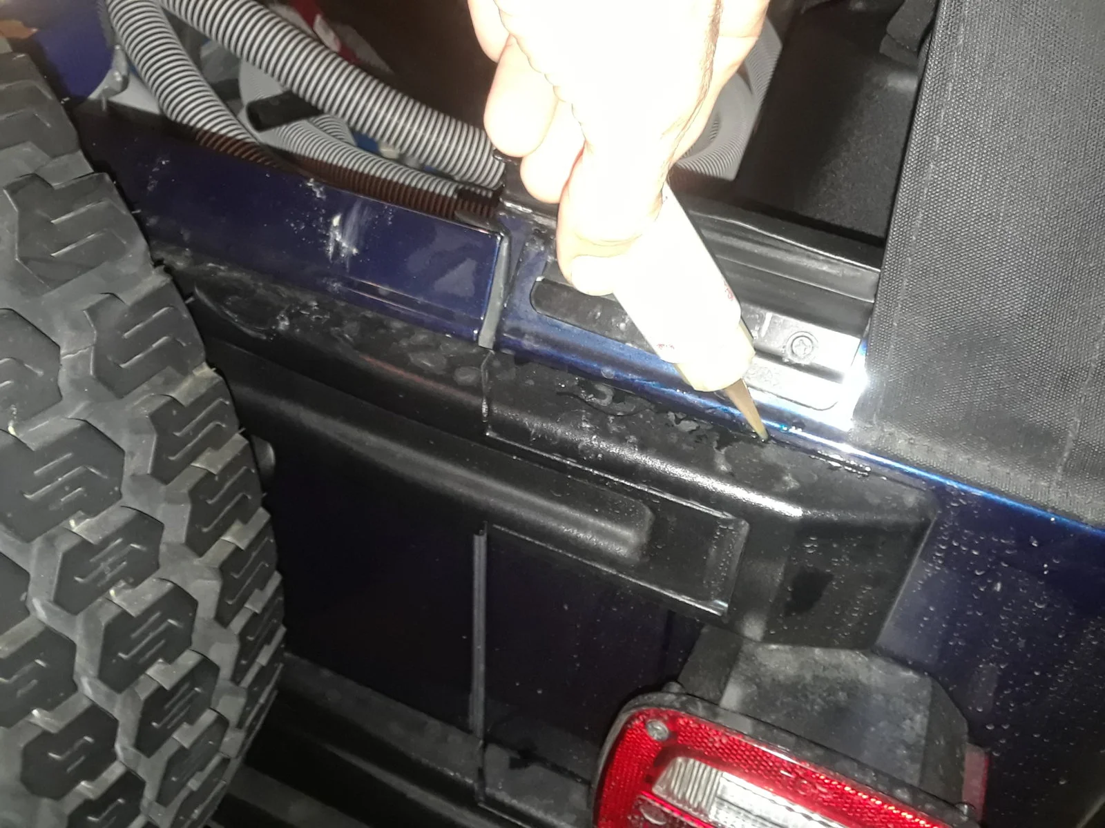

TIRE CARRIER IT WAS!!!
So the first thing I did: took the tire off and drove around. The squeaking practically stopped. I figured because of the weight of the tire, the rear gate, either around the lock or the hinges moved up and down, causing the door seal to squeak, and/or the tire itself squeaked against the rubber pads. Cleaned up the rubber pads, the tire carrier, the lock and greased everything with silicone, including the door seal. I did not put oil into the hinges (did not cross my mind :) ). To my great satisfaction. the sound was GONE!!! YESSSSS. Coupled with the new set of RS5000X Ranchos instead of the 4600 Bilsteins, the car became a very pleasant and an enjoyable ride.
