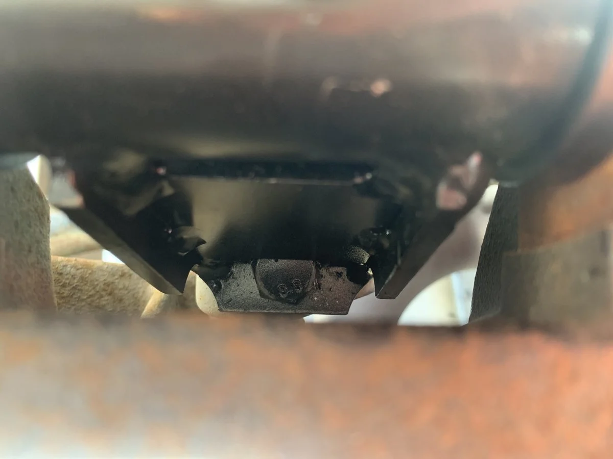

Just spoke with Steve from M.O.R.E. and he said he has not to date heard of this happening. He is going to send me a new set and he will tack weld the bolt in place. I took a picture of the passenger side. You can see that the paint has been scraped off the head of the bolt from it turning around. Great customer service!

Did the guy from MORE say it was supposed to be welded?
Is it possible, that the bolt spins because when it's loose it can lean back? Consequently, if it was tightened to the point that it couldn't lean away from that plate, then the plate would keep it from spinning for final tightening.
Mine were not welded in, as I remember being able to wiggle the bolt. However, it would only move slightly because it was limited by the plate that was notched out around it.
