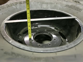

The backspacing dimension itself is not affected by the wheel width at all. The backspace dimension is only the distance between the inner-most edge of the wheel and the wheel's mounting surface. You ca have the same 4", for example, of backspacing regardless of if the wheel is 8", 10", or even 12" wide. This is an especially useful dimension, as opposed to the Offset dimension, since it tells you directly how far into the wheel well the wheel's inner edge protrudes... as in how close it is to the frame and suspension components.
The yellow tape measure below is measuring the wheel's backspacing.
