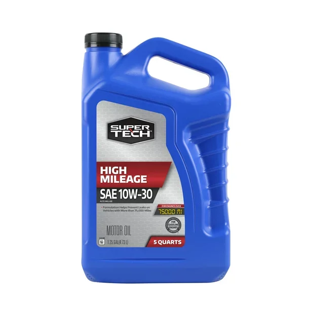

Personally I run a High Mileage conventional 10W-30. Never had an engine problem/failure in nearly 60 years of driving with conventional engine oils. The High Mileage version helps to keep the seals in good condition so they don't leak which is fairly common with some synthetic engine oils.
Walmart. 🤫
