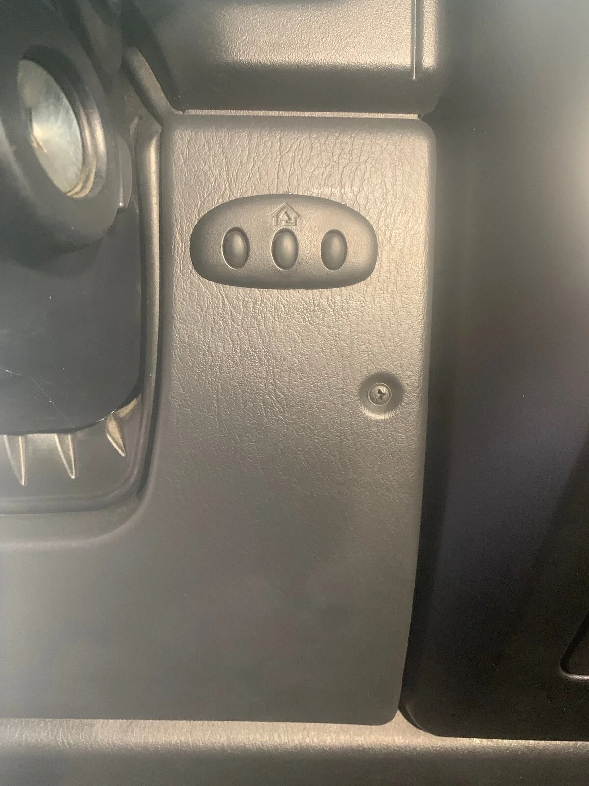

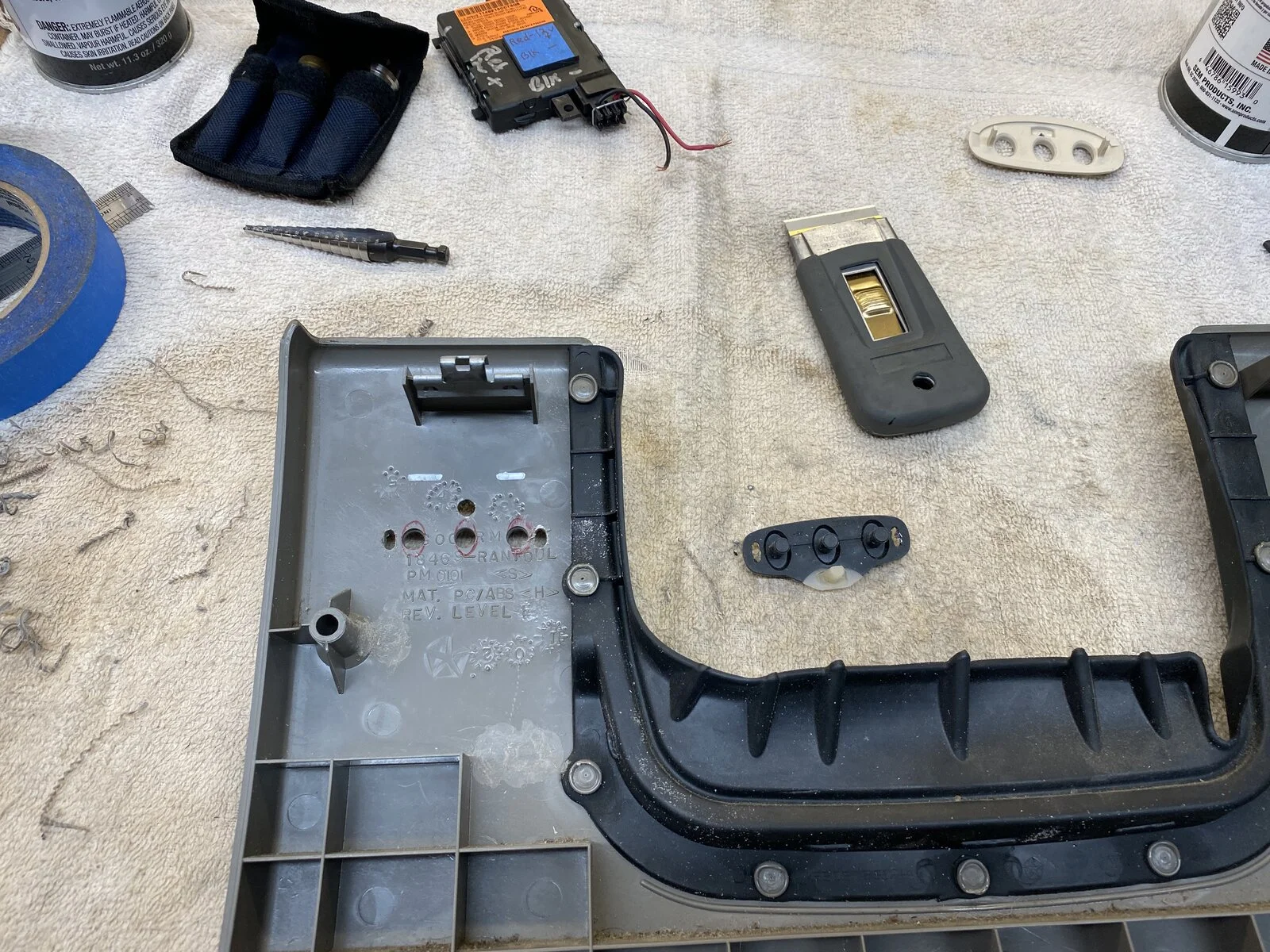

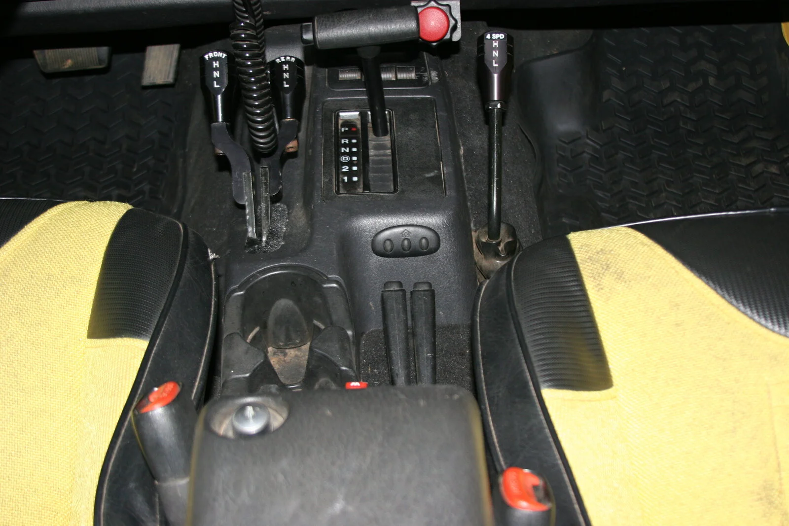

I installed it near my steering wheel and the color matched perfectly. I had to cut an oval hole in the trim piece but it turned out like this.
I used a fuse tap on the radio circuit so it can only be used with the key.
